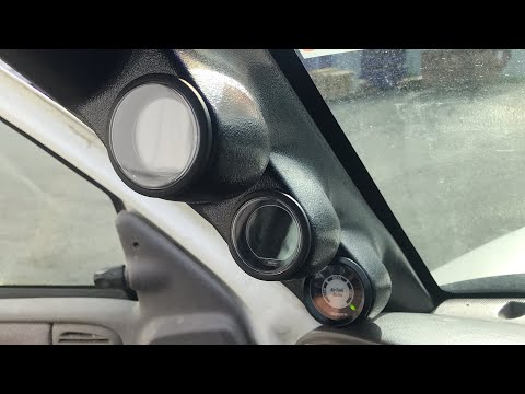

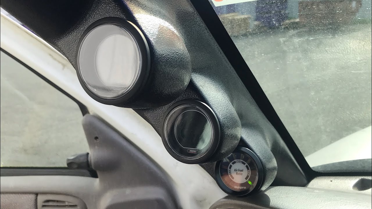

Thanks Marcus , your looking good .
Hello Marcus, does your headlight dimmer also dim the gauges or is the brightness preset with the manual adjustment on the back of the gauge? I have a set of similar Chinese gauges that are non dimmable. They look great in daylight but are way too bright at night.
