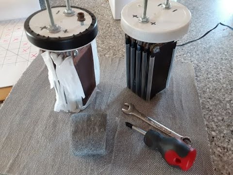

This guy is showing his own testing if DIY batteries. Most promising is copper positive and steel negative. He wrapped the steel plates with steel wool in a potash electrolyte and it really helped. The first test is that cell, others are the second style he built.
His next test is going to be copper and steel BBs suspended in plastic baskets. That will be very interesting to see.
