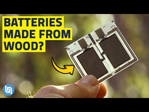

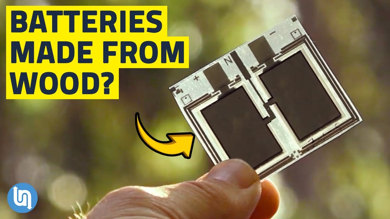

Here are a couple of wood based techs. One is finnish, one is swedish, and one is swiss. They are replacing the graphite in the anode with carbon made from tree lignin.
The swiss one is the most interesting to me because they printed the cell on paper which means it could be pretty cheap to produce at home. but it might not last very long either.
