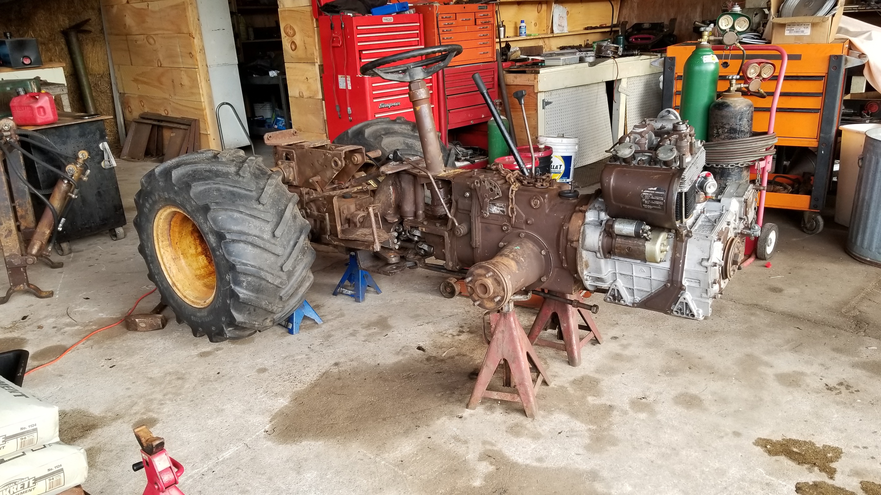

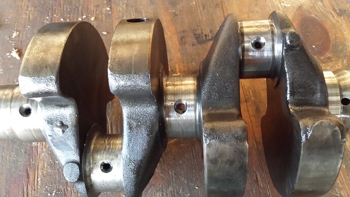

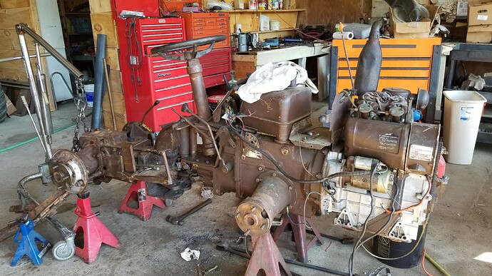

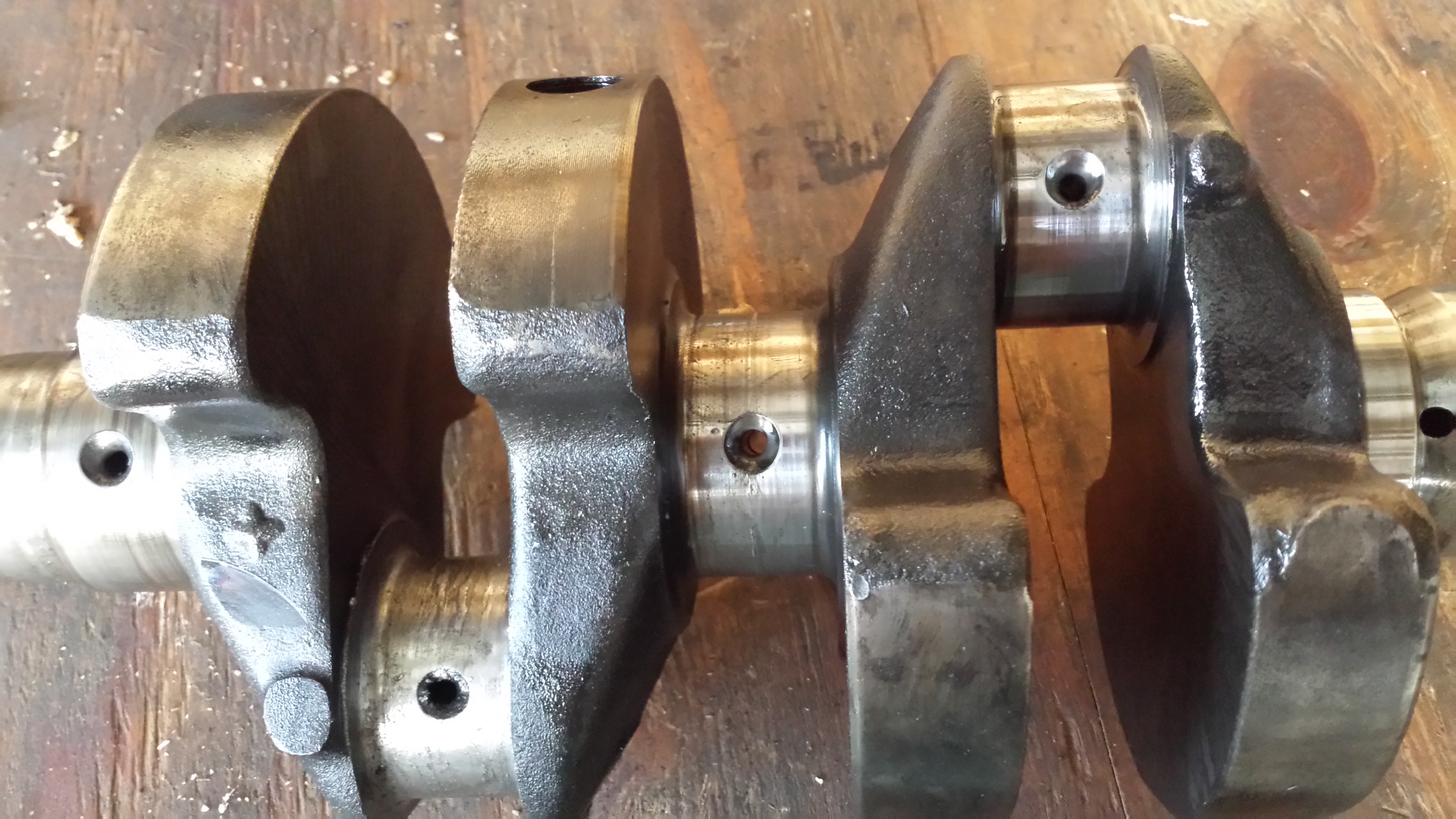

But back to the tractor the he got the motor apart yesterday the upper end doesn’t look too bad about like you would expect from a motor burning oil. I need to get a spring compressor so I can pull valves but it that part doesn’t look bad the cylinders look good no damage there. Now for the bad part. The crank has issues. One of the bearings was totally gone just flakes. I don’t know right now if the crank can be turned down and saved or not. Won’t know till after I can call Monday and find out what oversized bearing are available for it.

DanA, almost anything can be done to save a rare-one.
Crankshaft build up then machining back to standard dimentions.
tree-farmer Steve unruh
Steve thanks. I ran into that issue last year with my allis chalmers d17. The last guy up in this area I know of who would build up a crank retired about 5 years ago. I am sure if it comes to that I could ship it somewhere but I know they are still in production or I think they are. So hopefully I don’t need to do that. I still have hope that mine can be turned down enough to clean it up.

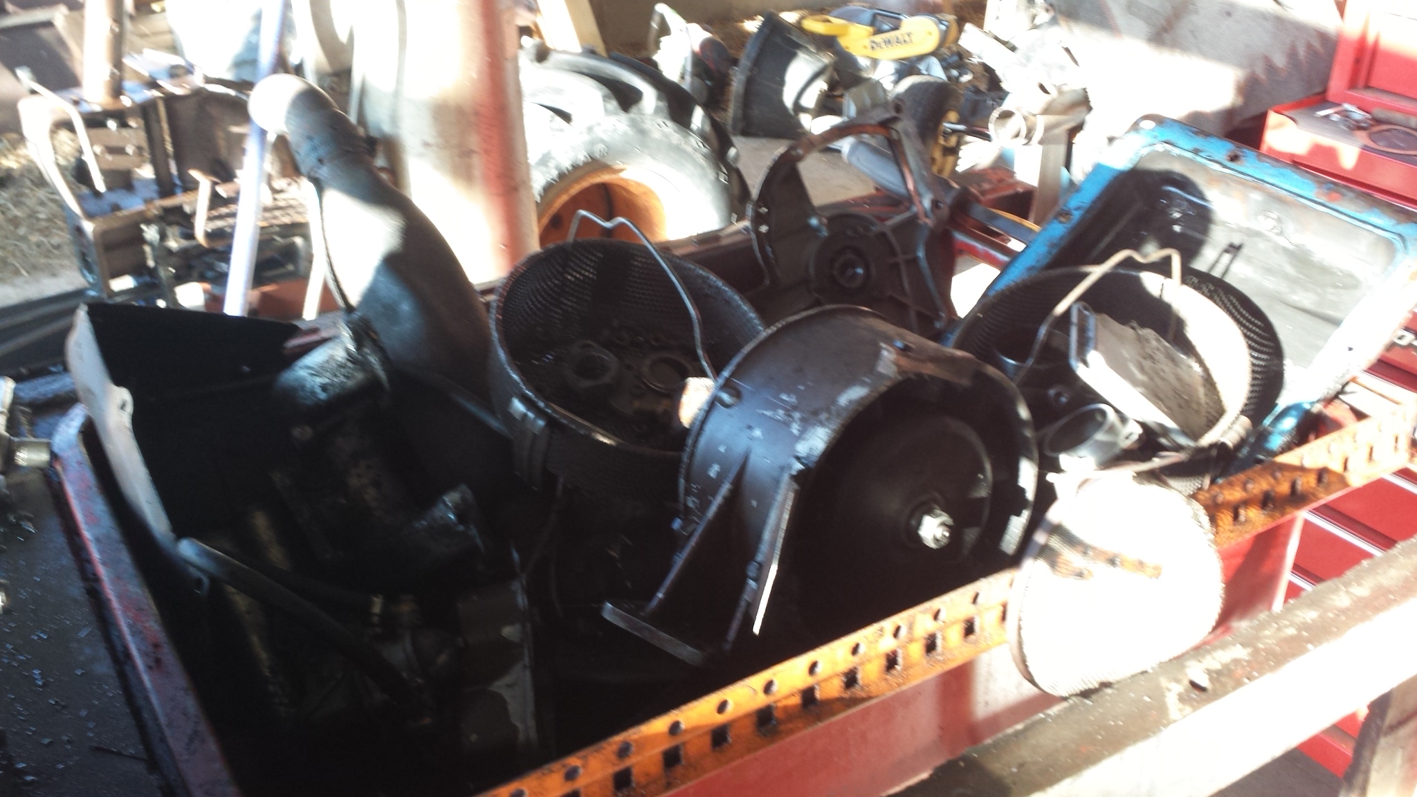

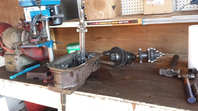

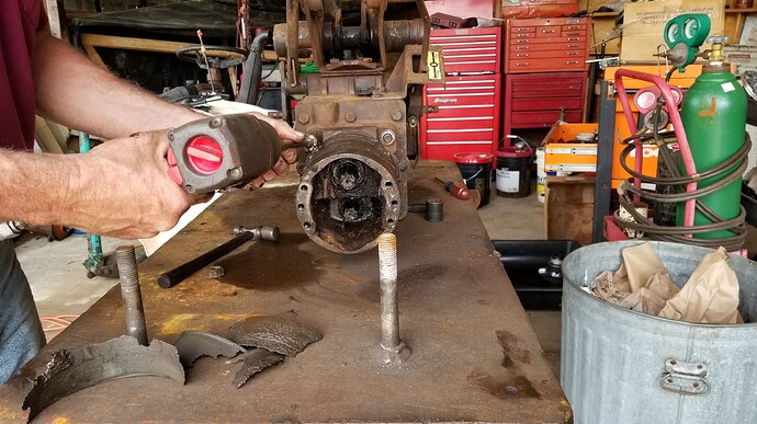

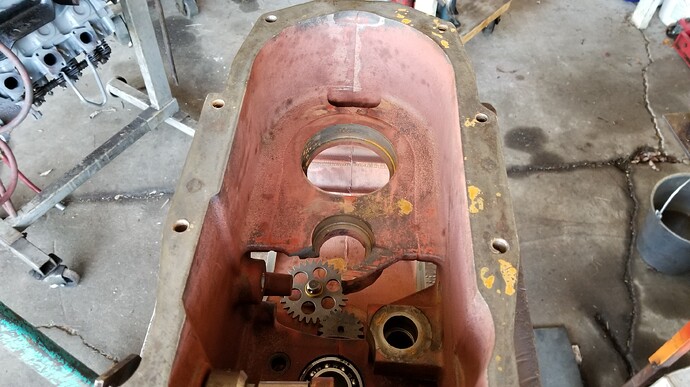

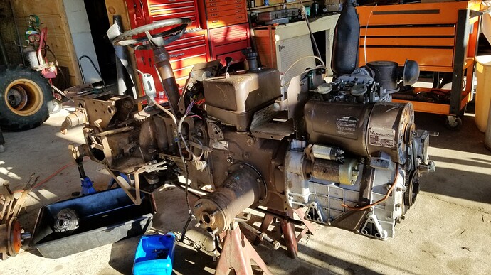

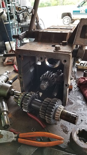

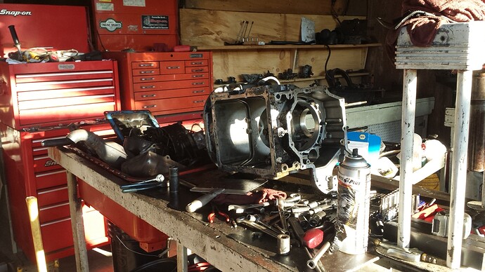

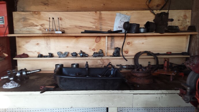

There are a few photos of all the parts… got the transmission apart today found the input bearing on the main shaft is junk but we didn’t find anything to really explain the shifting issues. I started cleaning parts today after mowing some hay in the morning. It was a long day but everything is apart now so that is progress. Well that is the update on that project just figured I would share a few photos.
The good news is I got the crank back the other day it is all set had never been touched so there was plenty of room to rework it.

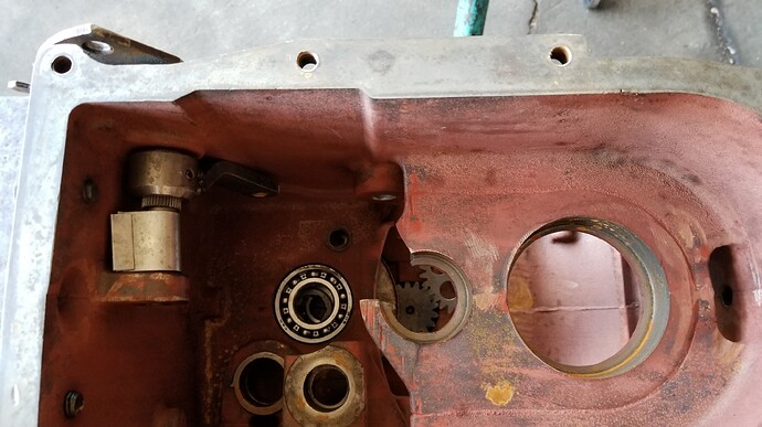

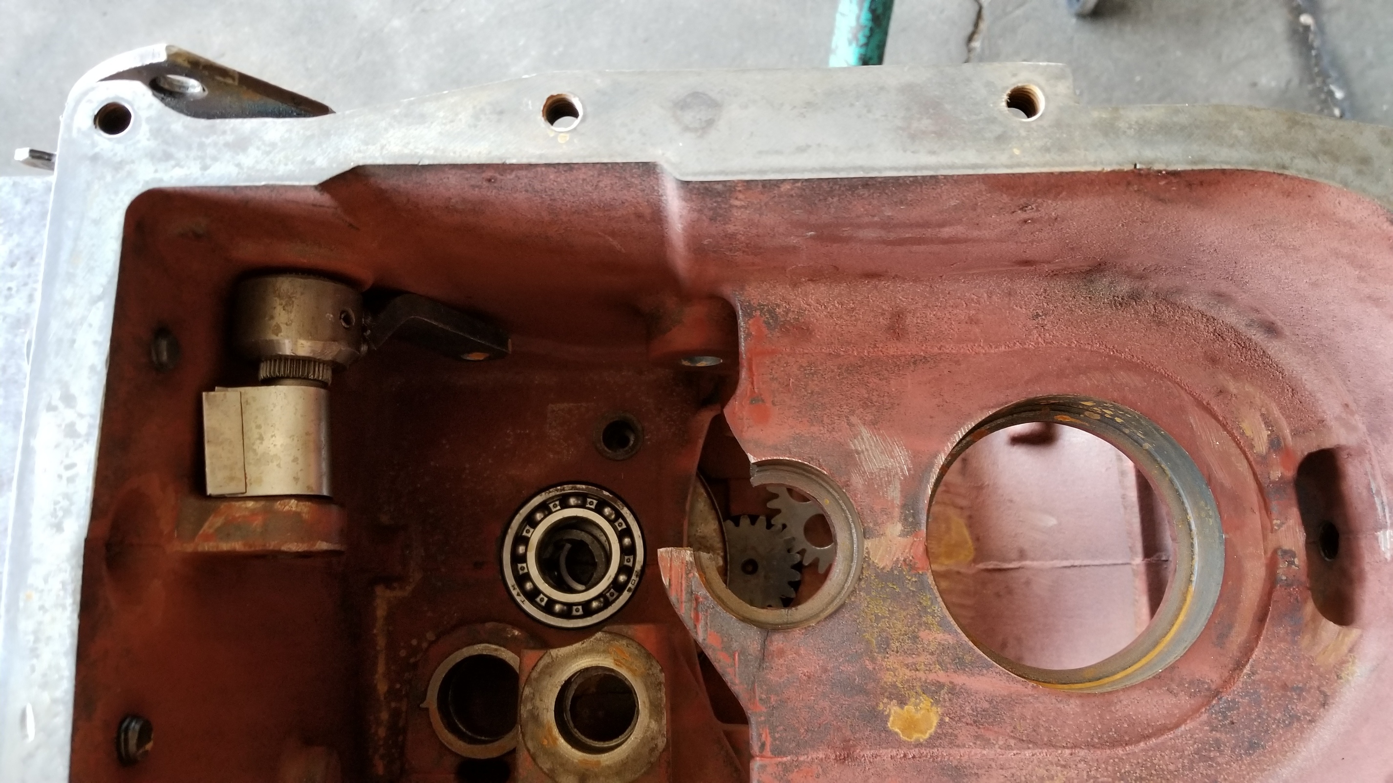

The bad news putting the transmission back together the other day there was a large bang. The something didn’t line up right and one of the bearing mounts got broken in the casting. It is fixable but really sucks to have to fix it when it wasn’t broken before my mechanic started…

Bob so am I. The transmission is back together and most of the motor. We where working in that yesterday. Well mostly Gary was working on it while I watched. It always amazes me how many little details there are to putting a motor back together right. It is a slow process when you can only work something in around everything else but it is making progress if all goes well it will be done in the spring and I will have one more fully restored tractor this summer. If it gets painted as well it will be my nicest tractor.

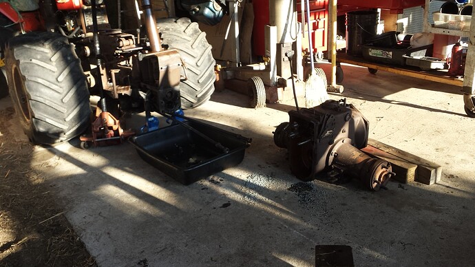

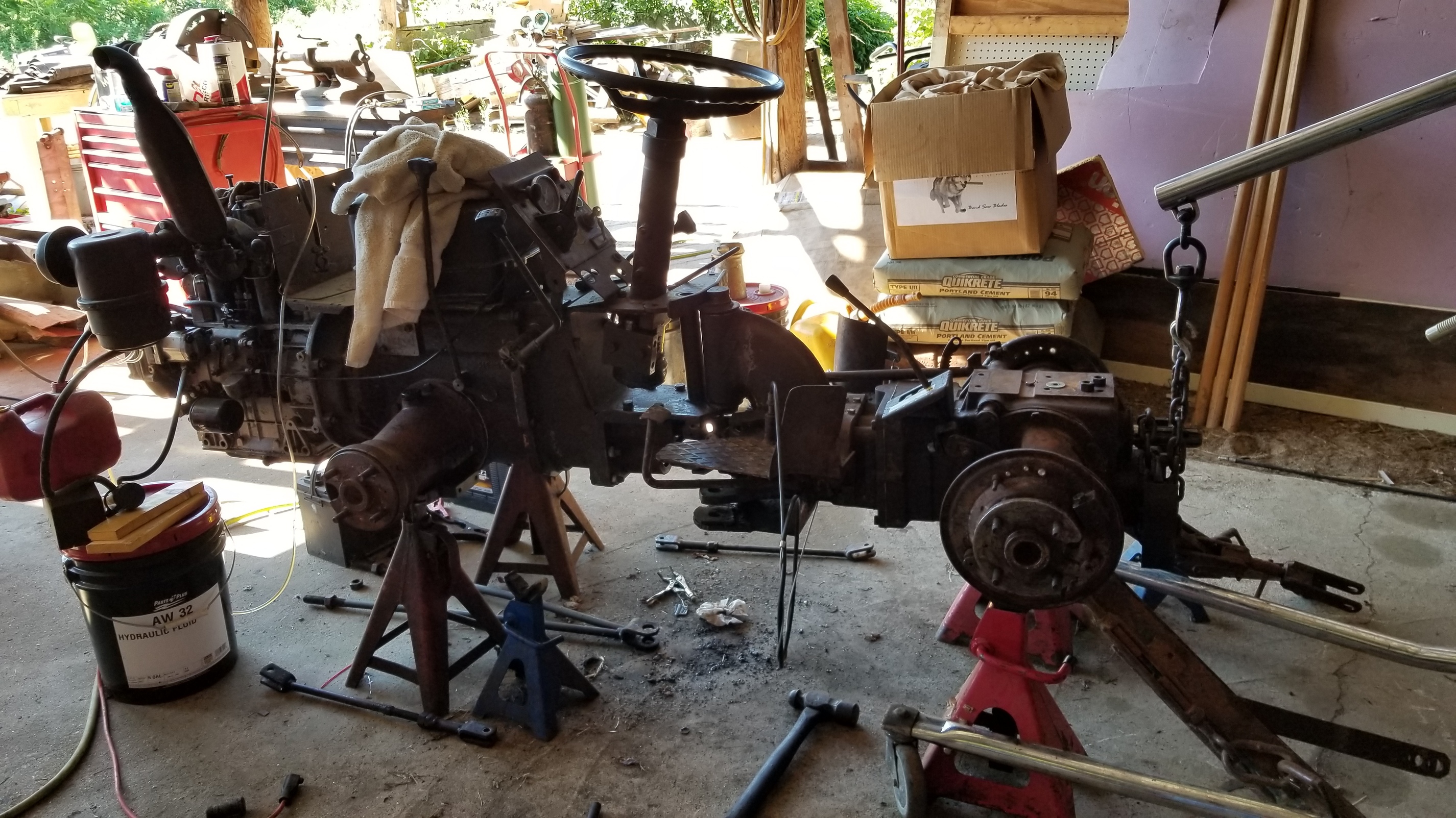

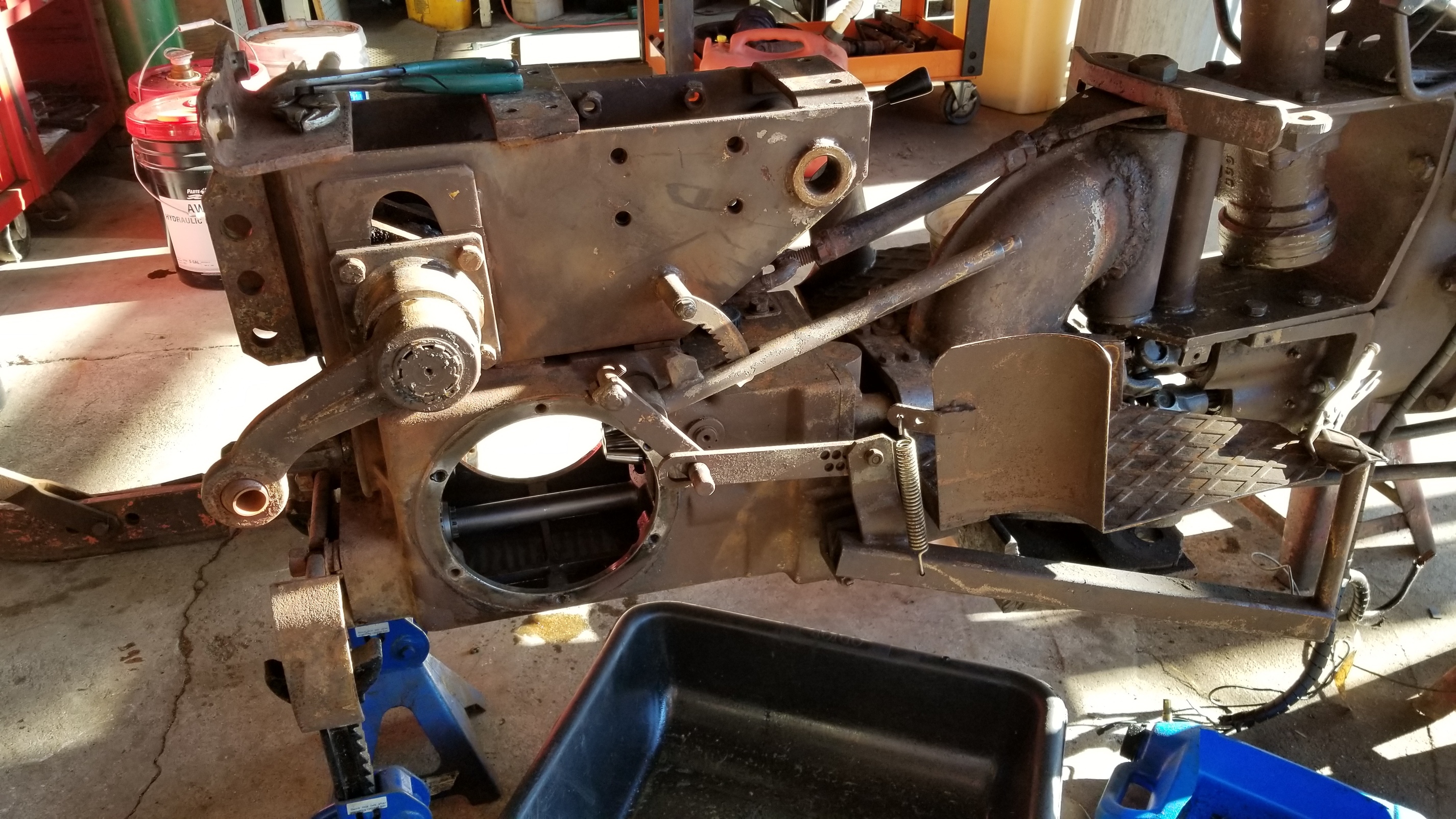

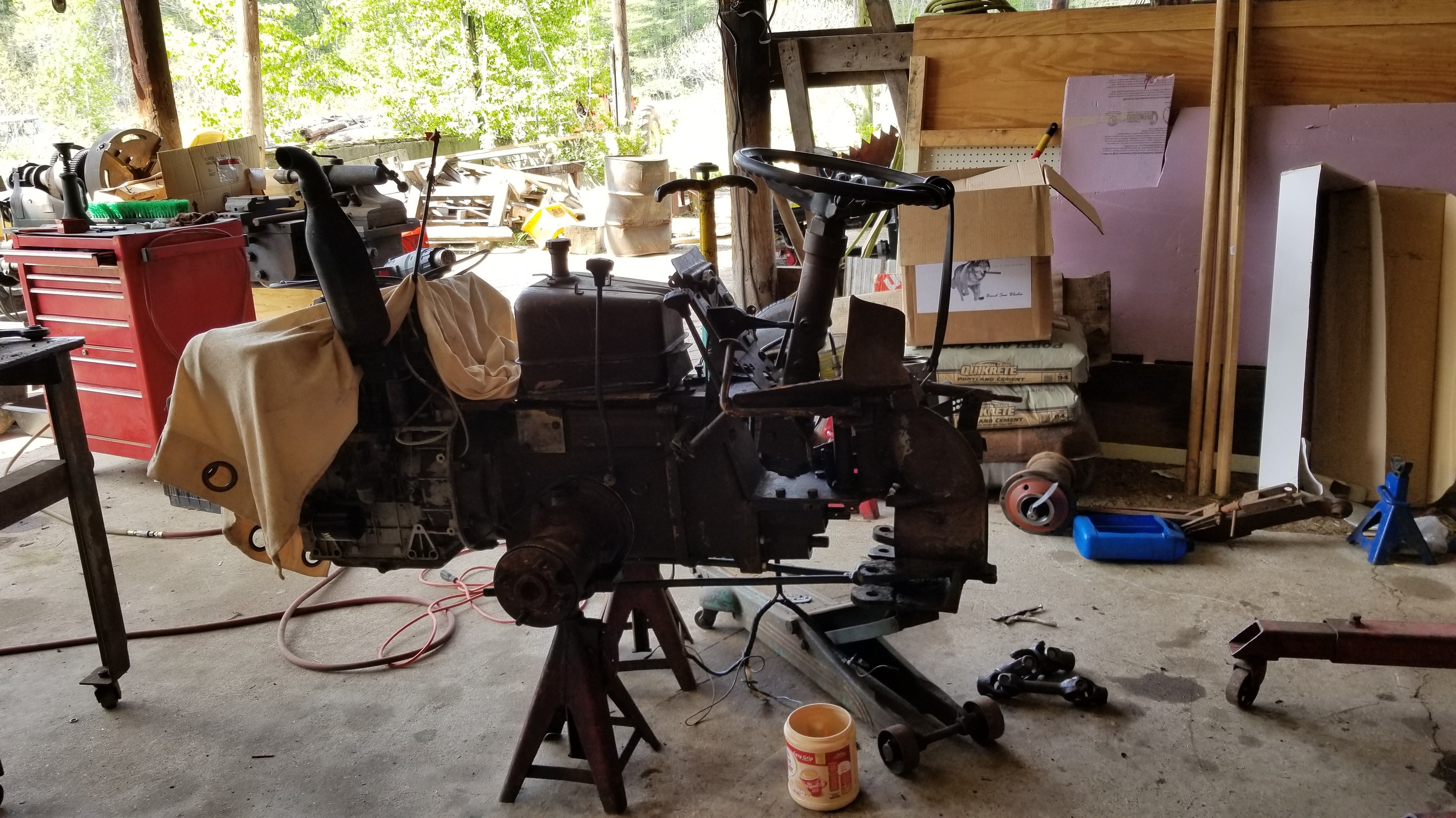

Spent time today working on the pasquali. We rebuilt the generator mounted the fuel tank and a few other things up front. Then we took the rear axles off and found out we cant get to the linkage we need to without taking the rear end off. Still trying to figure out what the rear axle function should actually be. There is a independent neutral sync lever which only seems to move from neutral to sync but somehow it only works on the input shaft to the rear end the differential is already out and doesn’t lock any way I can see. I am truly confused now. I guess i will see when we pull off the rear end and look inside.

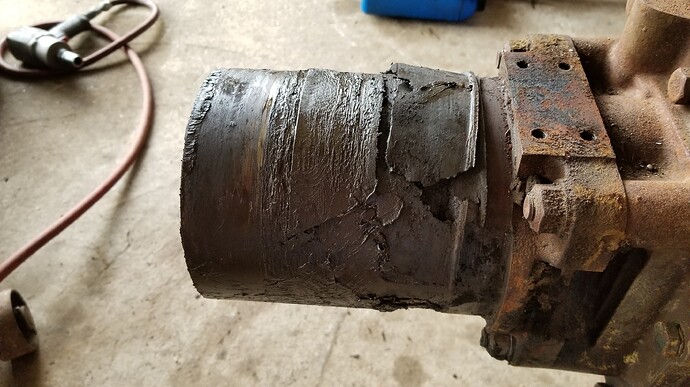

The shim on the pivot is gone just a few bits left now we know why it was loose.

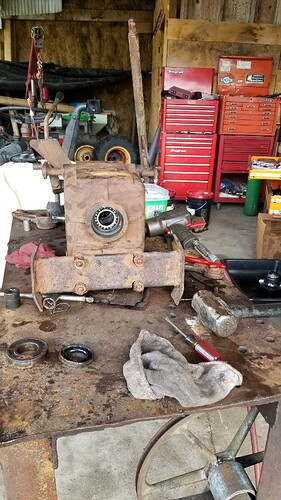

The rear end is totally apart. The rear end was run without oil for a long time before I got the tractor. The bearing for the pto are junk.
Oh and the mystery lever isn’t a locking diff like I was told. It determines if the pto is running at pro speed (540 or 720 selectable at the transmission) neutral or wheel speed. That is how they power to a trailer that has a driven axle. Now I know. Oh the input bearing to the rear end is also junk. I have actually taken this entire tractor apart from the very front to the very back and fixed everything we could find wrong which was alot of stuff.

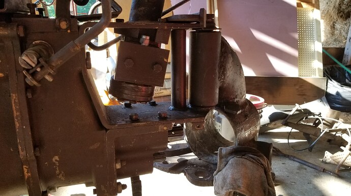

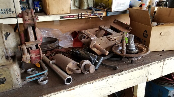

Well just a couple of quick things on the pasquali the last couple of days. While waiting for John Deere custom parts for my mower we got a few things done one the pasquali and the trencher.

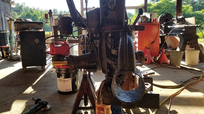

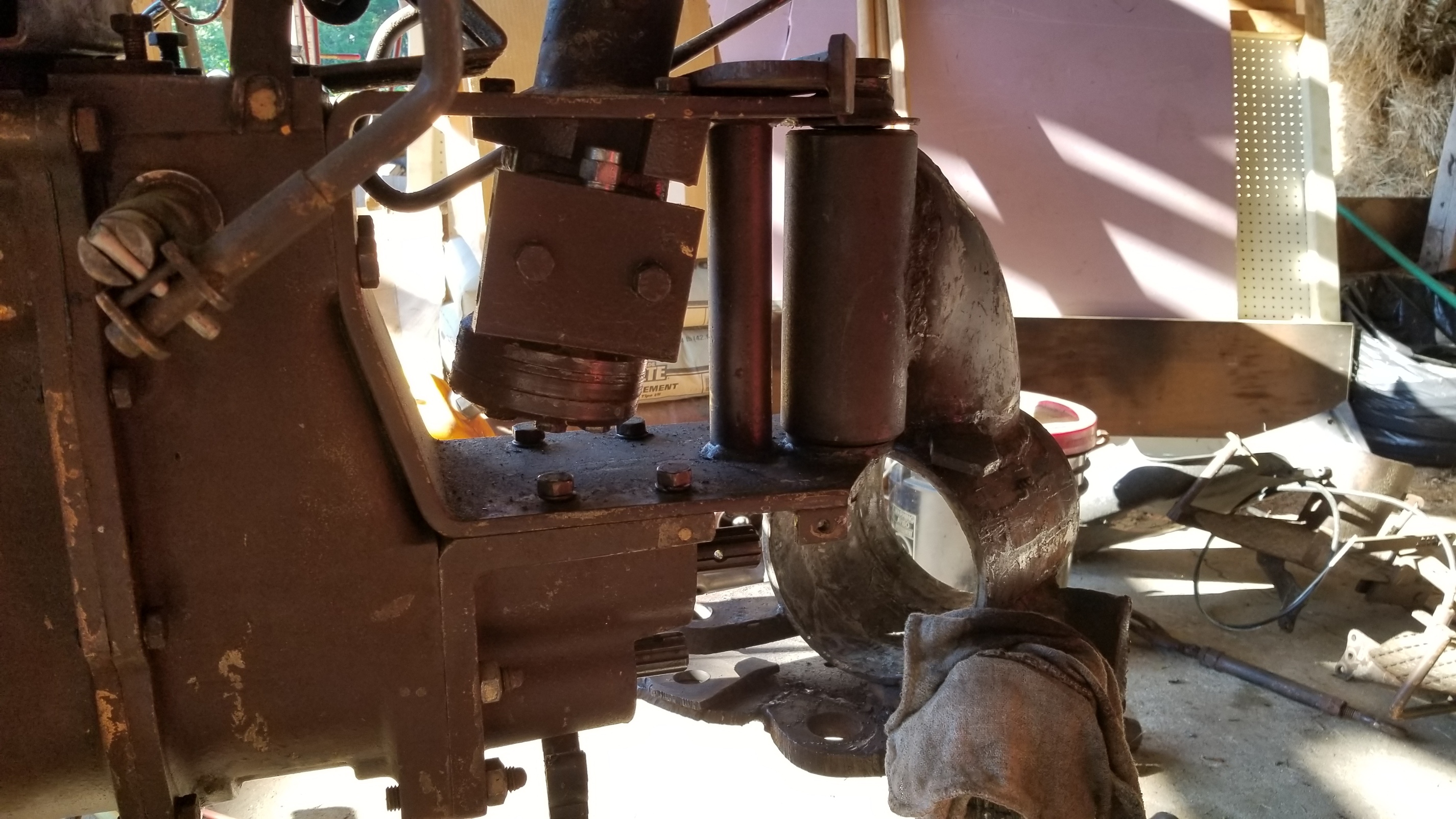

The shim that wasn’t available has been replaced with a fiberglass one custom built to match the ware on the outer casing the inner part was put on a latch and checked it is so close to no ware as to make no difference the outer was clearly softer metal.
There are also new bearing top and bottom of the pivot joint on the smaller tube. We should have everything we need to put the reverend together and back on the tractor now.
The trencher was small mantaince things. Replacing a control cable so it will actually backup now at full speed. Swapping some lines around so the cylinder actually move the way they should when you use the controls small things like that but about a days work on it non the less. I have already used the grader blade and the backhoe on the trencher and really like it. Anyway I digress. I just wanted to show you how we used fiberglass cloth to make a shim for the pivot joint on the pasquali. It will be much tighter now for sure.

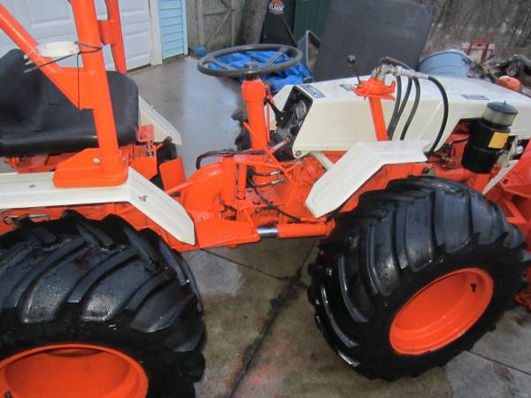

00t0t_c4ReCtr9poJ_600x450
That is the color scheme by pasquali that I am going for. They had alot of different colors they used and I honestly don’t know what the original color for this one is because I can’t find that brown anywhere. I am going to use allis Chalmers Persian orange #2 and the AC cream I have some anyway left over from my D15 and it will look good matching the colors of the other 2 tractor.
Excellent colour choices.
