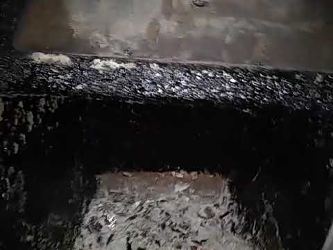

Here I filmed my boiler, which works on wood chips or logs, it was never necessary to remove the creosote coating in the firebox, as it deviates from the wall, and in the chimney it is practically absent, only fine ash. Based on the observation, it was necessary to balance the ratio between the gasification air and the combustion air and to keep it stable at different operating powers.
I’m surprised you get any creosote in your fire box Tone. The U shaped duct run on my stove is like what you showed when you removed the plate. Just fine white ash. Any creosote I get is in my flue and that’s only because I have to do a dead cold start every morning so there is some unburned smoke going up the flue. I normally just brush it out and vacuum out the cleanouts once during the winter. My flue is 30 ft long and the temp where is comes out of the top of the stove in never more than 300F so at those temps anything in the smoke will tend to condense on the flue walls.

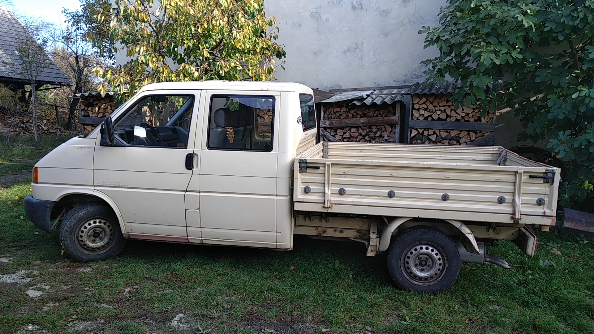

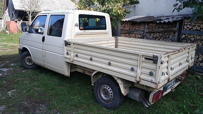

Maybe this T4 snchro 2.4 diesel will smell wood gas, otherwise it is from brother Primož, …
I think it would turn out to be an interesting option for travel and household if it was converted for spark ignition, since the fuel pumps of such engines have a lot of electronics, and the Audi ignition distributor, from a five-cylinder gasoline engine, would be very appropriate.
