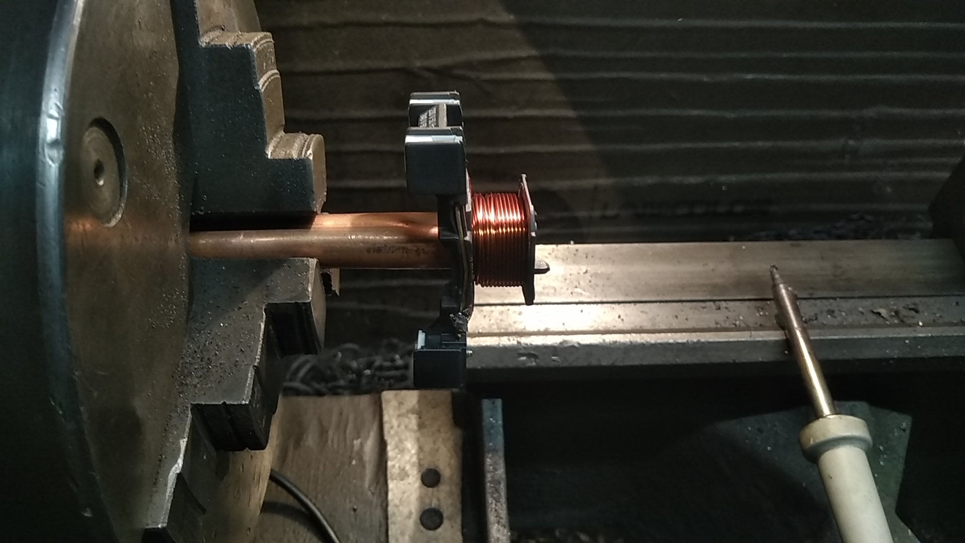

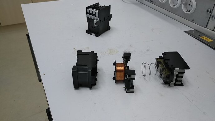

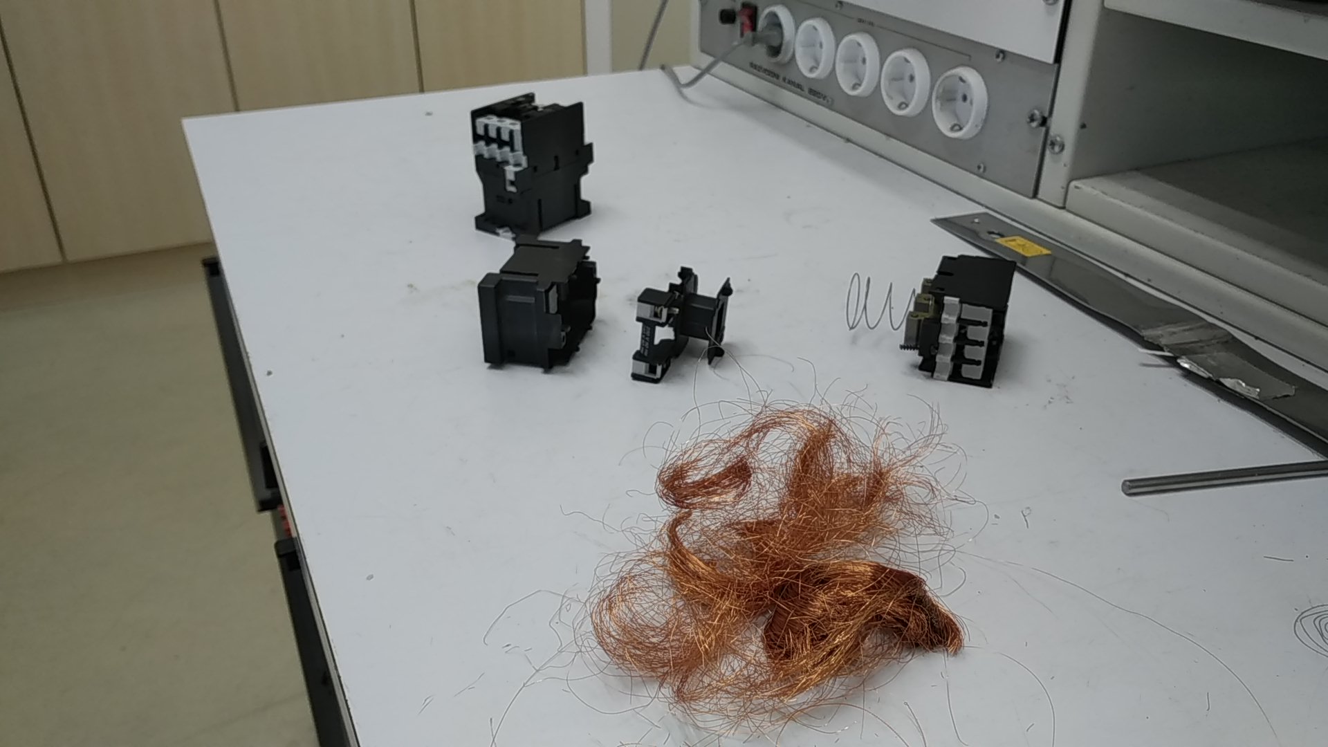

Joep and I had some correspondence about the operation of the asynchronous generator with the mains and how to disconnect it in time when the gasifier runs out of fuel. I hope he won’t be upset if I post the result here. I used a normal contactor , removed the existing 220V magnetic coil and replaced it with a stronger 1mm 50 turns copper wire. A current of one phase will flow through this winding and when it falls below 1A , the magnetisation of the core weakens enough to disconnect it.

Clever, but I dont see it working on a single cylinder. At least I couldnt find the sweet spot around 3000 rpm when current should be zero. Maybe on a multicylinder?
How big is your motor? All the current has to go through the magnetic coil?
Super KISS! Prove I am wrong please!!

Joep, you see what good advice for switching off and protection Kristjan and Jo gave us, thank you, I will add that. Otherwise, the electric generator does not know whether it is powered by a single-cylinder or multi-cylinder motor, the only question is how much the current drops at 50Hz or 3000rpm. I have a 5kW electric motor and a two-cylinder Kubota 500ccm with a pulley ratio to run at 2300rpm.
Joep, let me add, if by chance the current 1A is too small to disconnect, we simply reduce the number of turns on the current coil and it disengages at a higher current.
