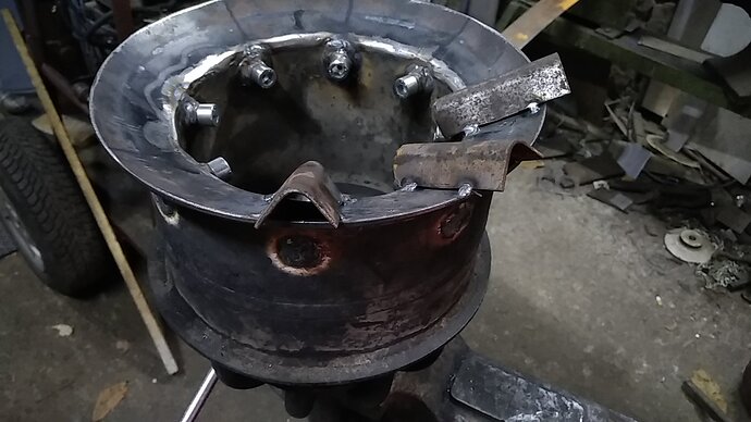

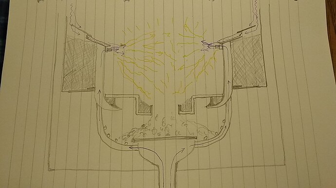

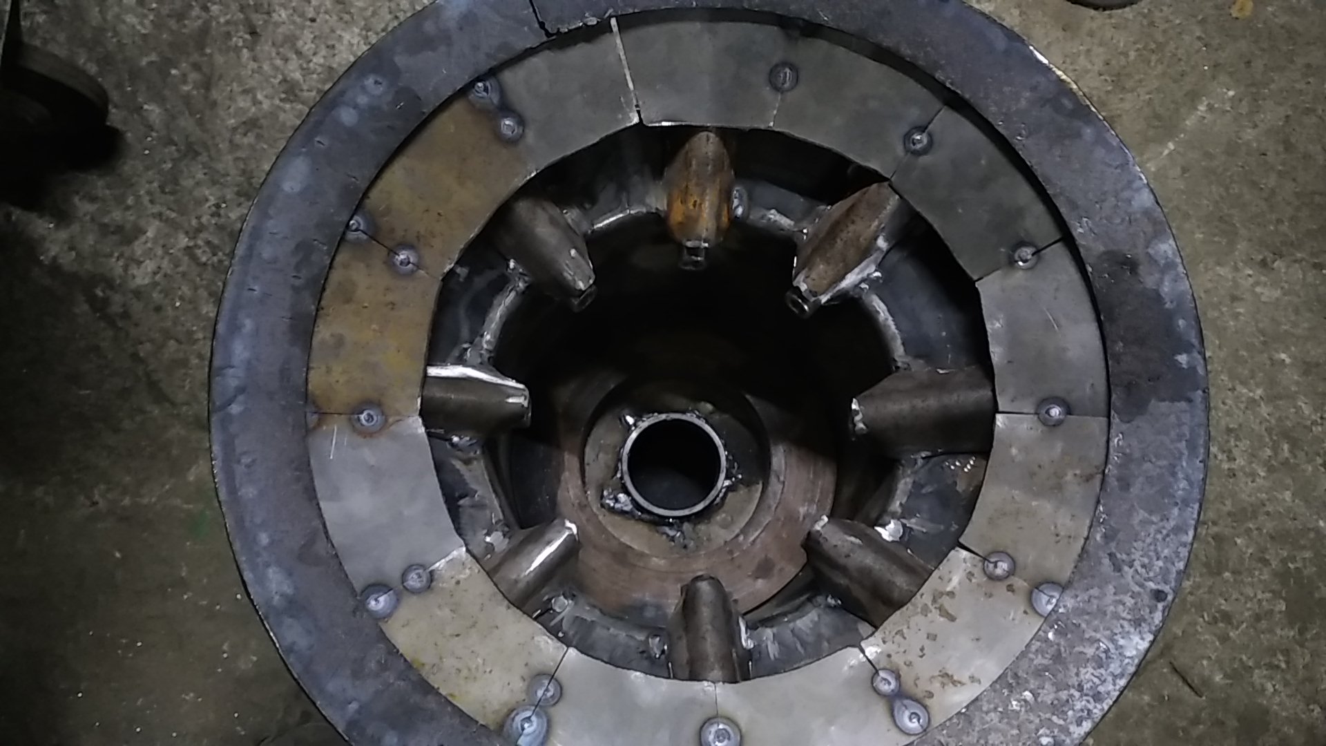

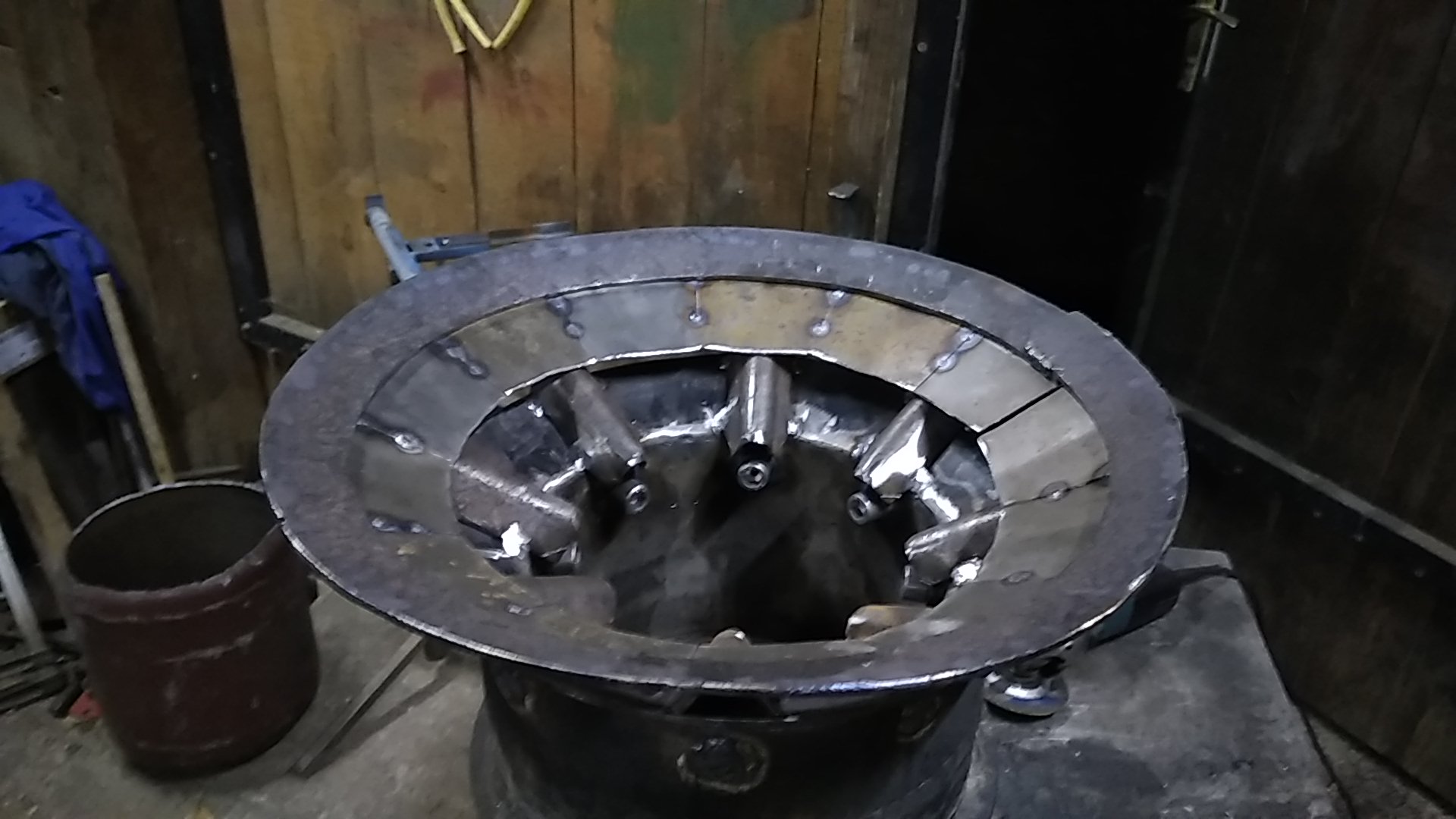

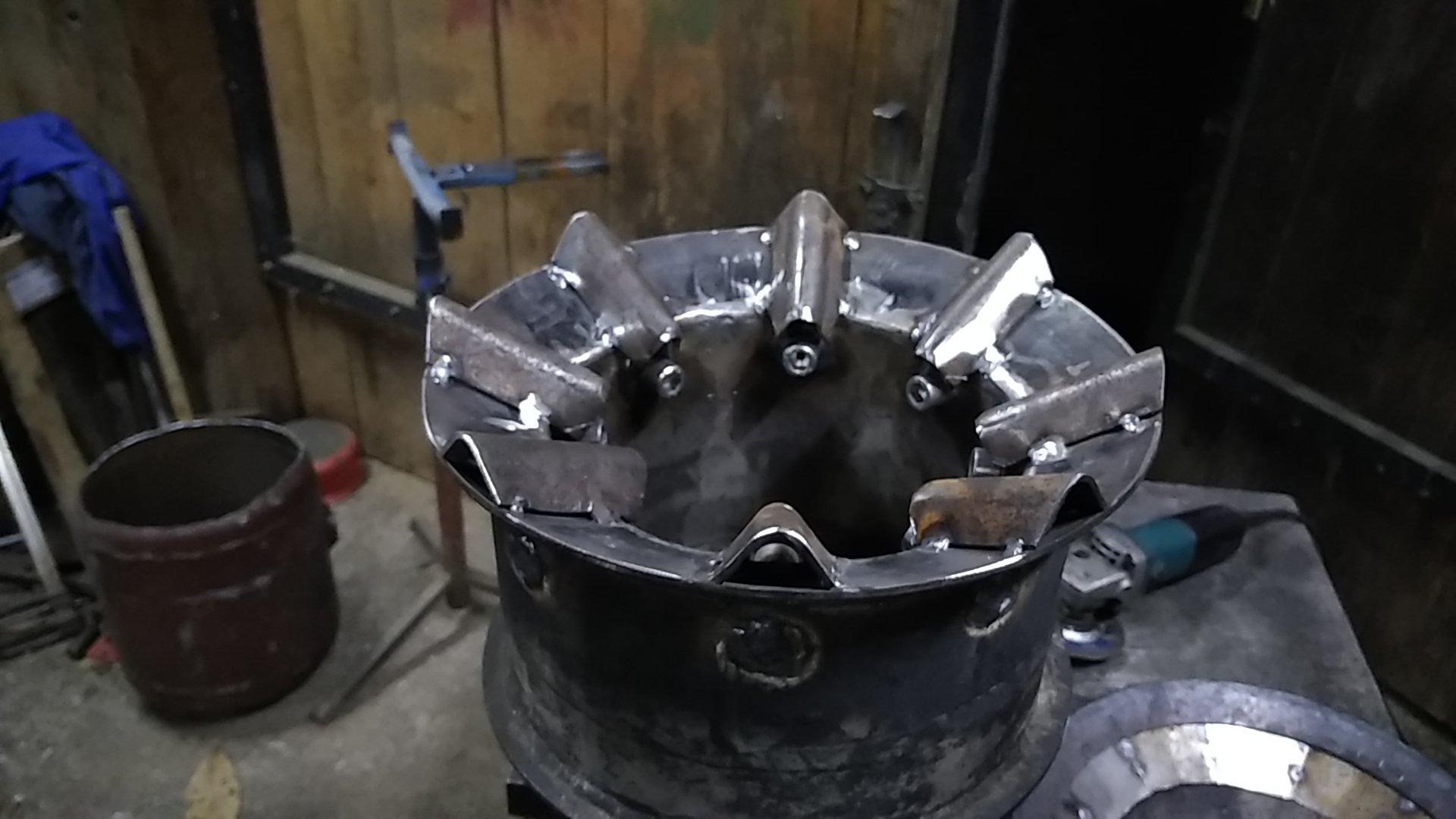

Kristjan is doing engine tuning on his Skoda (I feel a bit guilty that he dismantled a working engine and now it’s freezing next door) but I’ve started tuning the heart of the gasifier, lowering the fire hose a bit, additional nozzles to mix the pyrolysis gases with fresh air, bearing ring in the restriction,…
Jo , don’t laugh too much , we Slovenians have a birth defect. :grinning_face:
Your gasifier looks like a uterus. Too weird? Then I apologize.
what can I say, the heart of the gasifier has become so, the desire is for the pyrolysis gases that go down the wall and the fresh air to mix and then hit the glowing charcoal. The upper ring, however, will shake the fuel.
