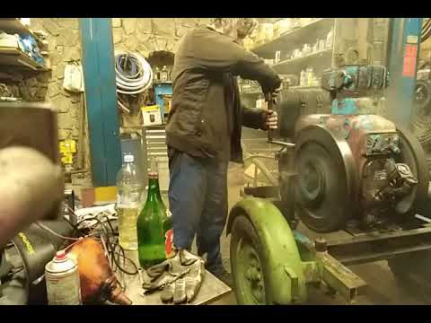

Neighbor Janez came to visit, Janbacher is idle, and we warm ourselves with blueberries
:grinning:that is FUN. With capitals. And it can keep doing this for the next 50 years :grinning:
I think nothing surpasses the nice cadence of a slow running engine. Thanks for the video Tone.

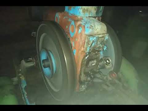

Here is another video for my “neighbors” who were with me in my workshop, well, Mr. Don will probably find some interesting detail, and JO usually always has some interesting comment,… greetings to all, Tone.
