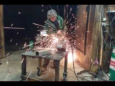

I installed an asynchronous motor that works as a generator, I used capacitors 3x137 microfarads, connected in a star, the motor is 15kW
I’m glad you got it to work!! Is that grinder 3-phase too?
You appear to being getting more grey in the fuzzy areas Tone. Working 24 hours a day, which you must be doing to accomplish all these projects, takes it’s toll after a while. That’s OK. Makes you look wise and distinguished. ![]()
That’s fantastic, Tone. Are there no problems at variable loads with a fixed capacitance? Or did you add some extra gizmos you didn’t tell us about?What kind of governor does an engine like that have?
I used only 3×30 uF for my 11.5kW asyncronius motor and I could use about half its power before it slipped electrically. Are there no downsides upgrading the capacitance?
I owe you an apology because I wrote that the engine power is 15 kW, in fact it is 15 hp, which is equal to 11 kW.
JO , there are no secrets, the fixed capacitance works well, well, the voltage drops a bit under load, but it’s not particularly annoying. I have already written this, but I will say it again, it is best to use an electric motor with high revolutions (2900 rpm), because it needs a less strong magnetic field inside due to the high speed of the rotor, so 3x100 microfarad capacitors are suitable for a 10kW motor. Here I used 3x137 because I had it on hand, the voltage reaches 230V even at 40-45 Hz without load.

Sean, grinder is 1 phase 230 V, probably, but you never know with Tone.
This picture will say it all,… Makita friction cutter is a single-phase 2kW, if you ever try such a three-phase generator, you will be surprised by the output power of a single-phase load.
