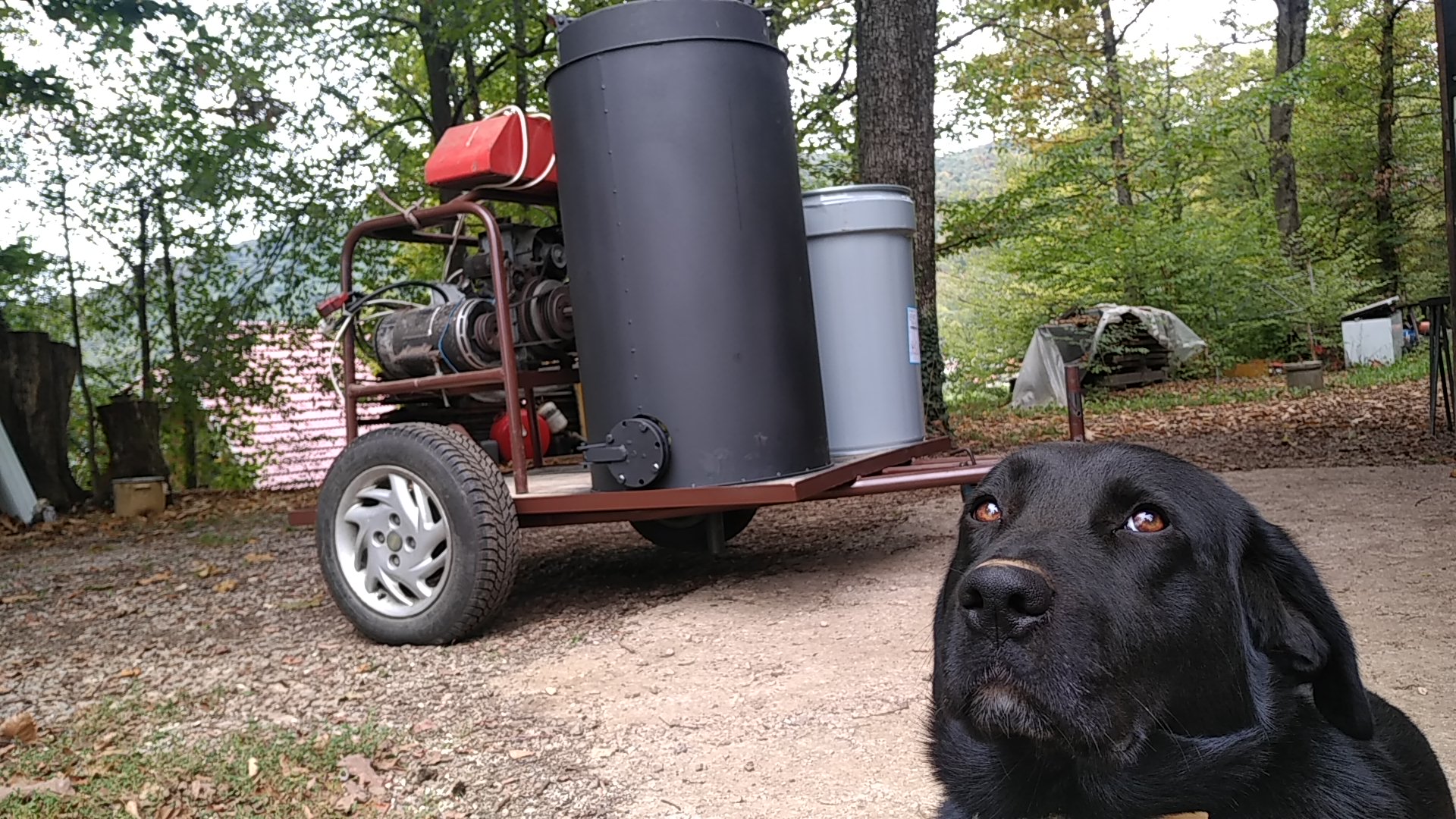

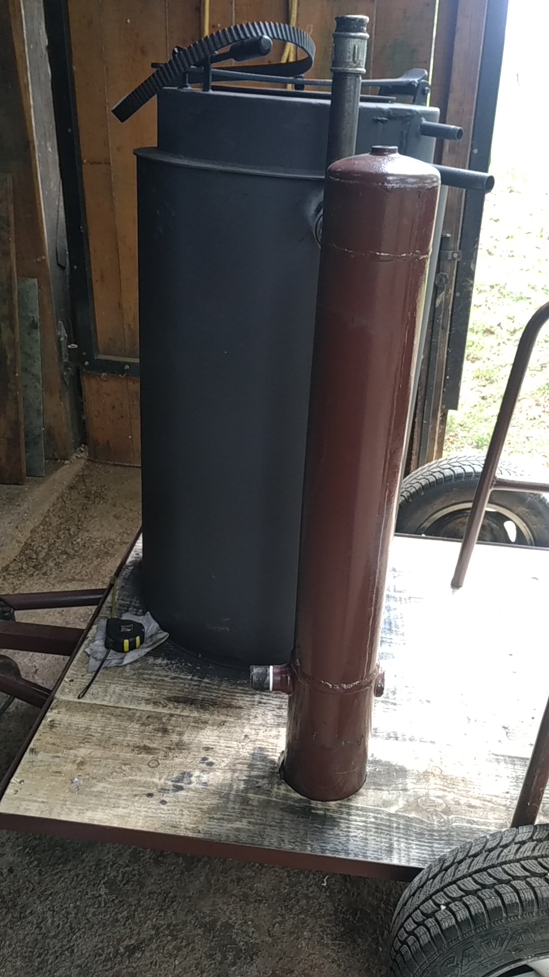

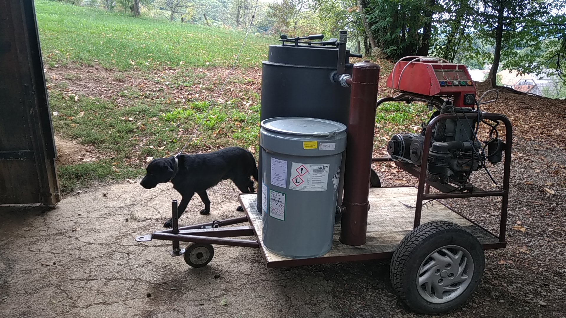

the project is progressing slowly, I had to rework the chassis of the trailer because it was an obstacle to the release from the cyclone, … curiosity does not give me peace ..,.

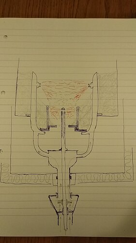

I think about what is happening in the hot zone, the nozzles in the ring supply air, which causes a layer of burning charcoal at higher flows, which is a condition for tar decomposition, but if the gas flow is small, the annealing layer is smaller and the tar does not decompose completely. What do you think if you added another in the middle 10 cm above the limit of the center nozzle to maintain annealing in the lower part.? Construction
gasifier allows me to do this.
More area with less flows yet?
Don, I’m attaching a sketch …

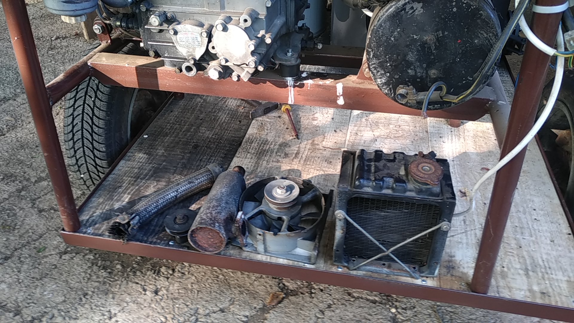

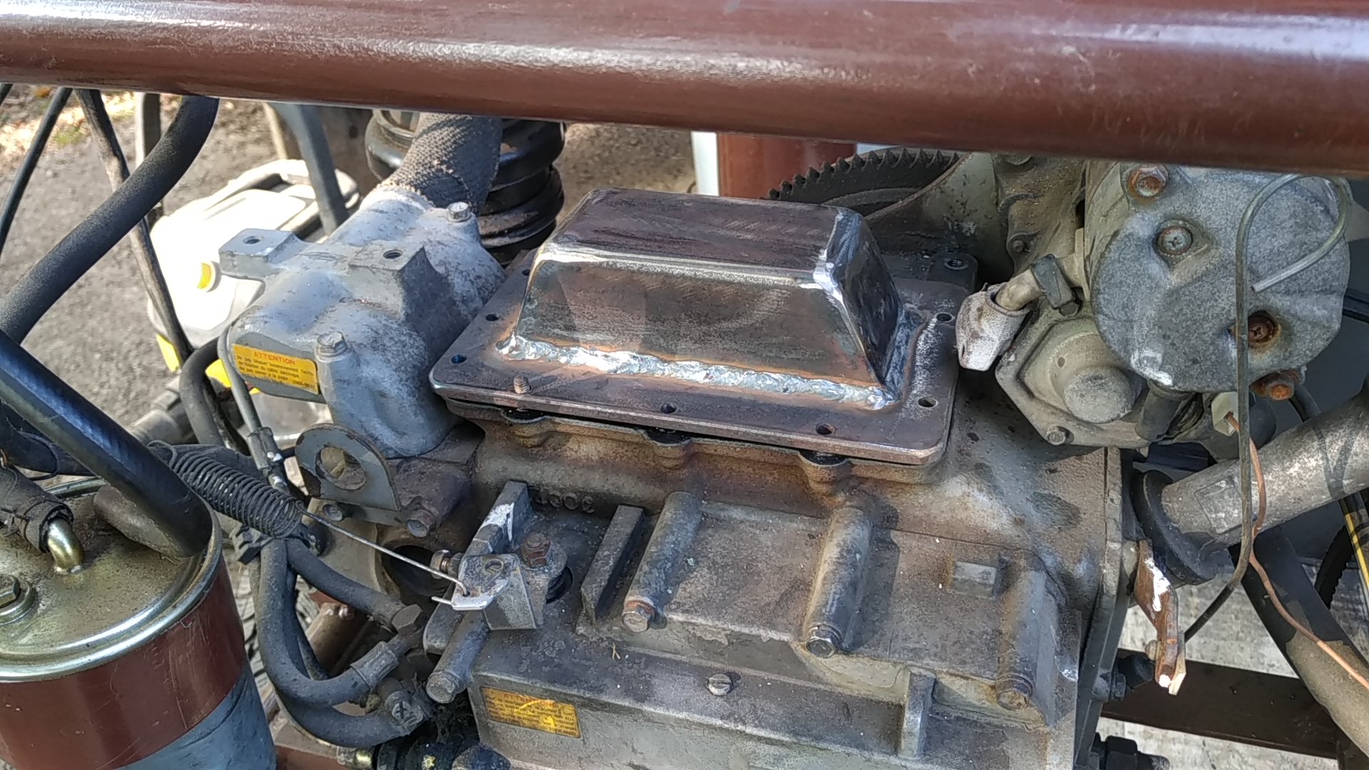

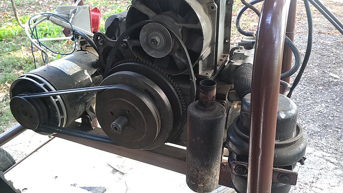

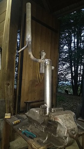

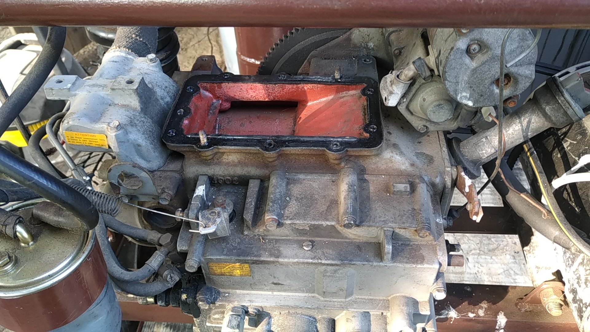

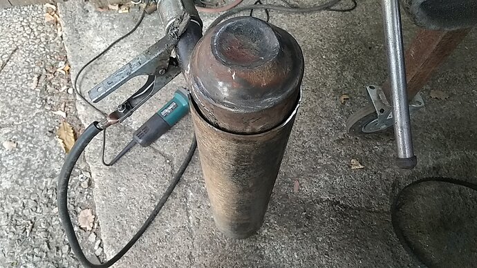

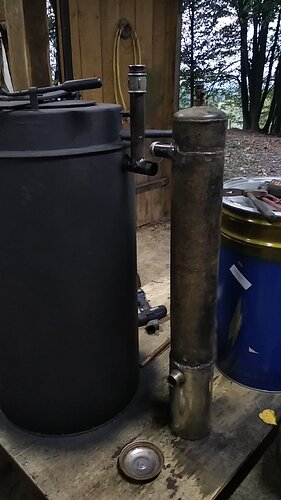

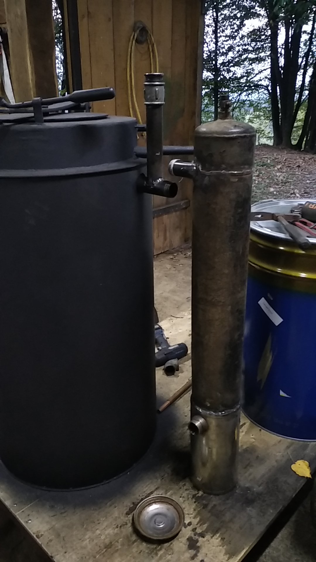

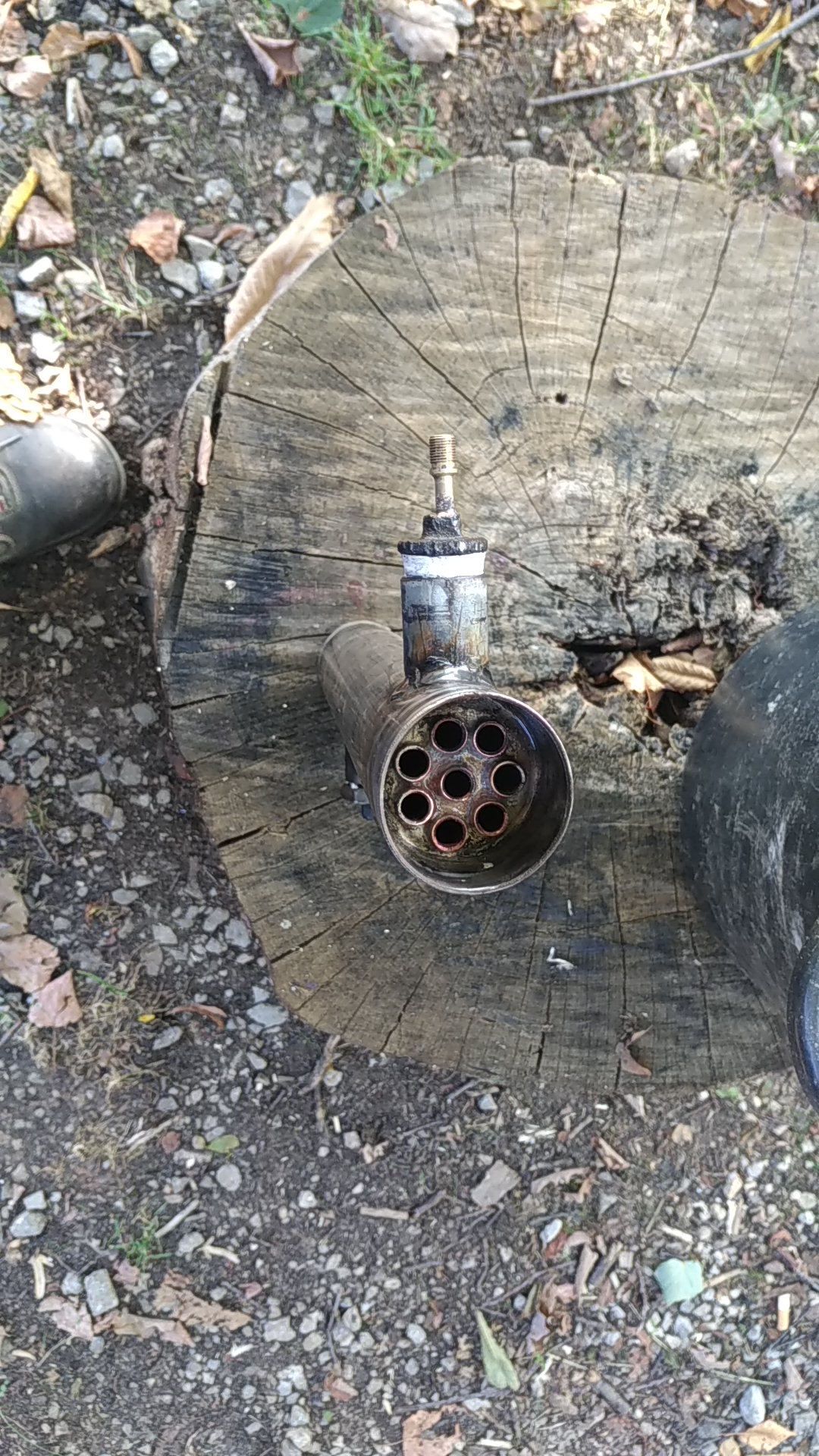

I undertook engine conversion, dismantled the radiator and fan and muffler. Instead of a refrigerator, a lid with connections for cooling water, I also have to make an exhaust gas refrigerator, …

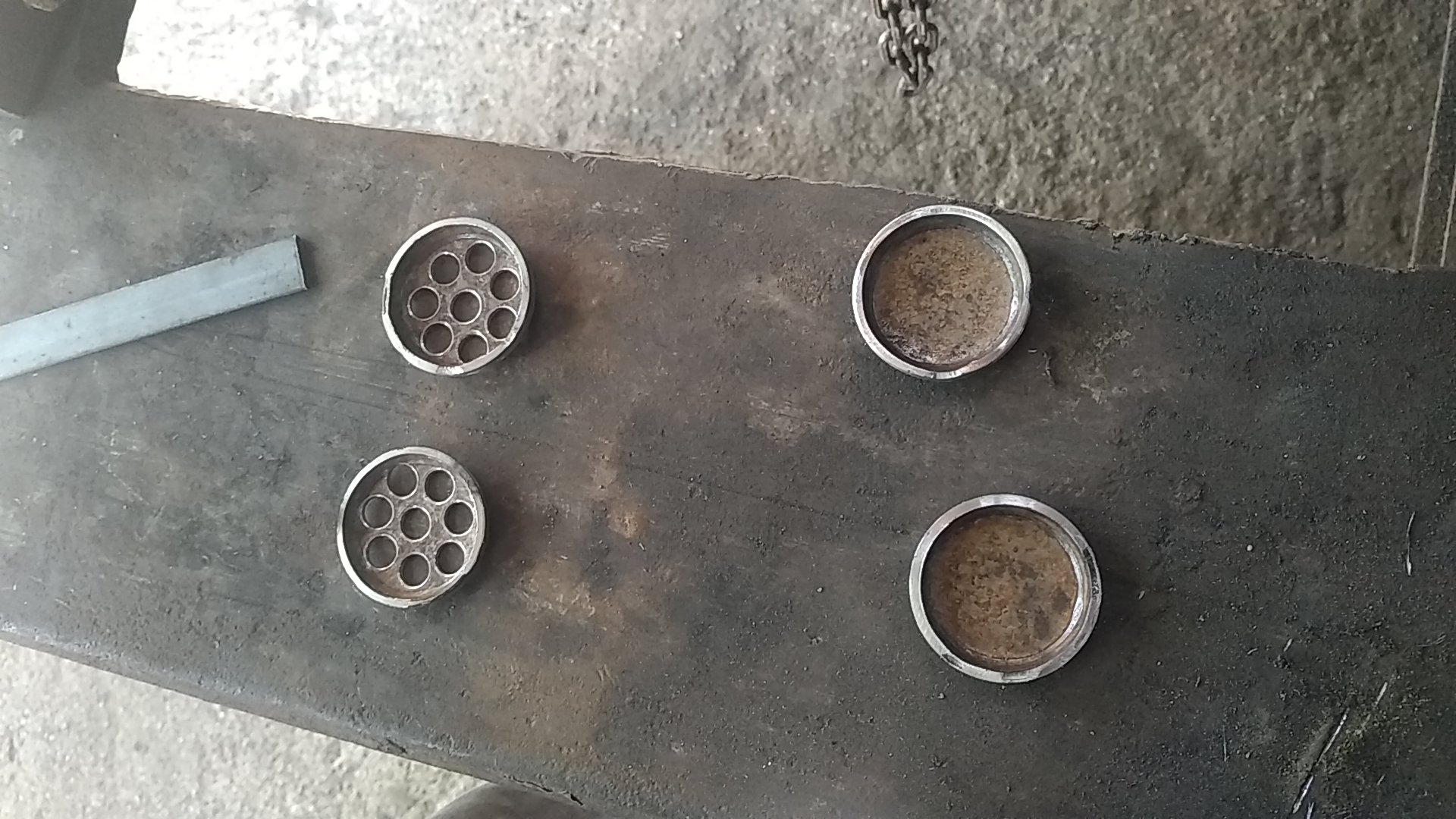

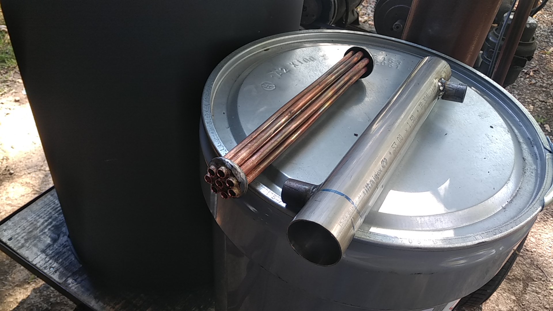

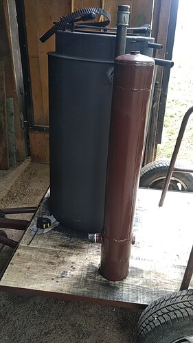

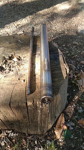

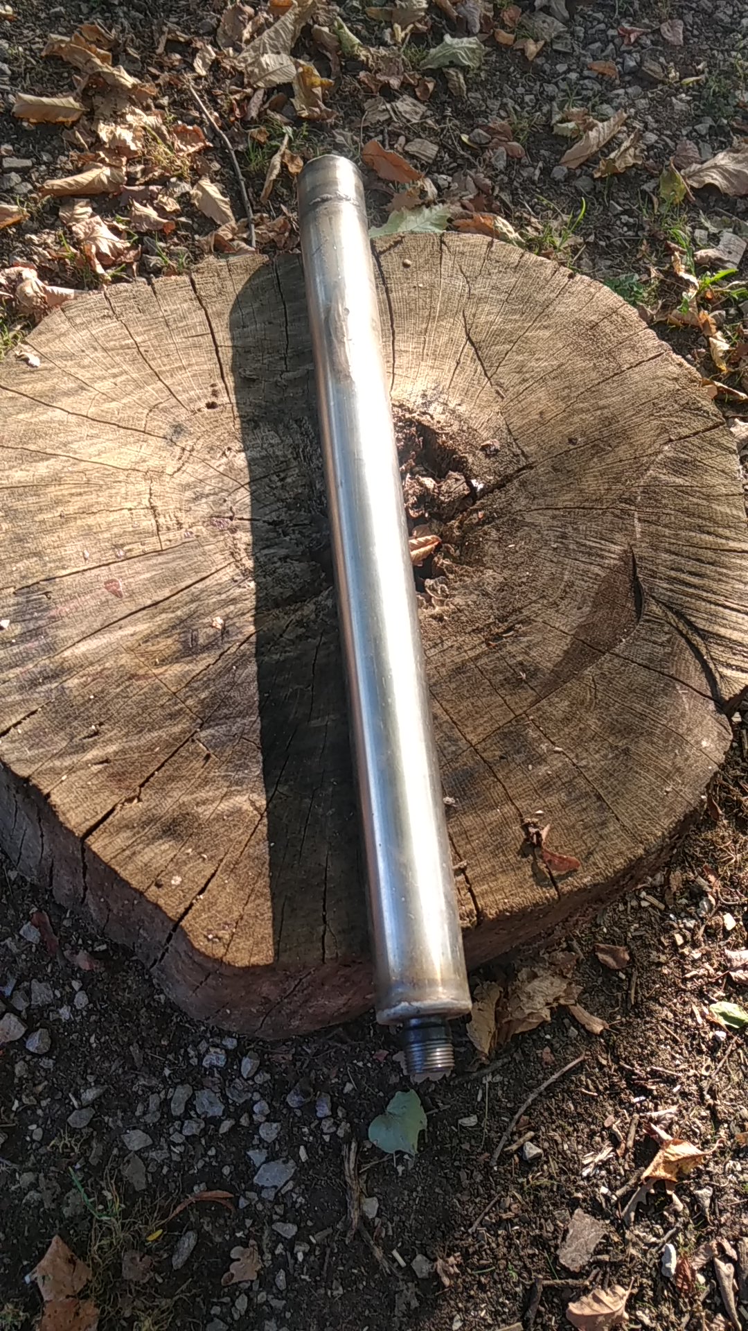

I am curious. Heat exchanger?

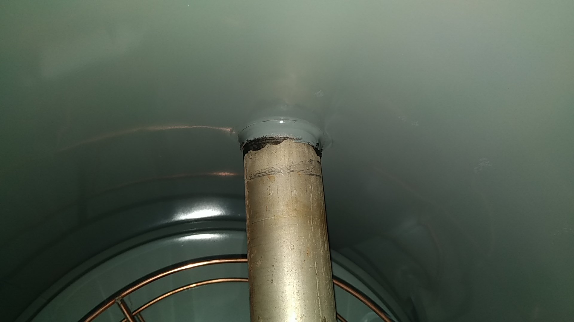

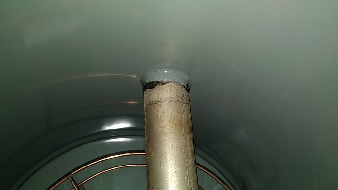

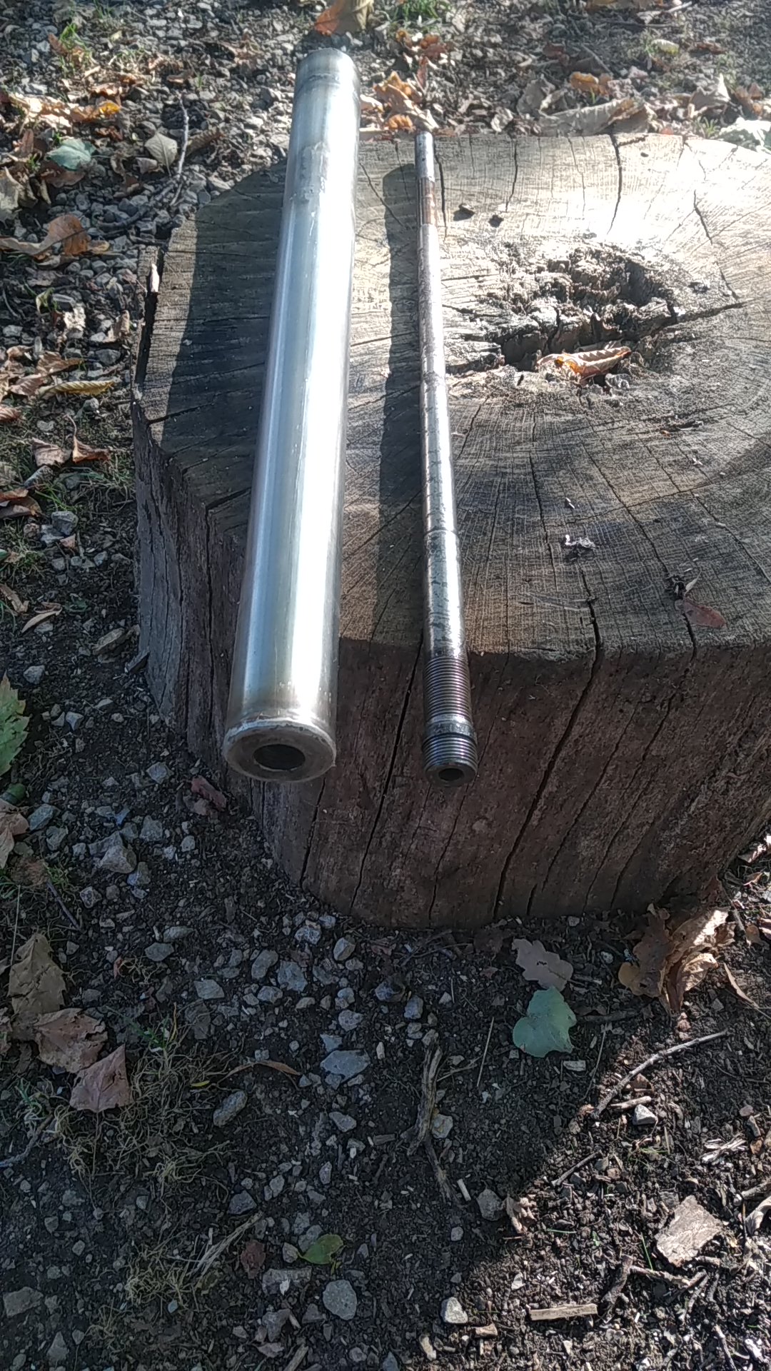

How do you seal the ends of the copper pipes?
Hello Don, the silver lot solves such situations, combines copper, iron, stainless iron, …
Wow, exhaust gases through the copper pipes and water through the one inch pipe?

You expect no problems with corrosion? Just asking, no idea.

Looks like a Shotgun Condenser used in alcohol distillation. Very interesting.
Cody beat me to it, looks like a shotgun condenser for brewing moonshine

Hello Joep, I have a copper tube at hand and it allows me easy work and good thermal conductivity. I also don’t know what it will be like with corrosion.

You can also get a flaring tool to expand the copper pipe into the holes on a steel plate. It’s how steam engine boilers are made. You want copper tubes so they’ll bust before steel or iron does and it’ll put out the fire.
