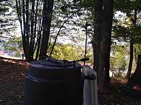

first start, … the gas is strong, I also tested it on a mower and a tractor, the condensation zone is still without cooling and the gas is quite humid, it will still take effort, water-cooled cyclone, filter, …
https://youtu.be/VYbNSS2cesw
yesterday I test gasified the wood for 6 hours, mostly with a turbine, the gas was constantly well flammable and worked very caloric, the boiler insulation works well and keeps the heat inside. It is interesting when I turn off the fan and cut off the air supply, the gas at the outlet burns for more than an hour, the seal is 100%, as Kristjan said, the reaction takes place without adding air.

Hello Jo, it actually burned, it burned the hair on my arm :grinning:, otherwise I smelled like gas on the gas. What does your lovely wife say to you, on wood gas perfume? :heart_eyes:
Tone, the woodgas perfume is nothing but a booster. From what I registered she says it smells manly and cozy :grin:
