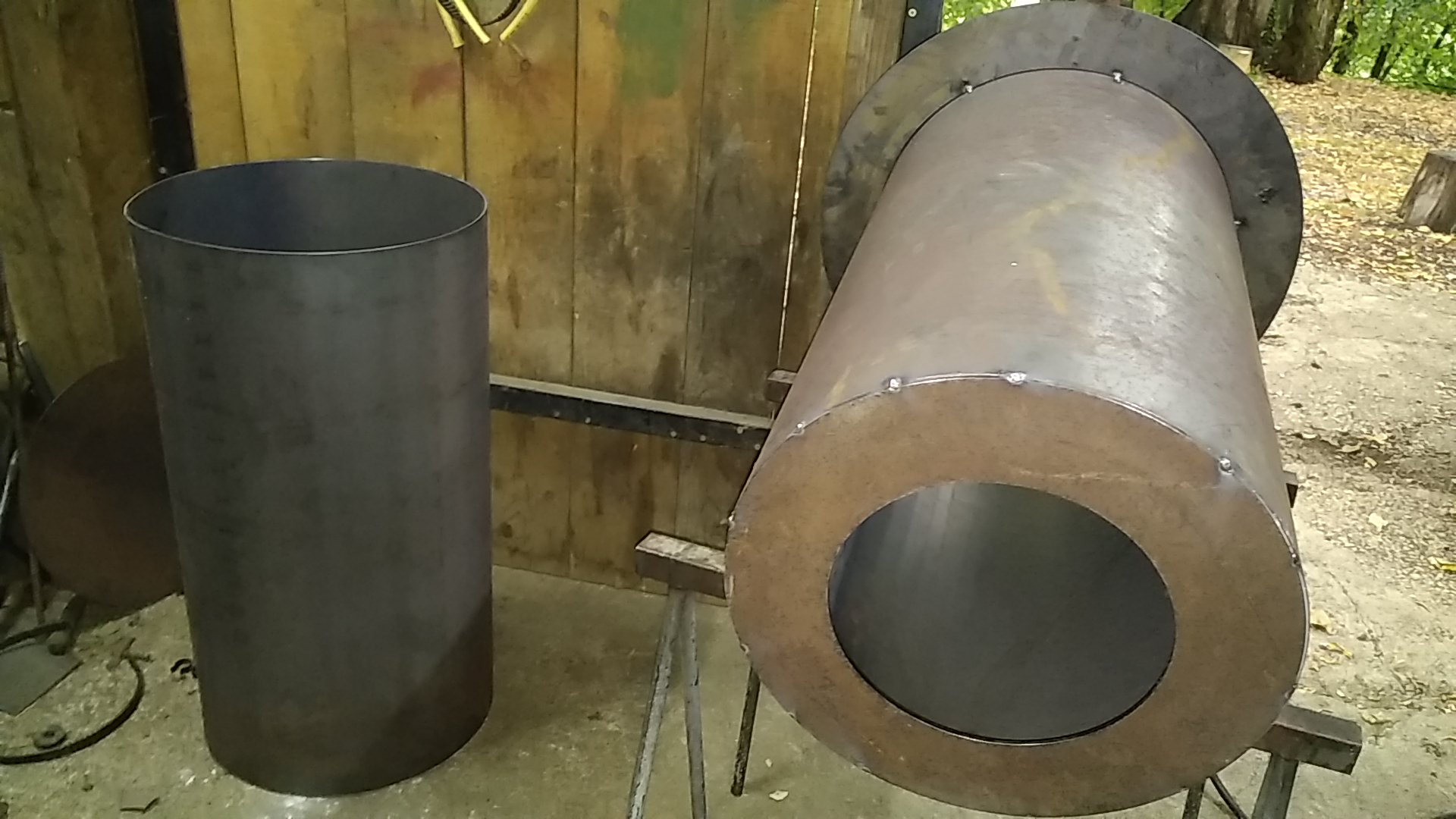

if it is pointed they will be fairies, if it is flat it will be a shovel

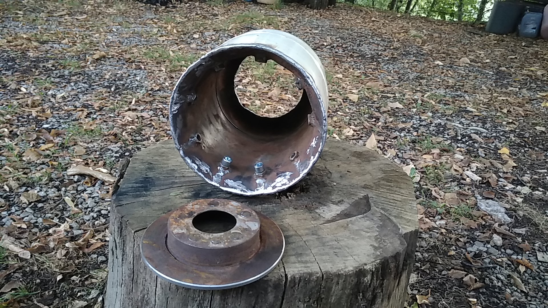

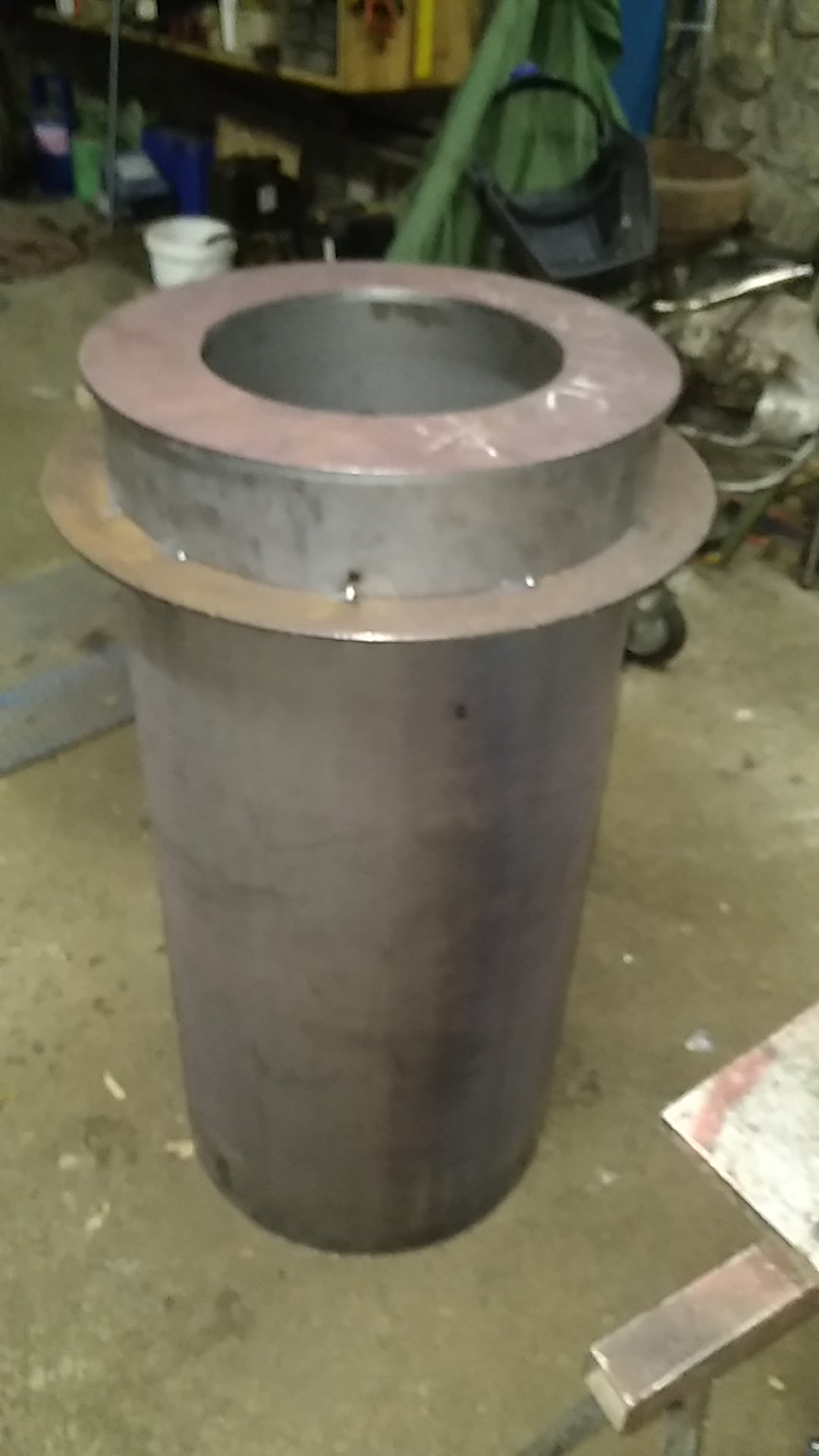

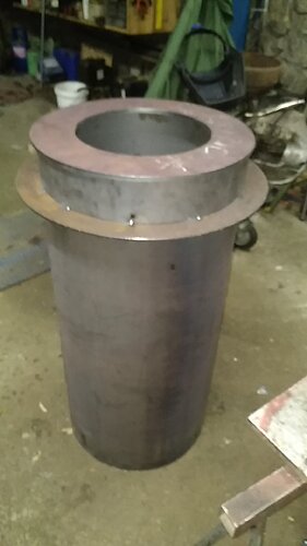

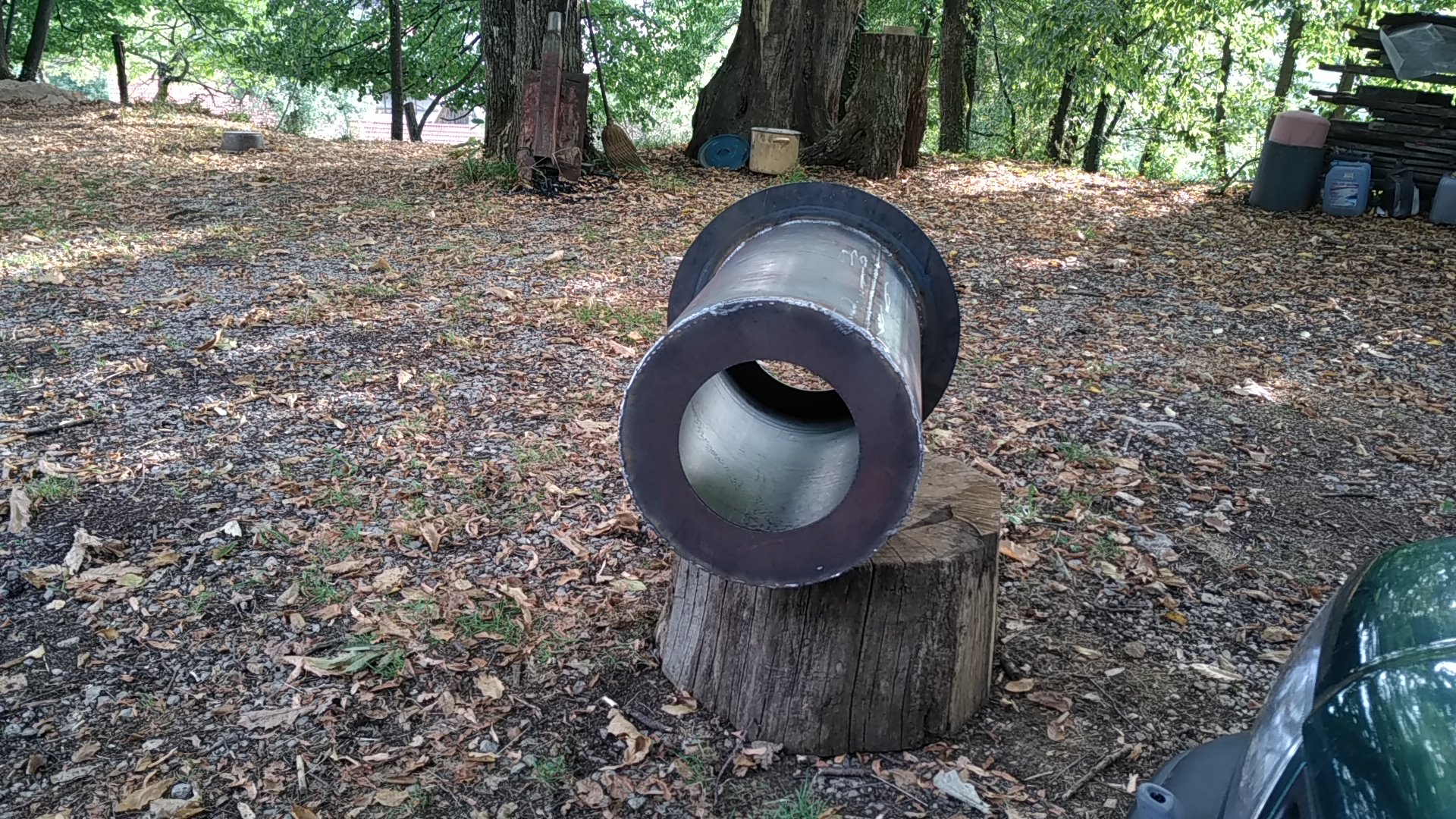

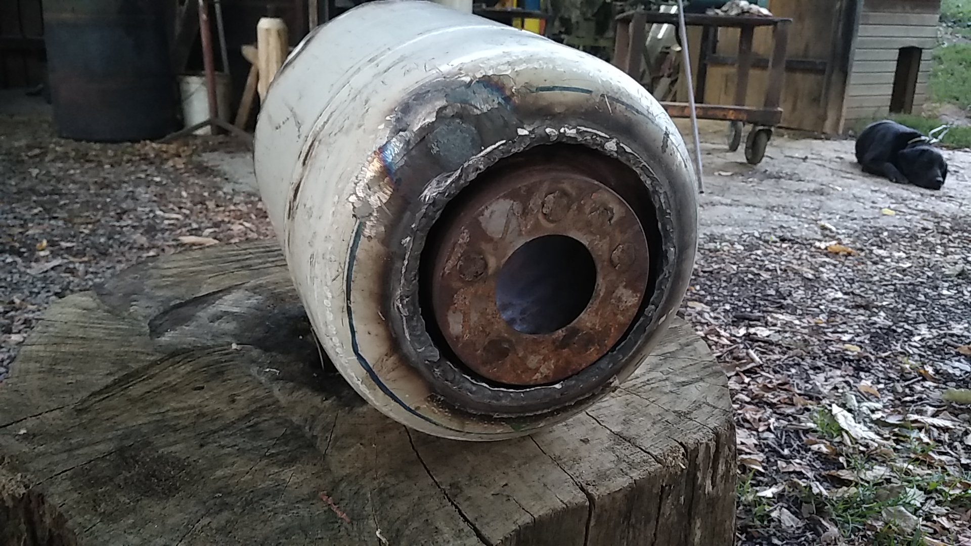

top plate spaced 6mm apart to allow steam to enter the water-cooled condensing zone

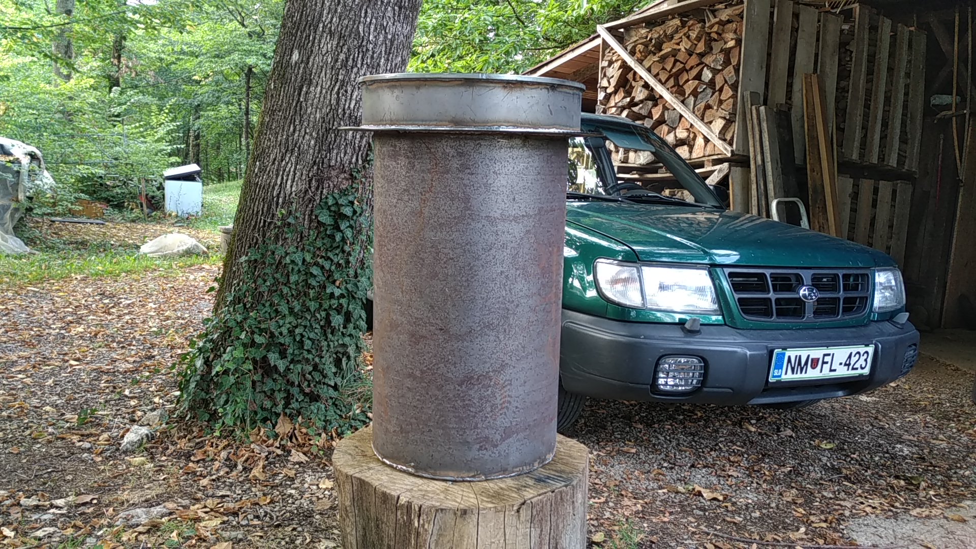

inner cylinder, condensation zone above
lower opening for inserting the disassembly firebox
another outer cylinder

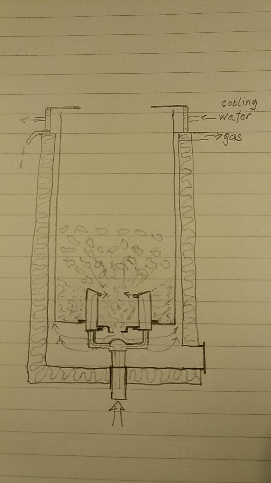

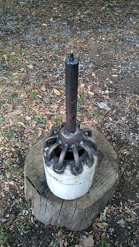

another sketch

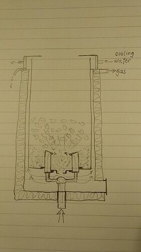

Tone, I think some explainations are needed.
Charcoal - wood? Stationary - mobile? Do nozzles sit in a ring - or are those kind of a double flutes?
What will this gasifier feed?

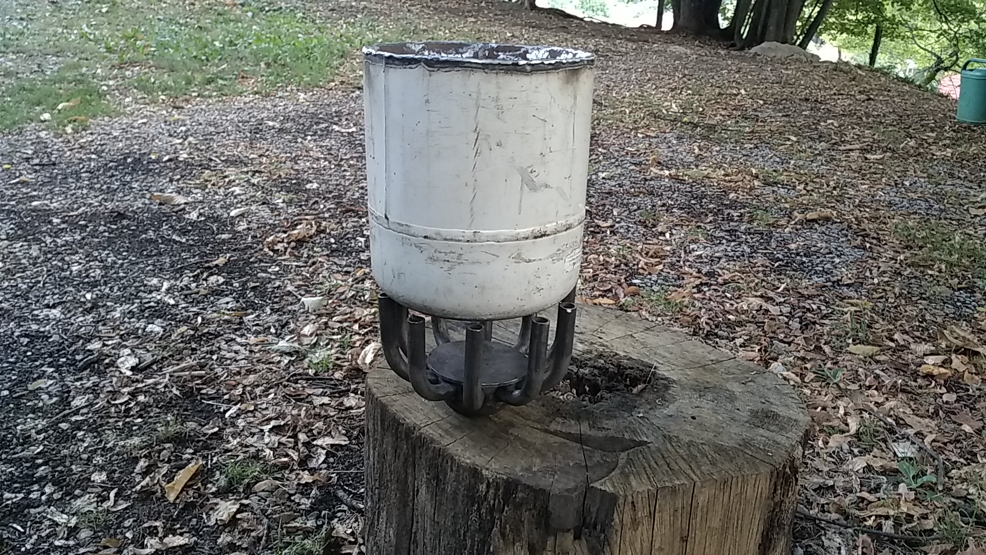

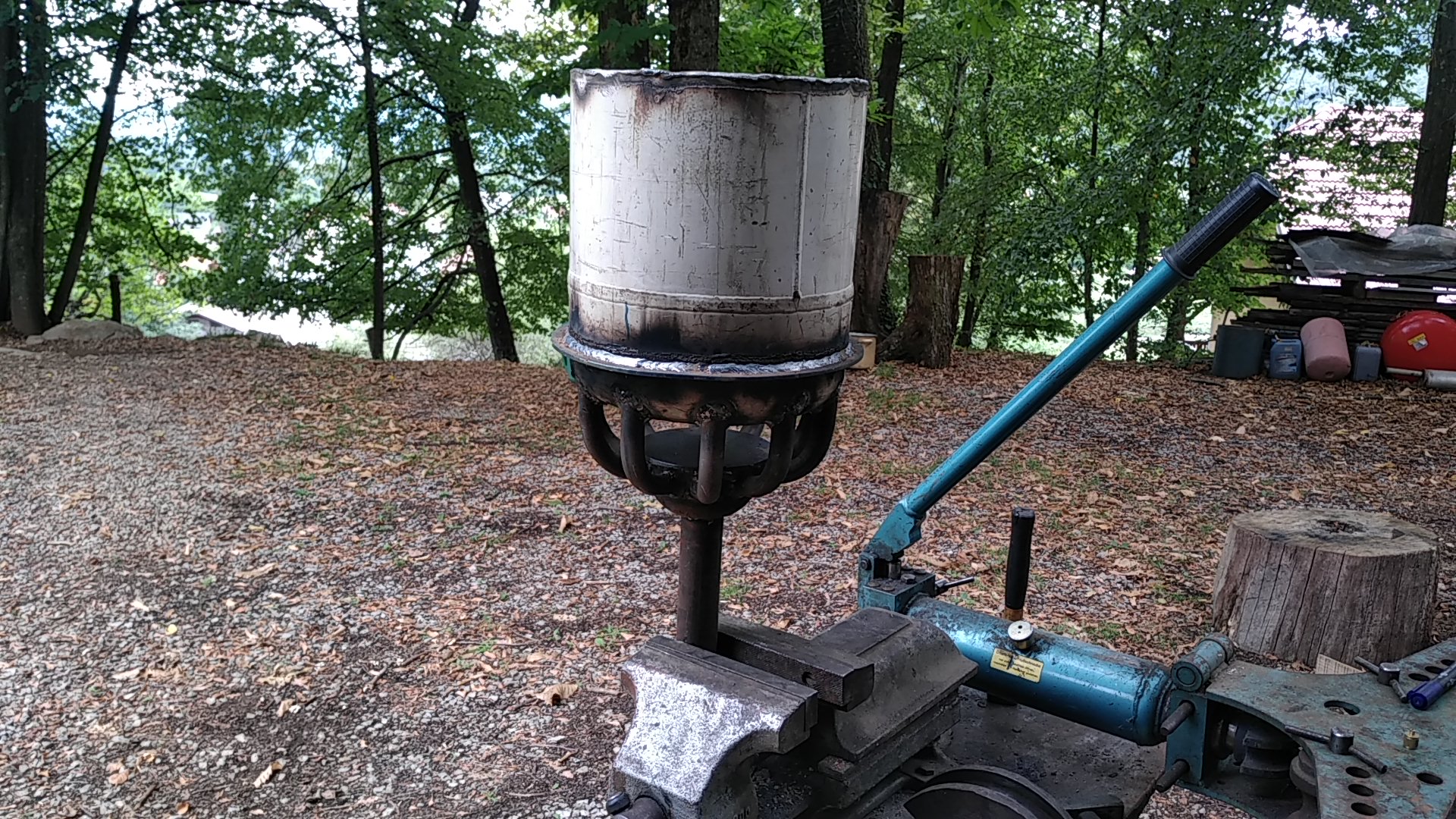

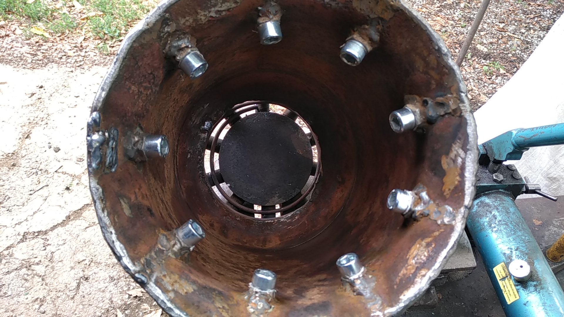

Hi Jan, … this is supposed to once be a gas generator on wood for cogeneration, air entry will be down through a hollow air-cooled grille, and rise up through a double-walled ring that will form a reduction zone. There will be nozzles at the top, and a removable limit at the bottom, and everything should be disassembled, and it should be pushed through the upper loading door.

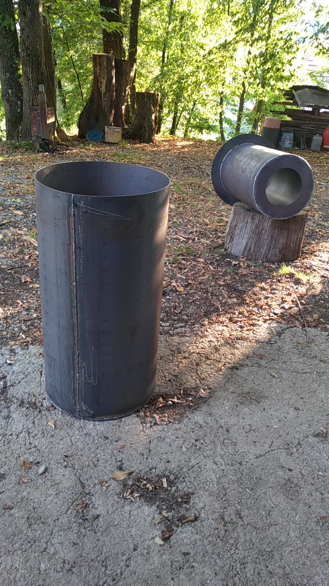

the weather is colder and I have time for such work, so the fireplace is slowly forming

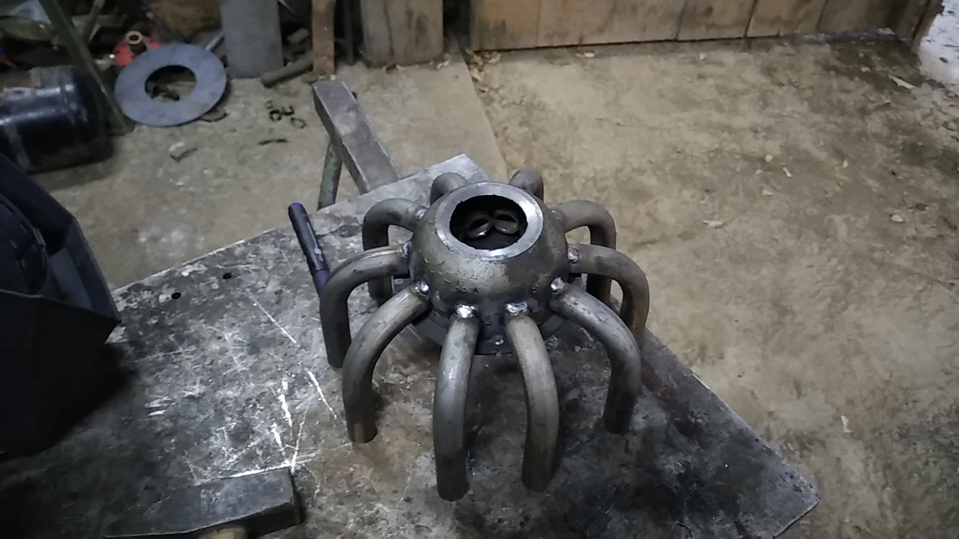

octopus welded to the hearth and passed a pressure test at 5 bar, a ring for the bed, … maybe it reminds me of a torch for the Statue of Liberty

That is one interesting design. Just when you thought everything has been tested, Tone start working on this design.
Thanks for sharing.

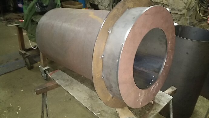

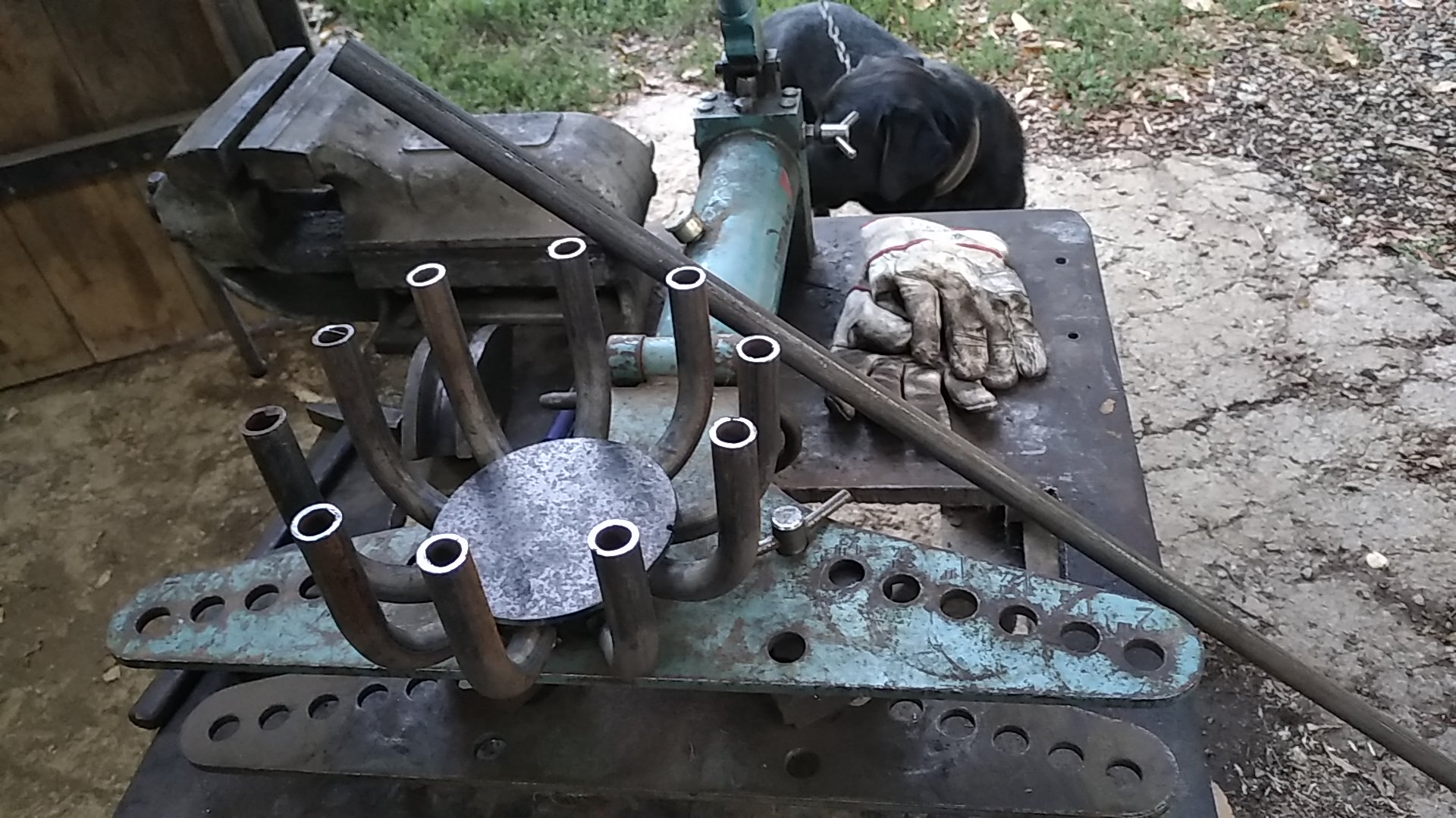

another spiral to thicken the lattice
That is looking awesome
Interesting design for sure.

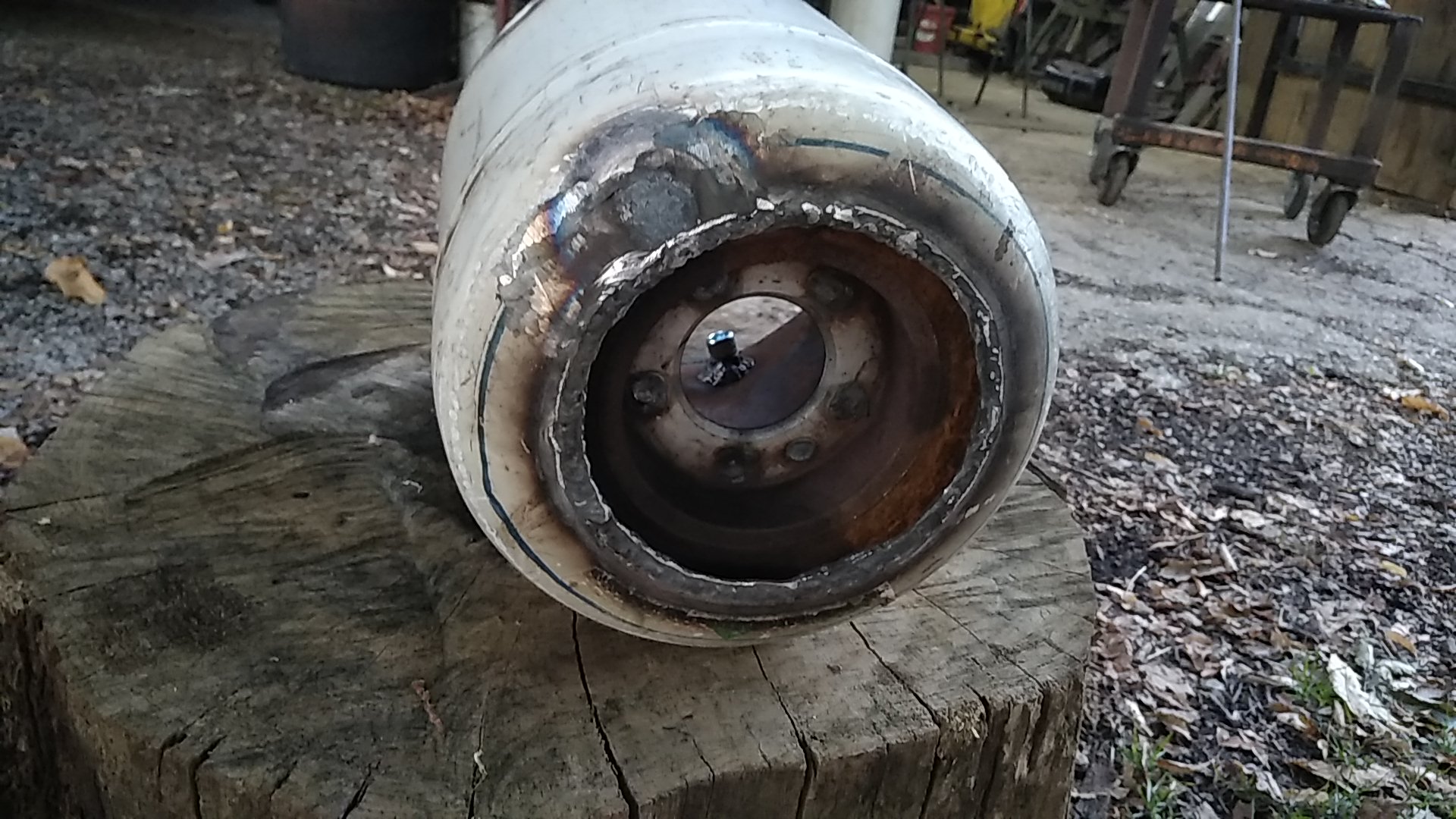

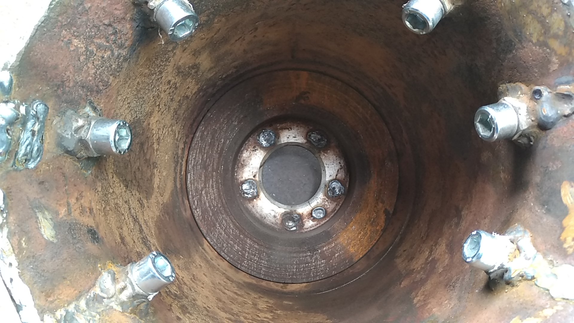

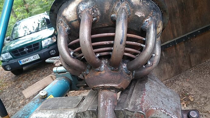

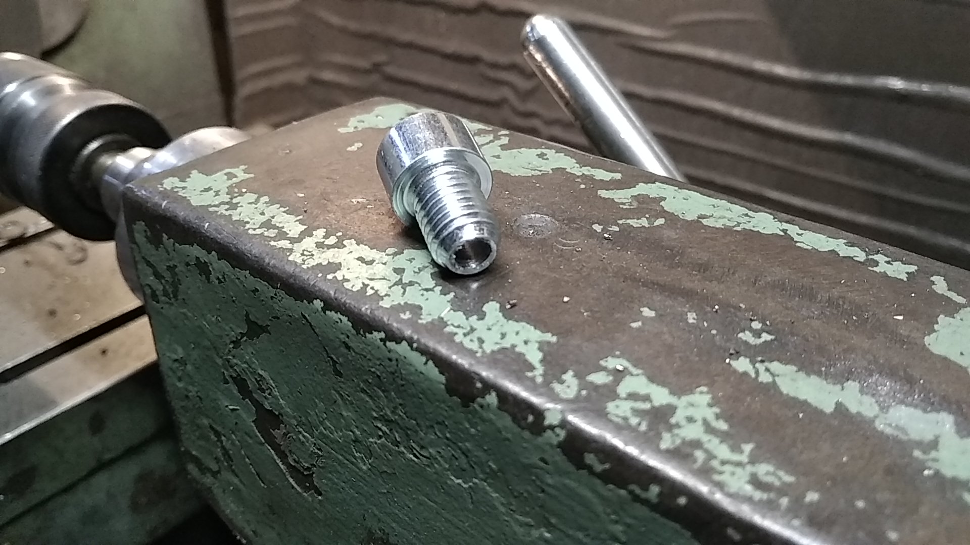

welding sleeve with seal for passage through the bottom
Haha, that was the thing I was wondering about! Like your lpg carburettor, why take the easy road. It will work, for sure.
hello Joep, thanks for the encouraging words, I hope you are right about the operation, otherwise there will be laughter. I am trying to build a system with the most concentrated heat in the heart and minimal heat loss, right at the exit there should be a water-cooled cyclone with a filter in the middle … all the waste heat should be for heating the house
