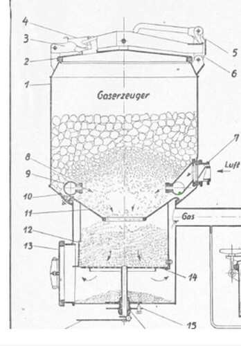

Kristijan, how far are your nozzles above your restriction? I know they are movable so did you move them already or was your first guess working good so you left it as is? Or maybe it is not important?
Did you notice on my drawing that I am going to experiment with nozzle slits instead of flute holes. 3mm by 177mm would give the same opening area as 3 - 8mm holes in each nozzle. If it does not work I can just screw in flute nozzles, in fact I might just try both.
Don, its exactly one brick high
l guess around 5"?
They are still positioned exactly like l showed in the first lightup video. Even the duct tape on the air supply pipe in the hopper holds on
and it seems to be a bullseye. I might play with nozzle angle thugh…
Its probably wery important. Not for pure charcoal or slightly dampened like you intend to use, but if we go higher and maybee even in to mix fuel waters, it shuld be just right and tuned for the engine. We dont want steam bypass the glowzone or god forbid, tar!
I did notice the slits and l am wery keen to see your resaults!
Just curiose, would it be beneficial to have the flutes at different angles in any way? One upward one down to enlarge the burn zone for more water content?
Kristijan I really like the design of your new gasifier. it seems to be an excellent compromise between an updraft and a downdraft
you have probably thought about how to adjust the angle of the nozzles.
how do you think to make this adjustment? ![]()
Depending on: the temperature of the outgoing gas?
: the size of the coal above the grate?
Thierry, video showing just how l adjust it is uploasing!

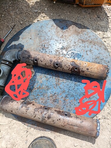

I have a confession to make guys. These few days were frustrating! I thod l failed. I culd not get this stubborn old Czech (Škoda) to run on woodgas… Tryed everything. Timing adjustment prooved rather useless. Gas was flaring but still wet. Emptyed the sistem a few times to make sure there isnt any water in it boiling off, tryed different flute angles… Everything. If the engine did run it just barely made enaugh power to run it self. Power was measurable in Watts rather thain KiloWatts… Frustrating. And the worse was it did run EXCELENT for the wery first time, and never again later. So l knew l do something wrong but what???
So, l took a closer look and l seemed to find the fault!
Any Double flute downdraft gasifier making guys, listen up! This seems to be the difference between the gasifier performing excelent and not performing at all! SEAL THE FLUTES!!!
This was the problem!
Steam and weak gas bypassed the glowzone here. Over time lm sure the acumulated ash and fines will seal it for you but l speed things up and mixed a bach of my favourite refractory material, ash with sodium silicate, and plastered the flutes in real well. 3 minutes of work and in a nother 5min the engine was runing and runing good!
