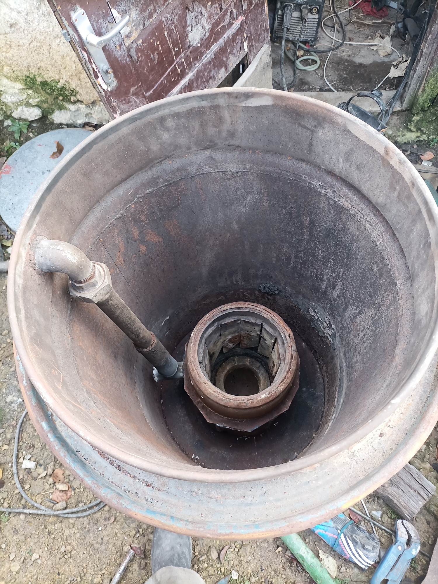

Last time, l tryed out the double flute and it worked fine with moistened charcoal. Hadnt tryed wood mixed in thugh. But since moist char in a downdraft is preetymuch the most foulproof fuel for a gasifier, l had a good baseline. On flat, l got 60-70kmh out of the old 1.3l 400k+km engine. Its worn out, has no power even on petrol. But thats not the point!

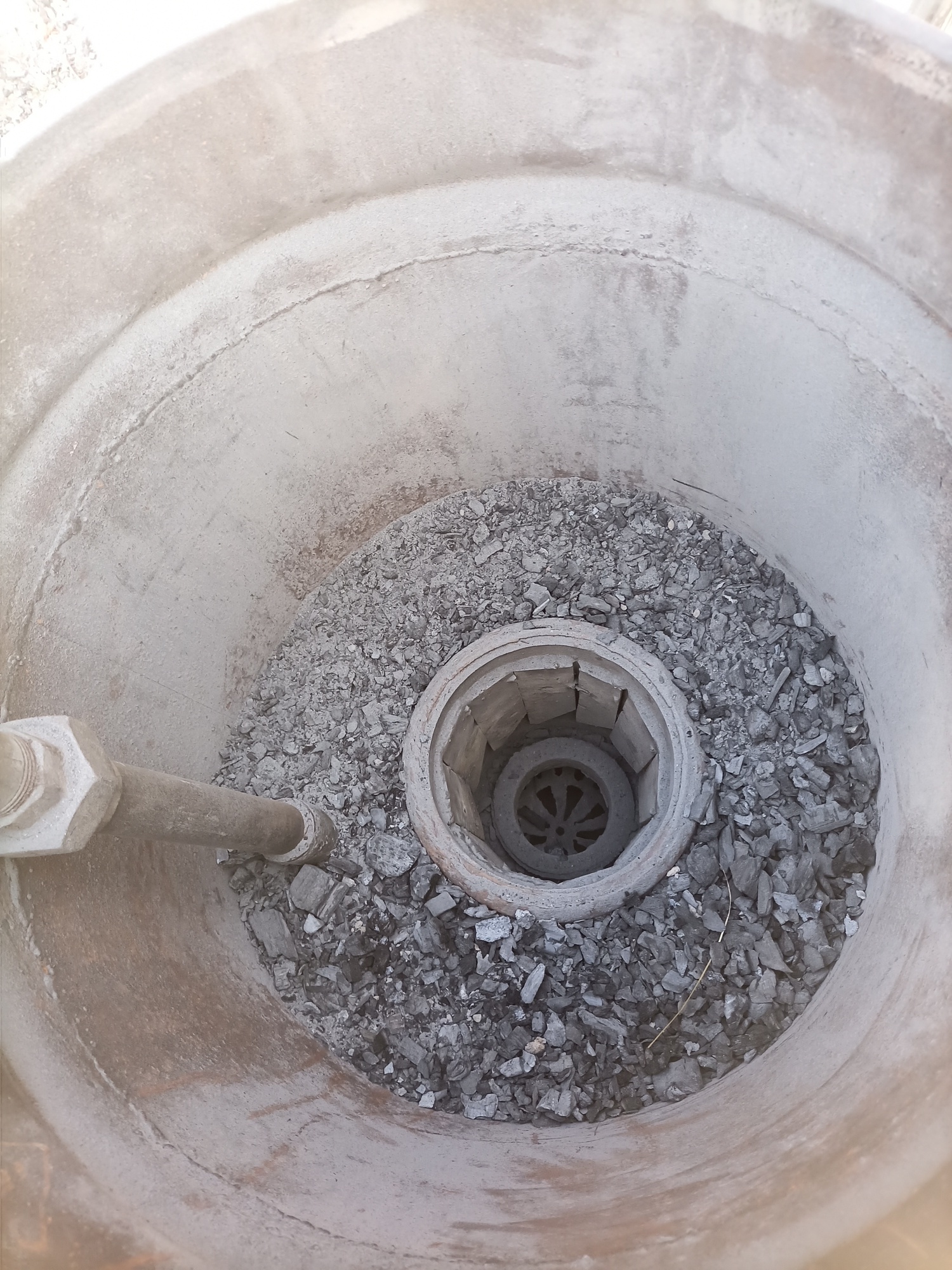

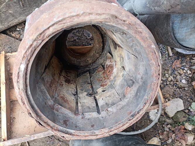

To fully test the double flute idea, l wanted to test it compared to something prooven. So, l fited in a old 8" WK hearth l had laying around from my Mercedes. Its small but boy is it hevy! 9mm thick firetube with 6mm sacrificial acid proof plates inside, and finns out of 3mm steel. Its tiny yet it weighs about 50 pounds…
After welding on a air supply jacket, wich is what l belive is the most ugly metal job l ever did, l quickly installed it in and burry it in ash to hide the uglynes ![]()

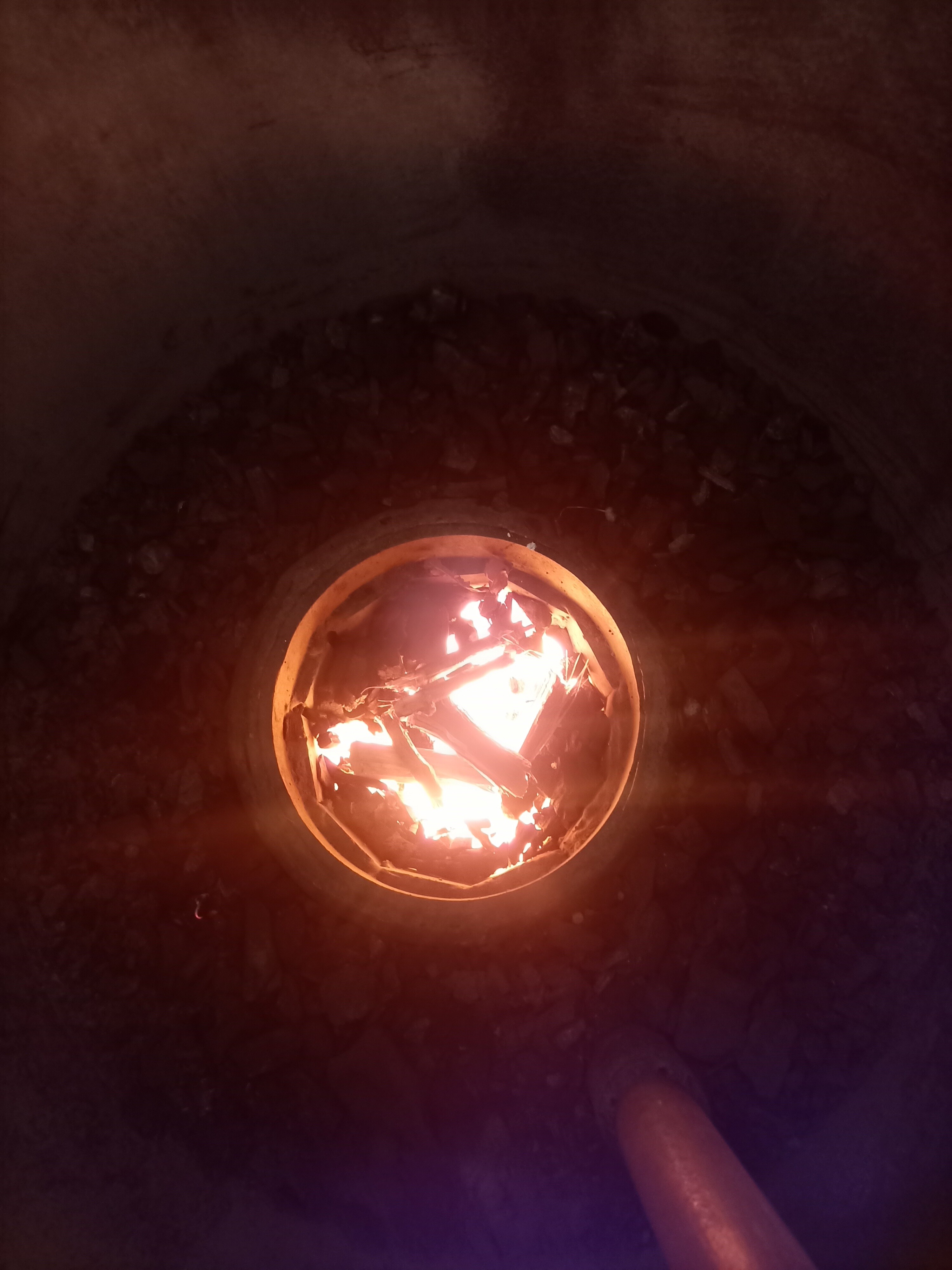

First fire.
Now l wuld lye if l wuld say all went smooth. I am used to filling and lighting a new gasifier and having burnable gas in less thain a minute. All this made was steam and unburnable gas, engine wuldnt even think of runing. A afternoon passed with me trying to figure whats wrong with a gasifier that ran a engine twice the size of this one in the past but doesent want to work now! The saying of seasoned wood gasers is “dont blame the gasifier”. It usualy leaks or operator error. Here, leaks are preety much impossible. Operator error too, since it ran on bulletproof fuel. Had to be the gasifier and it was! Turned out it was the grate. It was too low and it slipped too much char, emptying the glowzone and alowing fresh wet char to steam off in the hot WK hearth.
Fixed that, then it worked as it shuld!
So, resaults. Compared to the double flute, there is no difference in power. Still 60-70kmh flat. However the hevy hearth and big stored gas volume provide excelent flywheel effect and l can say l never run such a smooth sistem. No hasitation. I cranked up after a hour of standing shut and l had enaugh gas to rev it up. Idles indefinitly.
How long it realisticly takes to warm up to this point is what is yet to be discovered thugh. I got a feeling the flutes are at an advantige here. Not to mention weight and ease of fabrication!
Anyways, l now know the gas part is good. Now its time to atend the engine! 60-70kmh is not good enaugh.

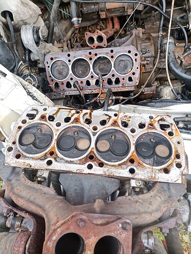

Tone kicked me in the ass today, thank God he did, otherwise l wuld keep procastinating this engine job forever. I dont know what l feared, its a few minute job!

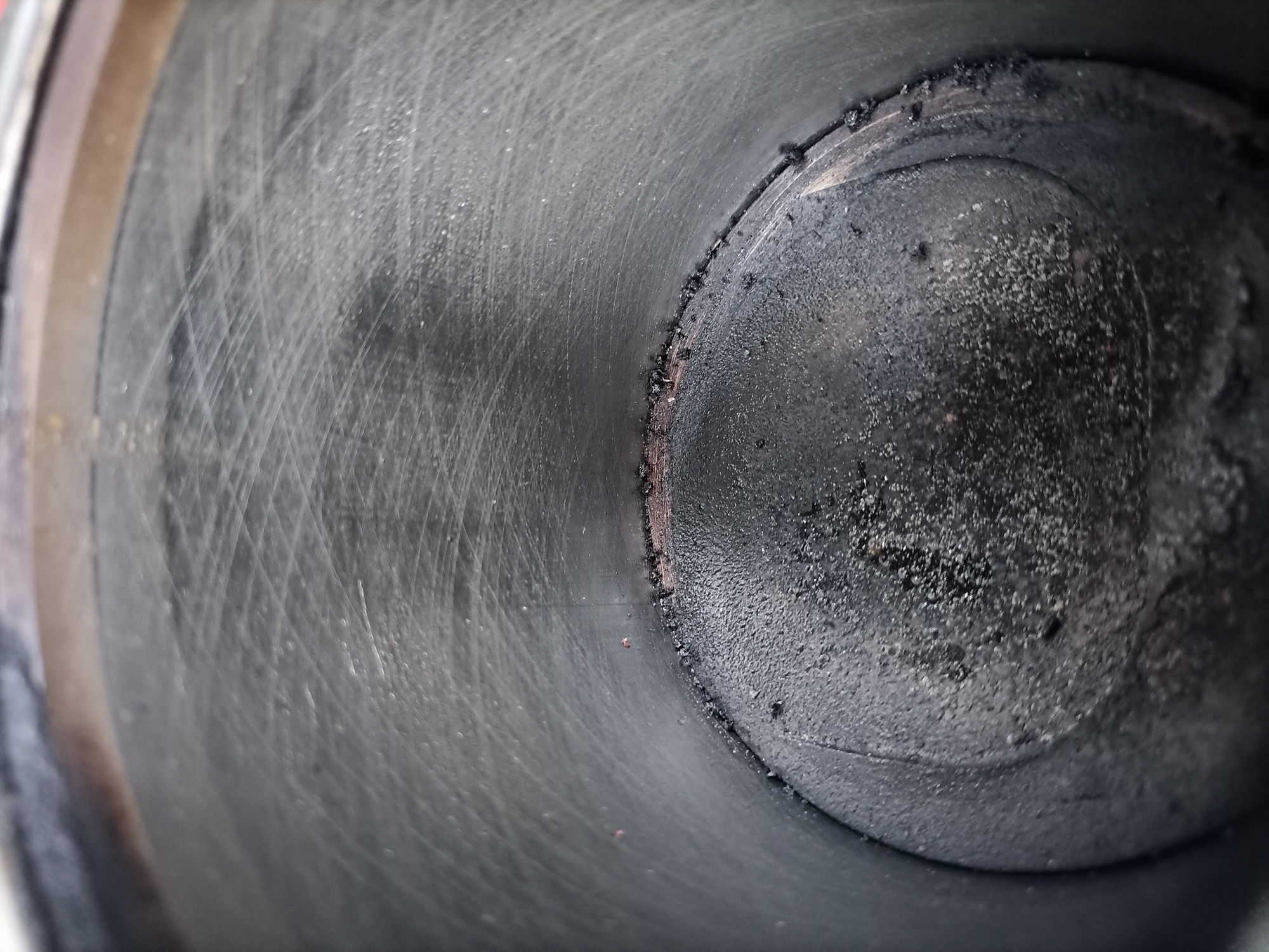

Guys, what do you say about the cylinders? Not bad for the age and mileage huh? Im curious of the new engine thugh, it has near half a milionkm on it…

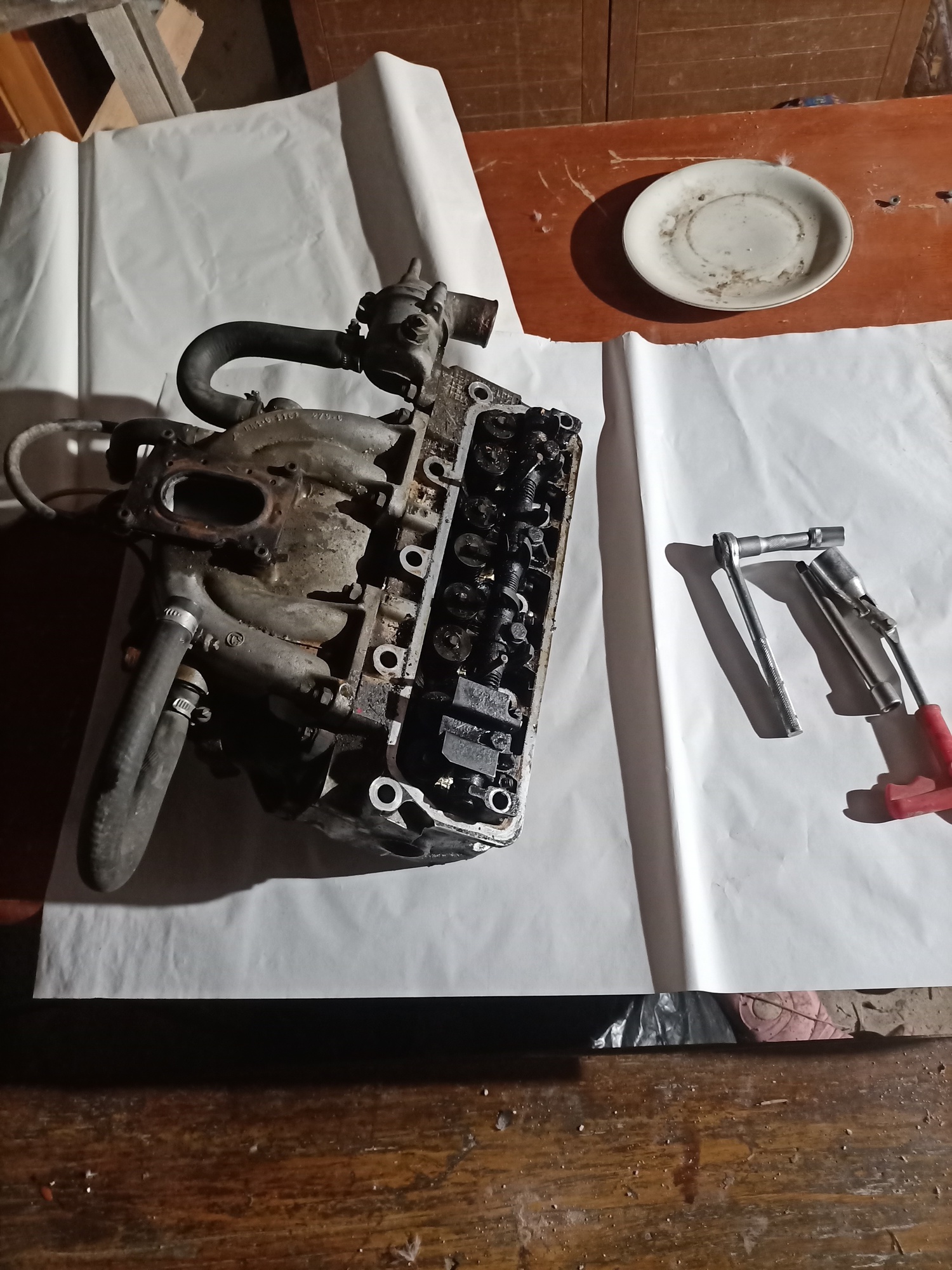

This is now the operating table!
Doing a valve job and compression increase
Ahhh. That is because someone has been in this engine before you Kristijan.
Look at the top of the cylinder in picture #2. There is a ~10mm edge line showing where the piston rings have never traveled. We call this a ridge.
The ball honed lines cross from below in the rings travel area across into the ridge line.
No matter on this. Someone previous has had the piston and connecting rods out of this engine.
What matters is if the piston rings are carboned seized in their piston grooves.
What matters is if the piston rings still spring out exerting minimal wall pressure.
The majority of the rings sealing is done by gas pressure getting to the back sides of the rings pushing them out into contact with the cylinders walls.
Since you intend to increase in-cylinder pressures you really, really need to oil pan drop and pop out the pistons and connecting rods and caustically clean in place the piston heads and rings. Or remove the rings and manually clean the piston ring grooves.
IF new replacement rings are available good time to install a new set, just-in-case. Every little bit of wear you can restore will help.
No need to re-hone these cylinders.

Hmm, the upper compression and the lower imitation are chrome-plated, these rings hardly wear out, only the other is plain
Mr Steve, l suspect this also. But l can not see how the edge line proofs it? What am l missing?
This engine (on the pictures) ran great. Excelent low rpm torque. Unfortunaly the truck is wrecked…
I since bought a new, younger one with fuel injection and catalyst, same motor rated for less hp. Some 300k miles. This one drives completely different now l dont know if its worn out or its just the emission controll… Anyways, both were and are dayly drivers so l dont think stuck piston rings are a problem?
