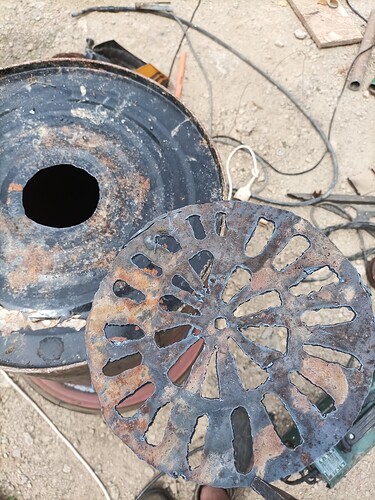

Got a question now.
This is the grate. Its gona be on chains, WK style. I never made one of these. How far from the hearth bottom shuld it hang and shild l turn it concave side up or down?
I would say concave down like a shallow cup about 1 inch down.
I sure hope you make the Double Flute work! I think it needed an experienced set of eyes to get the bugs out.
I would say what Don said.
Just enough to hold a thin layer of ash for protection and a 1" by-pass gap.
Too late but, I made cuts with the disc and punched the holes to get a little “angel iron ash holding effect”.
Oh l see… Well the gasifier is easy to take apart, if problems occur its easy to fix.
