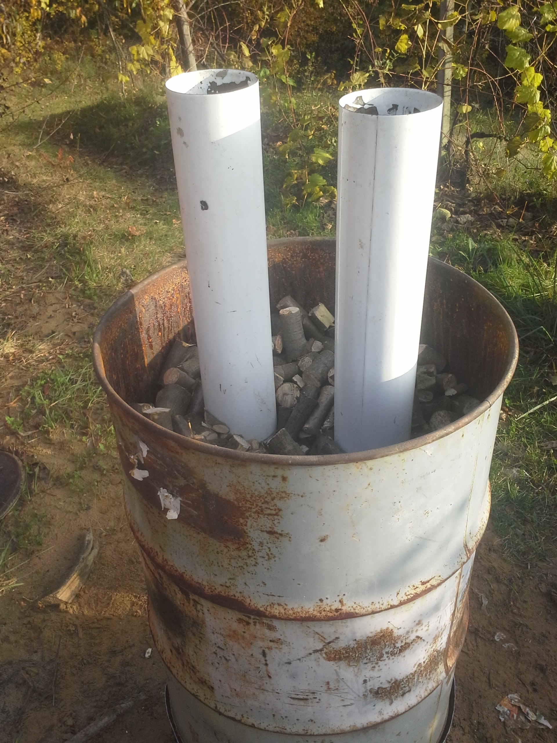

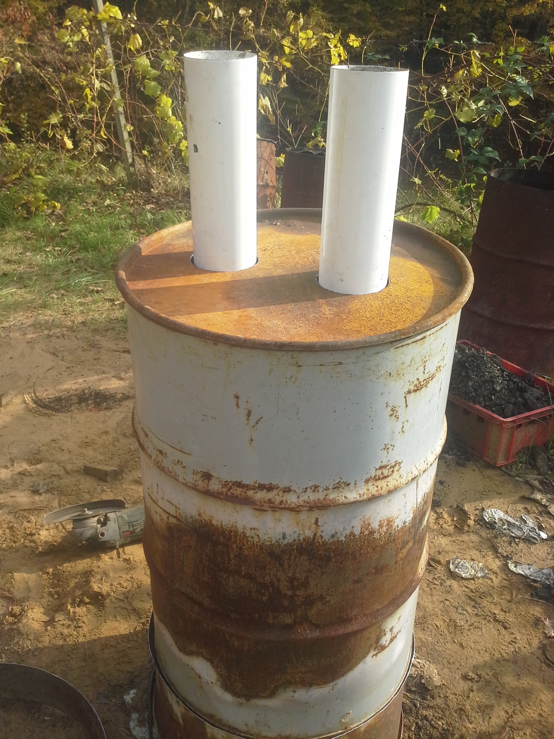

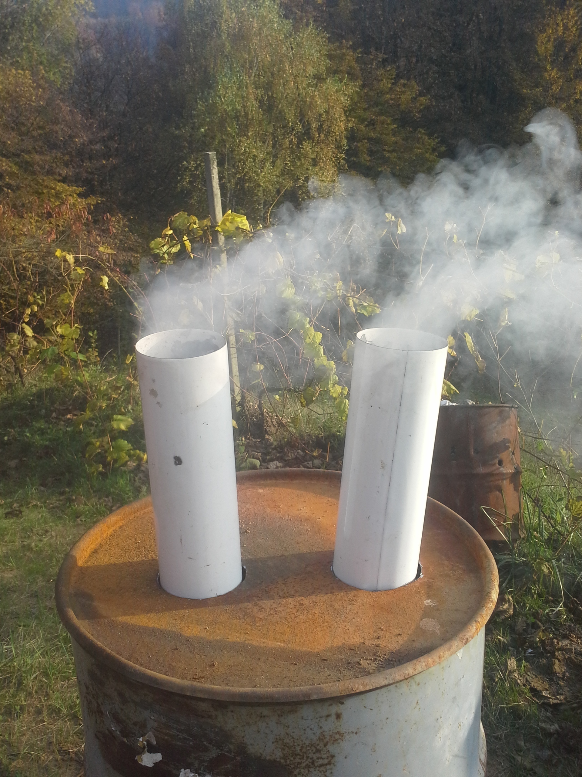

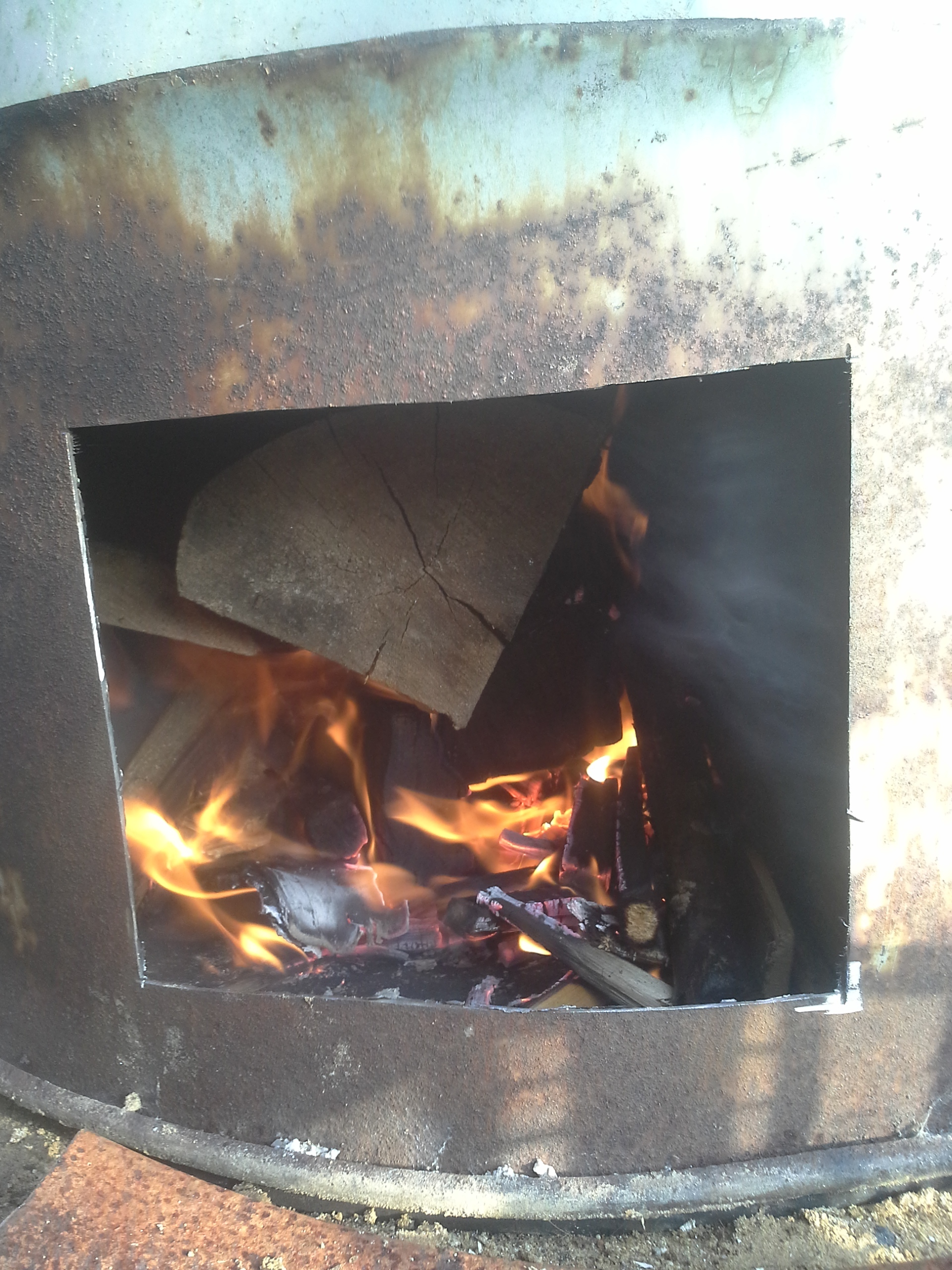

l’ll see what the wood chunks look like when they cool down tomorow. The goal of this aparatus is to be able to make green wood chunks as dry as possible as fast as possible, the airdrying seems to hit a stop at this cold, wet months so this is my idea to fight that. l can dry enough wood in here to get me about 350 km (220miles) of driveing. Hope you guys like it!
Kristijan, if you would put a little insulation around the barrow it would make it more efficient holding heat inside to dry the wood . Good job I want to build one for doing my wood if it works. Keep use posted on this one. Thanks
JO, this is the next step. But first l wanted to make sure there is not enough heat on the bottom to catch the wood on fire (like Michael sayd). I am planing to make a mantel around the kiln to catch the heat radiated from the outer wall of the heater.

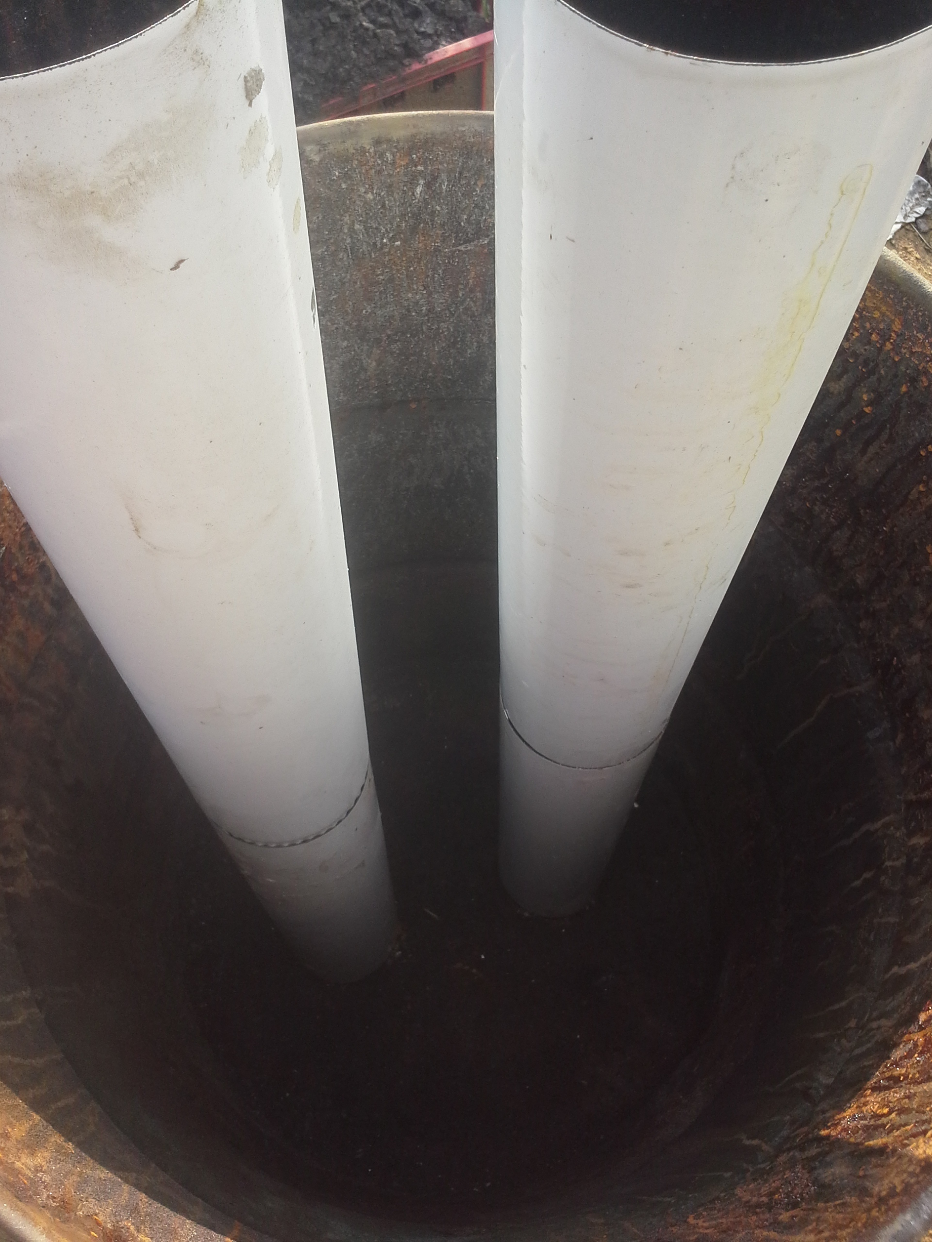

I was allso thinking to make the chimenys suck the steam from the top, adding more suvzion to the drying barrel. The goal here is to dry wood below 10% moisture to have less problems with the gasifier when the real cold presses on our land, and allso to give a hatchet s litle brake
With steam pipes slightly bigger dia and hight over barrel top, surrounding the smoke pipes, you would get air draft big time. Both heat and ejector effect. A layer of gravel or concrete in the bottom of the wood barrel will prevent fire and accumulate the heat to last during night.
JO, l was thinking somewhere in that direction (chimeny effect) but the gravel idea is genious! I have some peaces of firebrick left over from my summer kitchen build, shuld be great for accumulating heat! Thanks!

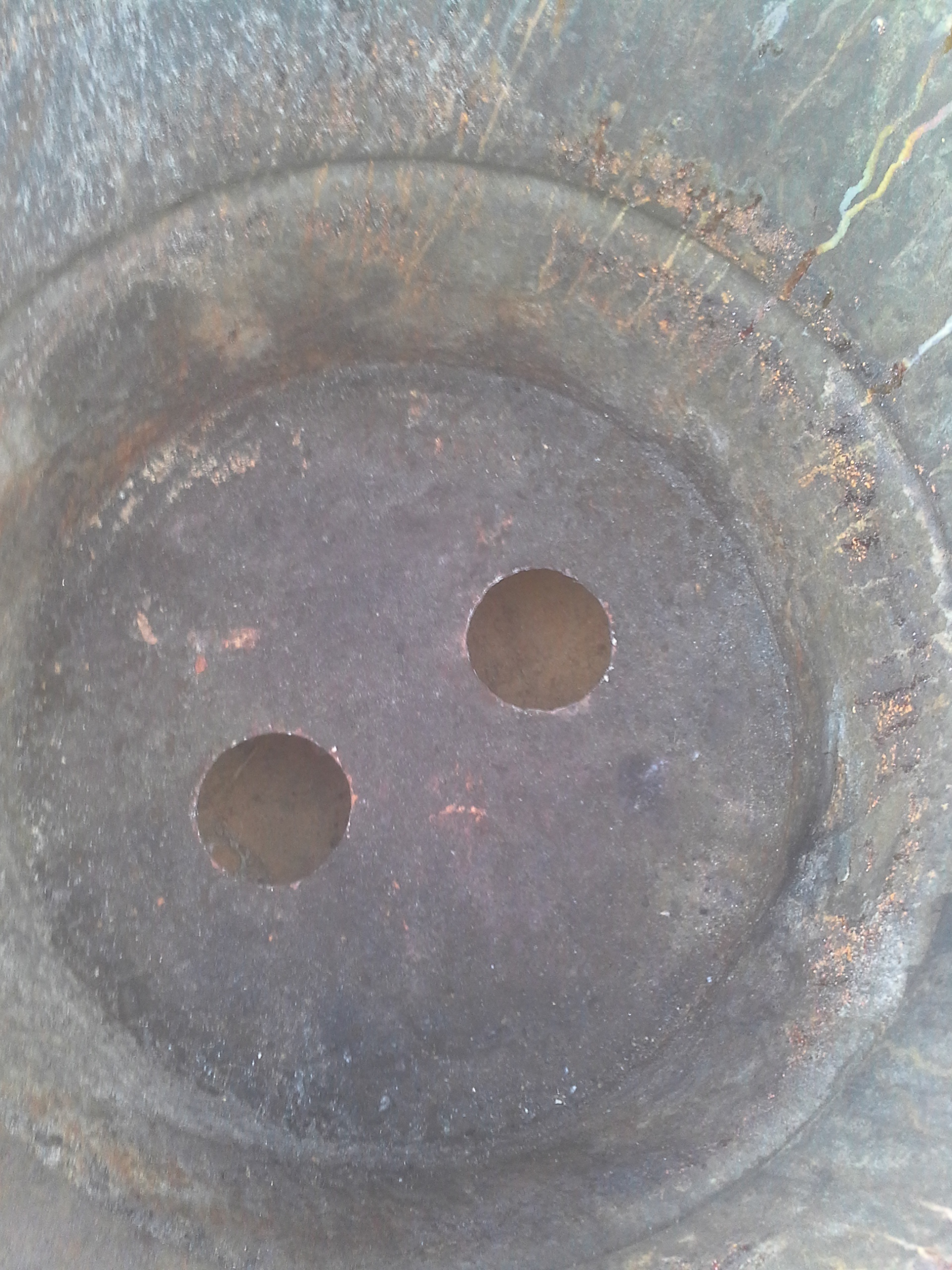

Yes, l have cast about 5" thick layer of plaster on the bottom. I made chanals in it for the air to pass trugh, heating it and then passing trugh the bed of wood.
I still have to insulate the outer shell.

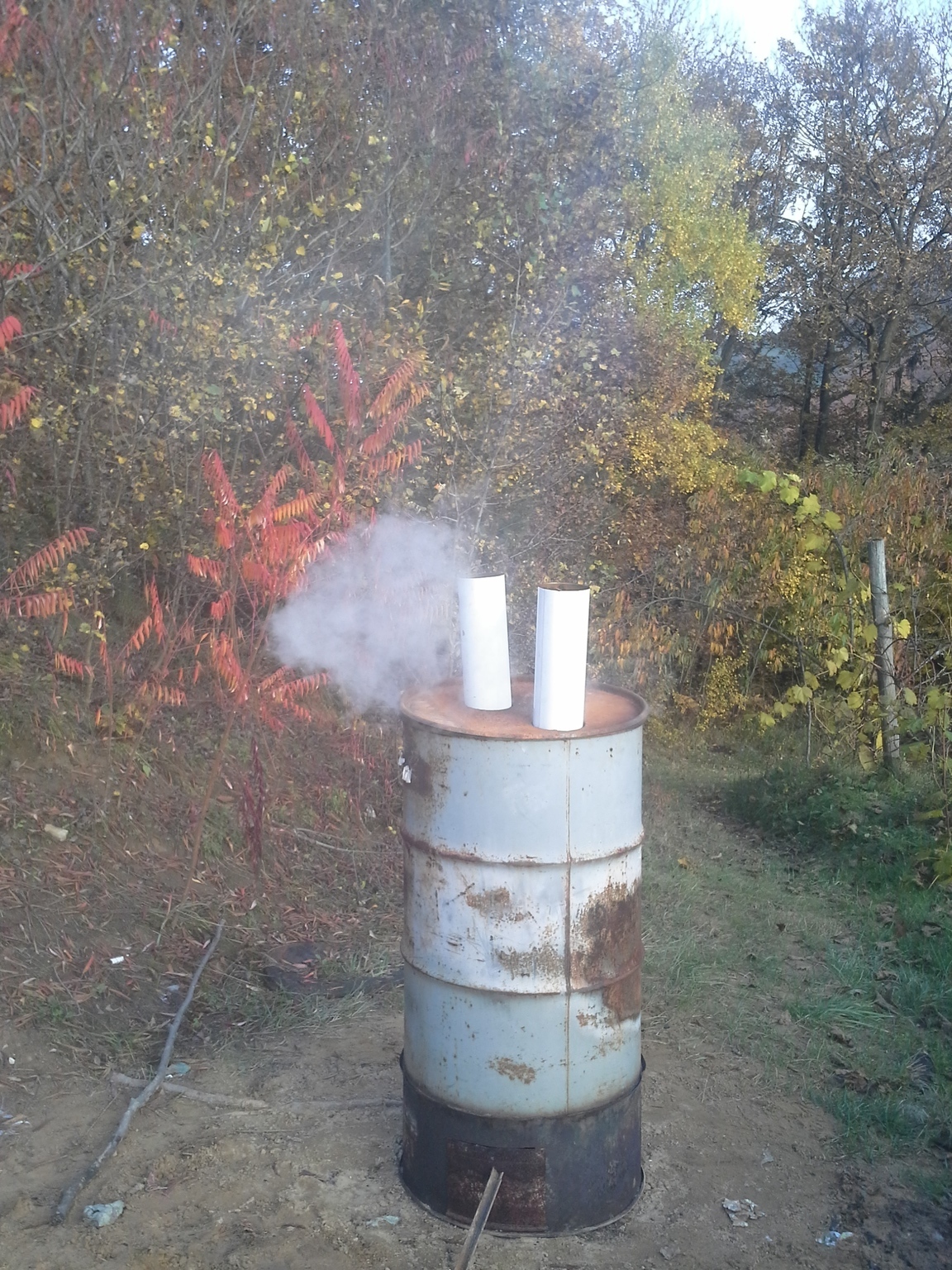

One batch dryed in a day. Its a 55gal drum, so a WAG of about 100 pounds a charge of dry wood. And a few bits of wood to burn underneeth.
JO was right. Ventilation is important. As well as insulation. This sistem lacks a layr or heat insulation on its outer shell.
Its not something l wuld do on a regular basis, but for a fast emergancy suply of wood, it works.
