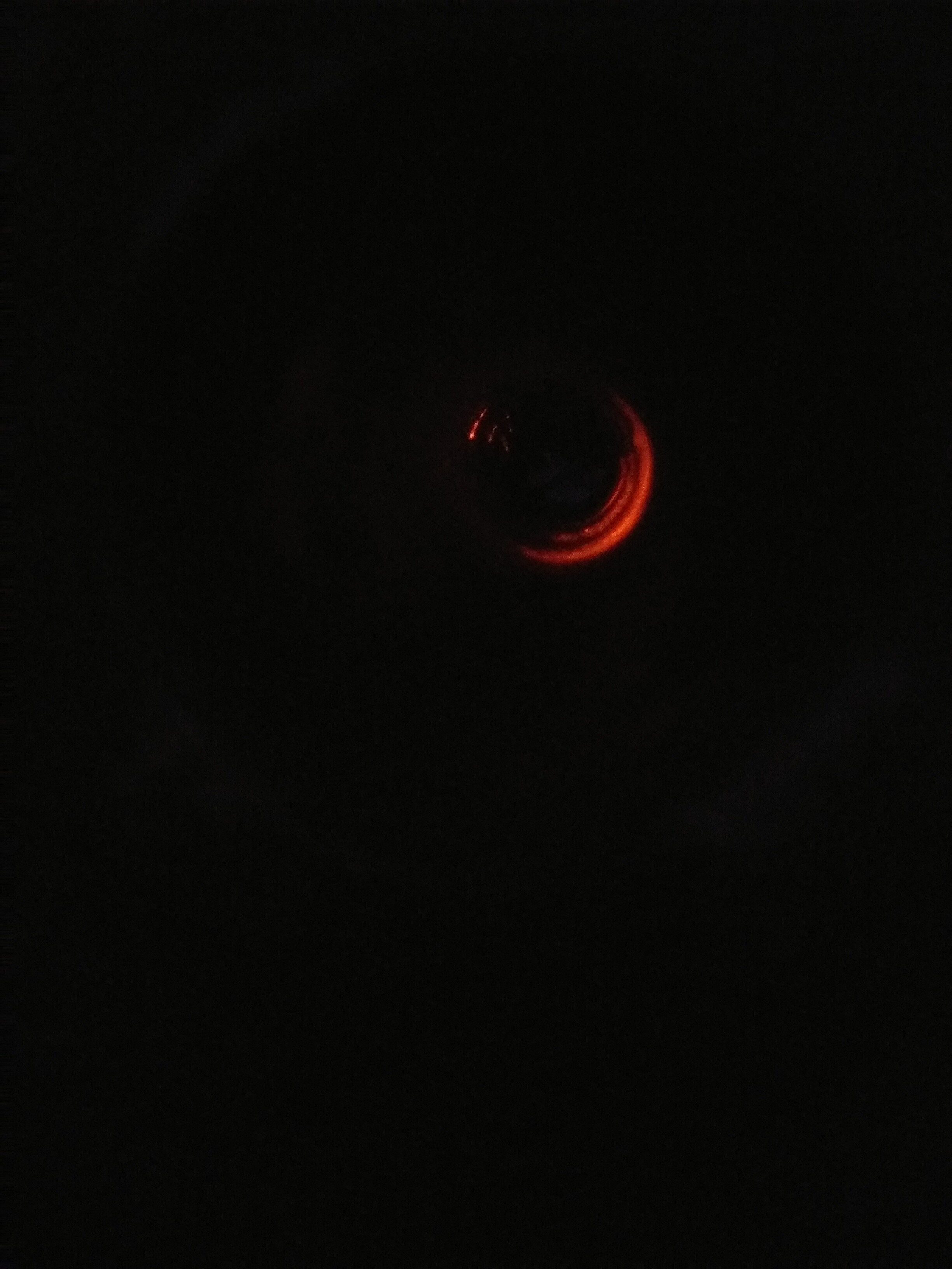

Lid has been getting HOT since I switched to 45 degrees upwards.
Cyclone collected maybe 1/8 of a cup of water in the little over an hour run.

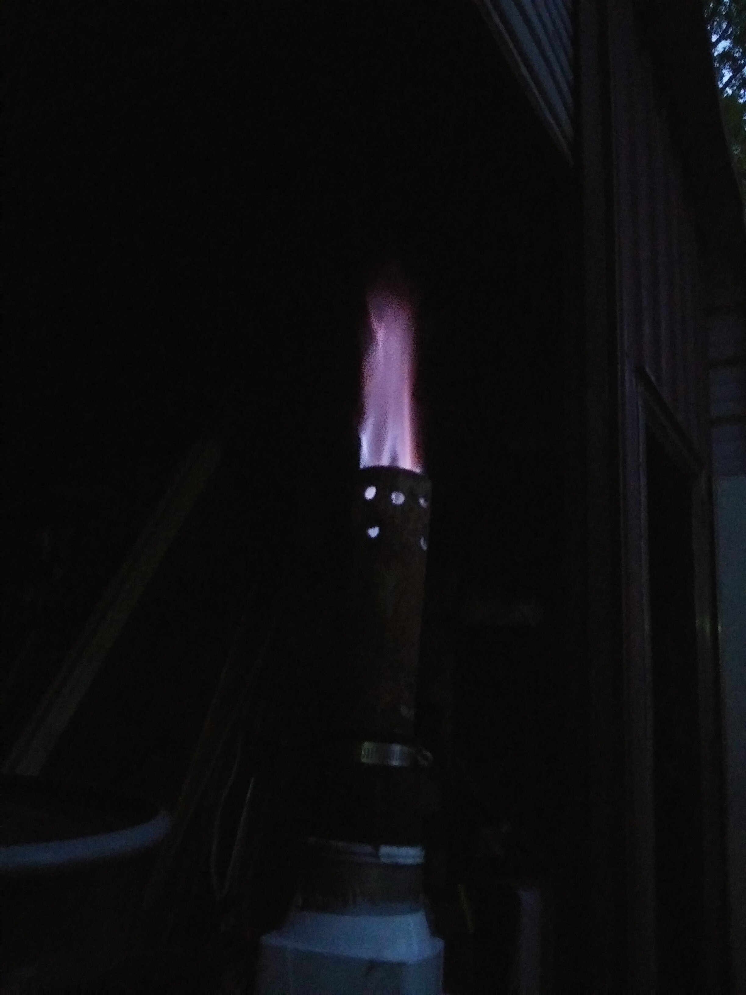

Trying this time with flutes at almost 90 degrees, biased slightly upwards. Flame went from purple to blue much faster.
Feeling less moisture if any. I’m hoping the residual moisture in the cyclone isn’t throwing that off. I put a piece of open cell foam after the fan in the flaring tube like last time to see if it collects any moisture.
The spots that appear to be glowing are just reflection from the flute holes. Hottest the nozzles are getting is about 450°F
This unit really likes to be shaken every 10 minutes or so or the flare dies.
Still getting some moisture at the base of the flare tube. I think this combined with the small volume of the hopper this won’t be ideal for my Mazda project. A barrel probably isn’t the best form factor for this design or at least not how I’ve made it.
