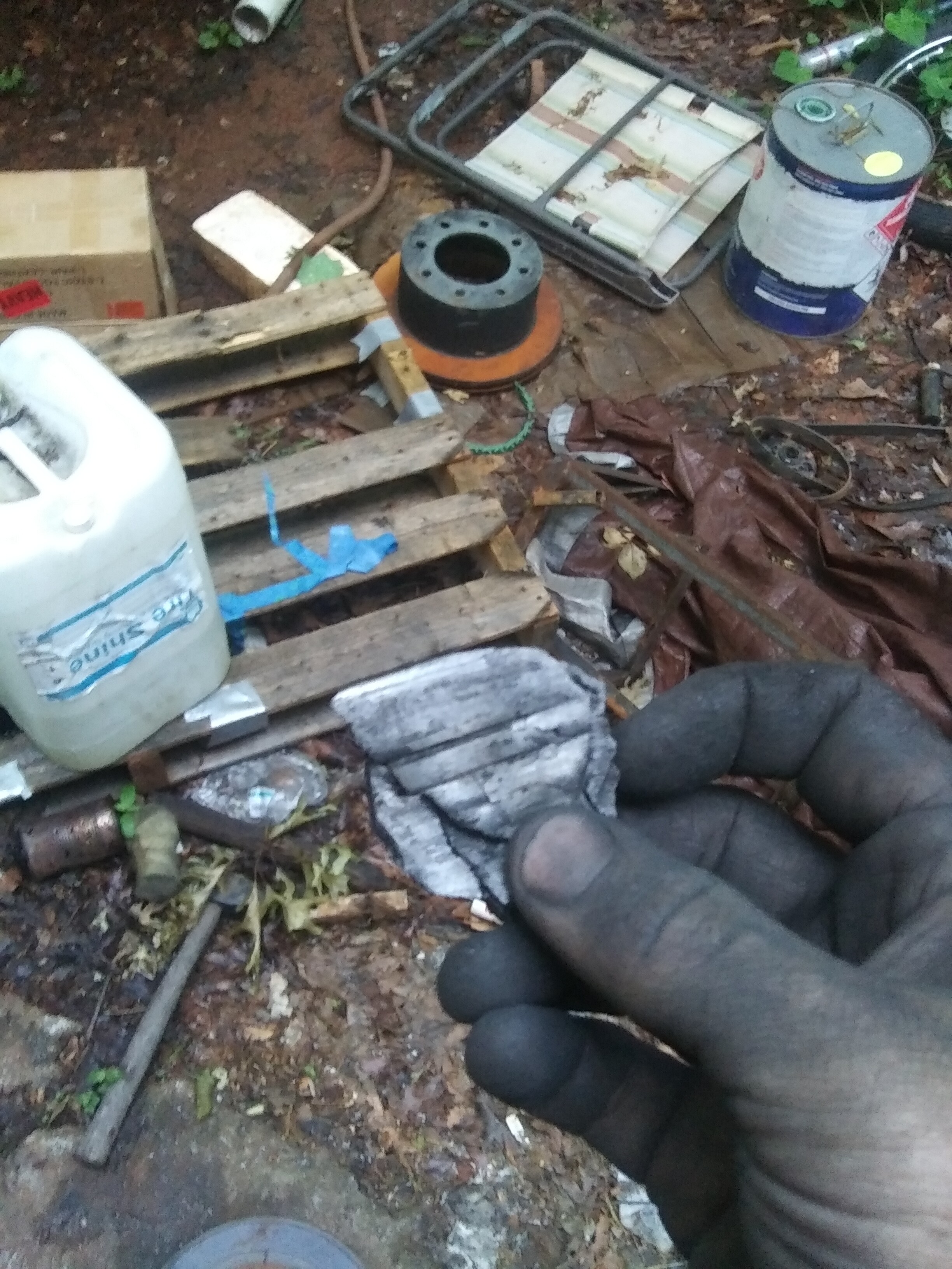

While taking char out of my double flute tester to remove the choke plate I noticed the deeper I went the more I saw this silvery colored charcoal.
I Cody, when you drop it does it make a glass like sound?
More of a glass sound than my other char does. About half of my char sounds like good breaking glass and the rest sound like dull pottery. I suspect the dull sounding char is from using deadfall wood that might be slightly punky.
