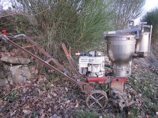

hello woodgas friends, here our new baby, a chargas tiller for our vegetable garden…
yesterday the first test, 3 hours…
very successfull…finally without stinky gasoline exhaust in the bio-garden, very pleasant!
all built with old scrap, the motor is a briggs from `75 with 5 hp …
the gasifier is the same from the grain harvest mower - “one for two”…
the filter could be a bit bigger, the mesh is clogged after one hour and needs to be cleaned…but we have not built bigger because of the limited space- it should not becomes to high, because of operating under trees…maybee i will give the mesh a star -shaped design for more surface…
the red valve for start air mixing is opened only about 5 mm for good starting!
best wishes giorgio and son

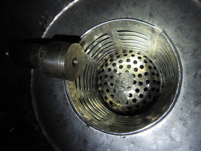

hello michael, because of the cuts in the reduction area is no shaking necessary, i think.
but it has a shaker inside for cleaning after work…

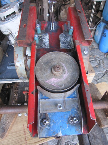

here the system for belt tension (with the big lever behind the motor) with this i can stop the tiller -knives.
with the lever i can move the complete motor forward, so the belt works not more and the cutters stops.
it is made in a way that the belt, when is not under tension, not touches the motor belt-wheel… otherwise the belt lives not so long..
this system was needed because the tiller has no separate gear for “off” and “on”.
the gasifier from inside… the reduction basket works well- not plugs

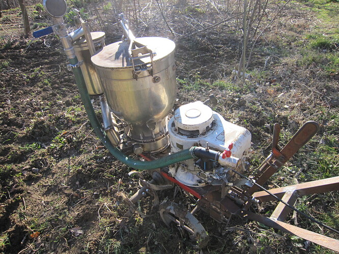

some work with the tiller in the garden…with additional foam filter…
foam filter inside with security experimental mesh with 900 holes on square-centimeter…
dust trap…
disc dust trap after 5 hours of work without disturbs…
in beginning we have problems with starting because of too much moisture in the coal, the spark plug gets invisible traces of umidity on and makes no spark…solution: ventilating for 10 minutes with open hopper lid, so some umidity goes away…attention: poison danger from gas!
