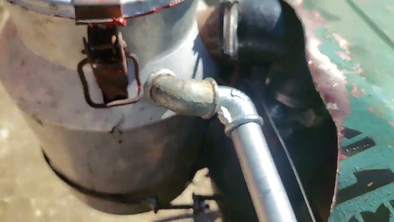

So a added lawn mower style throttle cable, controlling manually a car throttle body bolted attop the engine air intake, very nice and simple. Left side container would be filter? With itegrated air mixer which extends to the ball valve near the steering wheel. Mechanical injection pump cable is removed from its bracket, allowing i think only diesel to idle and all throttle is done with the woodgas. Electric start a very handy feature. Handle to the right of steering wheel…factory fuel control? Right side co tainer down draft charcoal, not sure about that bottom bolt on plate though cant put my finger on what that is or why the one missing bolt, possible gasifier air intake? Sweet hidden and protected small radiator in the front crossing over. Those are my guesses to the teaser video
Thank you Marcus. You saved me a lot of typing. Seems we’re pretty much on the same page.
So, things boil down to a couple questions.
- What does the right-hand-factory-fuel-control-lever do, now that the added tb controls wg?
- Why didn’t the air-mix affect the rpm?
- The gasifier itself. Is the bottom bracket some kind of air-inlet-non-return-valve?
Marcus has preety much hit the nail on the head. Im actualy impressed ![]()
The startup procedure is, as l sayd, "special ![]()
So this engine has a throtle lever with two cables. One dictates the governor, wich dictates the fuel injected. Second cable gets engaged when you put the lever to zero and it acts on a litle cock l showed on the video. This shuts off fuel to kill the engine.
So. In order to run on woodgas l set the throtle on max. Then, with an added screw on the shutoff cock, l adjust the pump to lower the rpm to idle.
Now, the engine has the command to go full rpm, but it only gets enaugh diesel for idle. The rest of power is supplyed via vood gas, the way Marcus described.
If l wuldnt have nax throtle on the stock sistem, once the desired rpm wuld be reached, the governor wuld stop injecting fuel and no more bum bum…
This shutoff cock also has a second purpose. When pulled out, like l showed in the video, it injects max amount of diesel for cold startup. Convinint in my case, as when l set it to “woodgas mode”, the amount of fuel injected isnt enaugh to start the engine on its own. So l pull it out, start the engine with max diesel, then go back with the factory throtle to reset the cock and the engine runs with minimal fuel no matter the throtle position.
Hope anything makes sence. Video realy is easyer thain writing ![]()
I shuld mention that apart from the screw on the shutoff cock, no change had been done to the engine. So far.

The gasifier looks like this
Downdraft, single nozzle charcoal gasifier.
I had problems in the beggining, not gonna lye. Along with the usual “finding the perfect fuel” learning curve, l had problems where l least expected.
The design is inspired by Tones style nozzle, but because l was limited by width (the sistem can not be wider thain the tractor) l was afraid l ran out of room with the basket style grate. So l forged a nozzle out of the same material l make flutes out of, 2" 10mm thick wall pipe. Forged the tip and welded on some aditional mass at the tip.
First plan was to have 5 4mm nozzles arranged in a 45deg downward angle. Run good, for 10 minutes. After a teardown l found whats going on.
Slag had completely filled the holes!
Drilling them bigger did nothing. 10min of runing and its plugged. Then l drilled a hole right at the tip pointing down, 8mm l belive. Same story. I belive the capilary action and the pulsating nature of the gas flow pushed molten slag in the holes. I gave it one last try and drilled the hole to half inch. Behold! It works. Now the adhesive power of the slag cant fill the hole completely and it permanently stays at about 9mm. The whole tip is coated with a few mm thick film of slag, a kinda cherramic coating and it protects the nozzle. Exess can drip down and will be emptyed manualy after every few work hours.
The gasifier needs finer char it seems, and dust free! Once l tuned that in it works perfectly. I run moist charcoal and also tryed it mixed with chainsaw sawdust. No tar detected.
