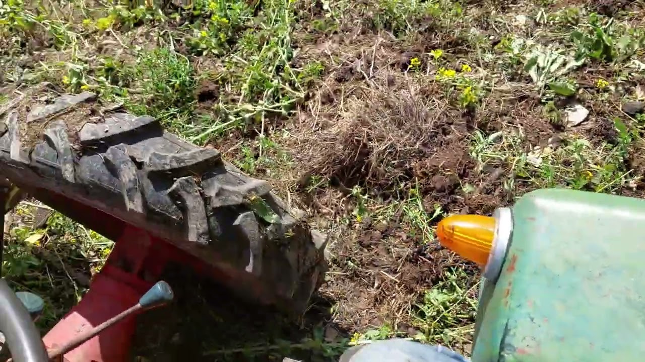

Pulling some “weeds” from the abandoned feald. The heawy machine works quite hard these days…
Got a surprice delivery today. Tone droped by and left this litle marvel for me to test on the tractor. We tested it a bit and so far it feels great.
For something this small it delivers a lot of rich gas and it works wery cool. Signs of a good design!
