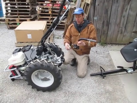

The modern way to do it:
(not necessarily better =)
4x4:
I’ve hooked up our beat-up little stake bed trailer to our BCS tractor, to haul firewood from the neighbor’s place. We got fuel, but no pictures :slightly_smiling_face:
