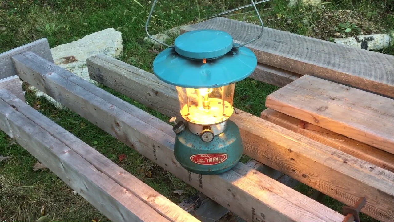

Very subjective question.
Less safe than a pressure lamp maybe
They don’t have a very good valve for the pump, lack the possitive seal you get with a Coleman lantern
This is thermos lantern made in the 60s
I had one of these turn into a fireball because the pump o ring failed and they lack a screw closed pump valve line a Coleman

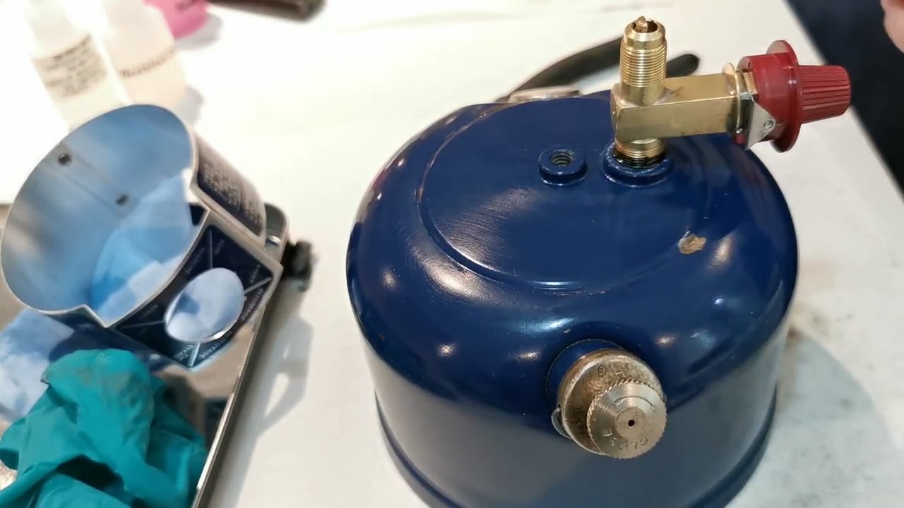

This is the Coleman lantern that pioneered o ring seals all modern lanterns use
Now they have heat shields and two o rings as back
But the original 321 caused a lot of fires
Maybe it’s just better not to use any of these things unless you are completely sure it’s all in good order and check it yourself
