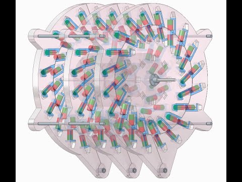

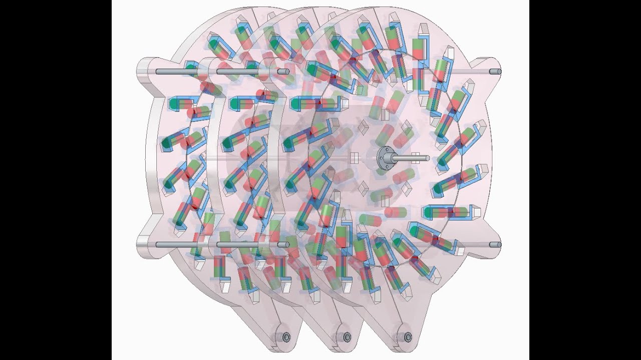

Fake.
The free energy, is all the views they got from the video, and they will end up with enough money to pay their electric bill for life. ![]()
Playing around with magnets in configurations similar to this has been going on since at least the 1970s and probably decades earlier.
The new computer programs can do all the design work for you for magnetic fields.
This is video that goes through and explains a lot of the basics.
The actual -neater- fakes I saw were some russian(?) ones where they had ac coil under the table, and a coil to wirelessly pick up the power, similar to a wireless cellphone or car charger. That might be the case in this video as well as there is a black cord coming out of the wall, and you can’t really see where it ends.
