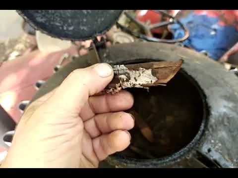

Today I drove into the forest to see the effects of the weather, what it left behind, I have work to do again, some oaks are broken, a lot of fuel is lying on the ground, my Fergie will not rest.
Another activity report:
  • 1.5 liters of liquid is drained from the condensation zone per working hour, the front of the refrigerator is dry
  • when I release steam and pyrolysis gases after stopping through the “chimney”, more coal remains and the wood above dries better (I recommend using it)
  • the fire at the exit goes out faster than in the case at the front, the gasifier stays hot longer
some more pictures…
