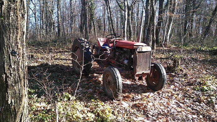

Yesterday I washed it and took off the cabin, but today I took it for a walk, interestingly at 48, everything still works fine, but after half an hour of operation it shows its known symptoms, oil leaks in known places, non-functioning electric dynamo. It belongs here …

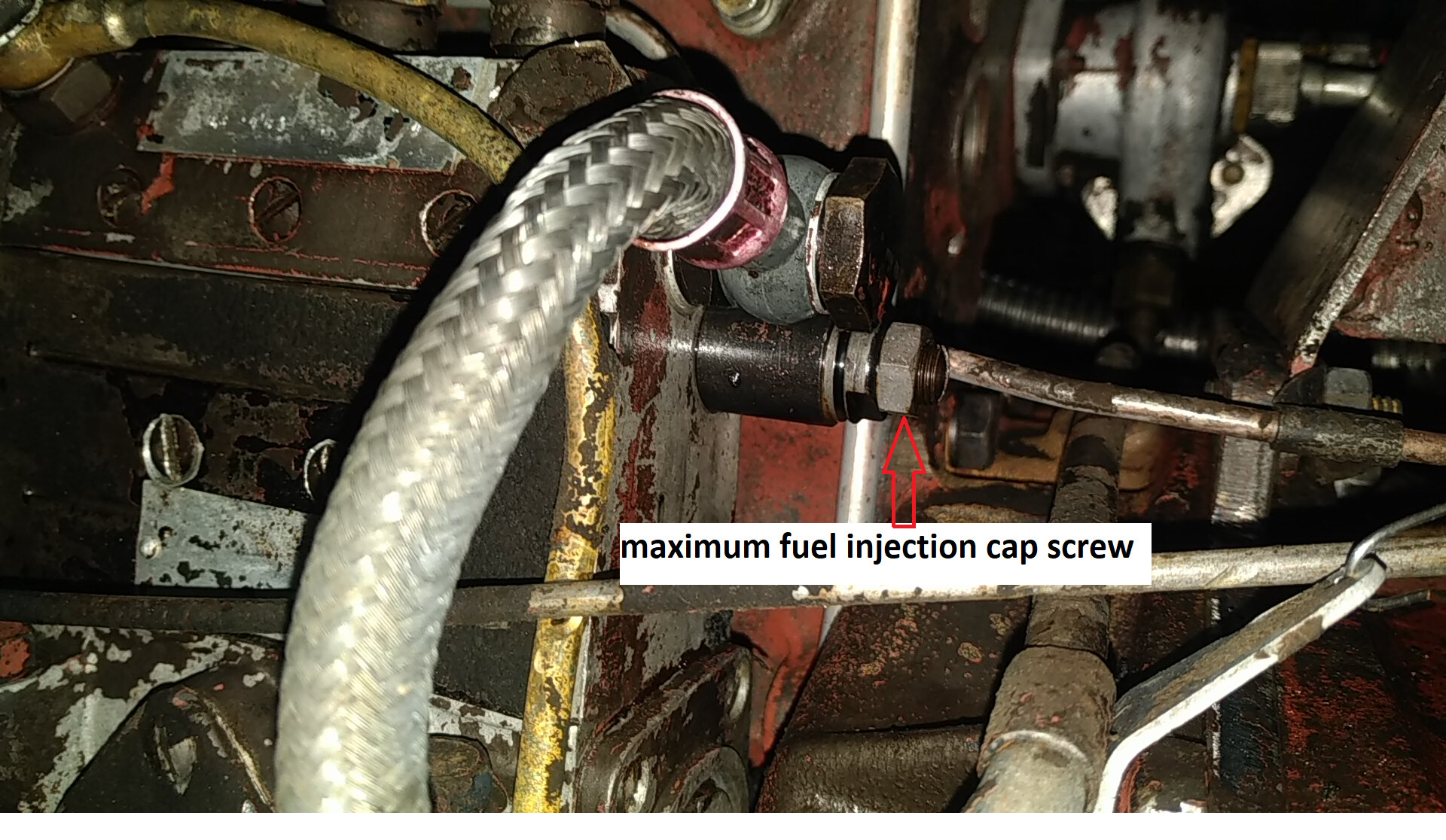

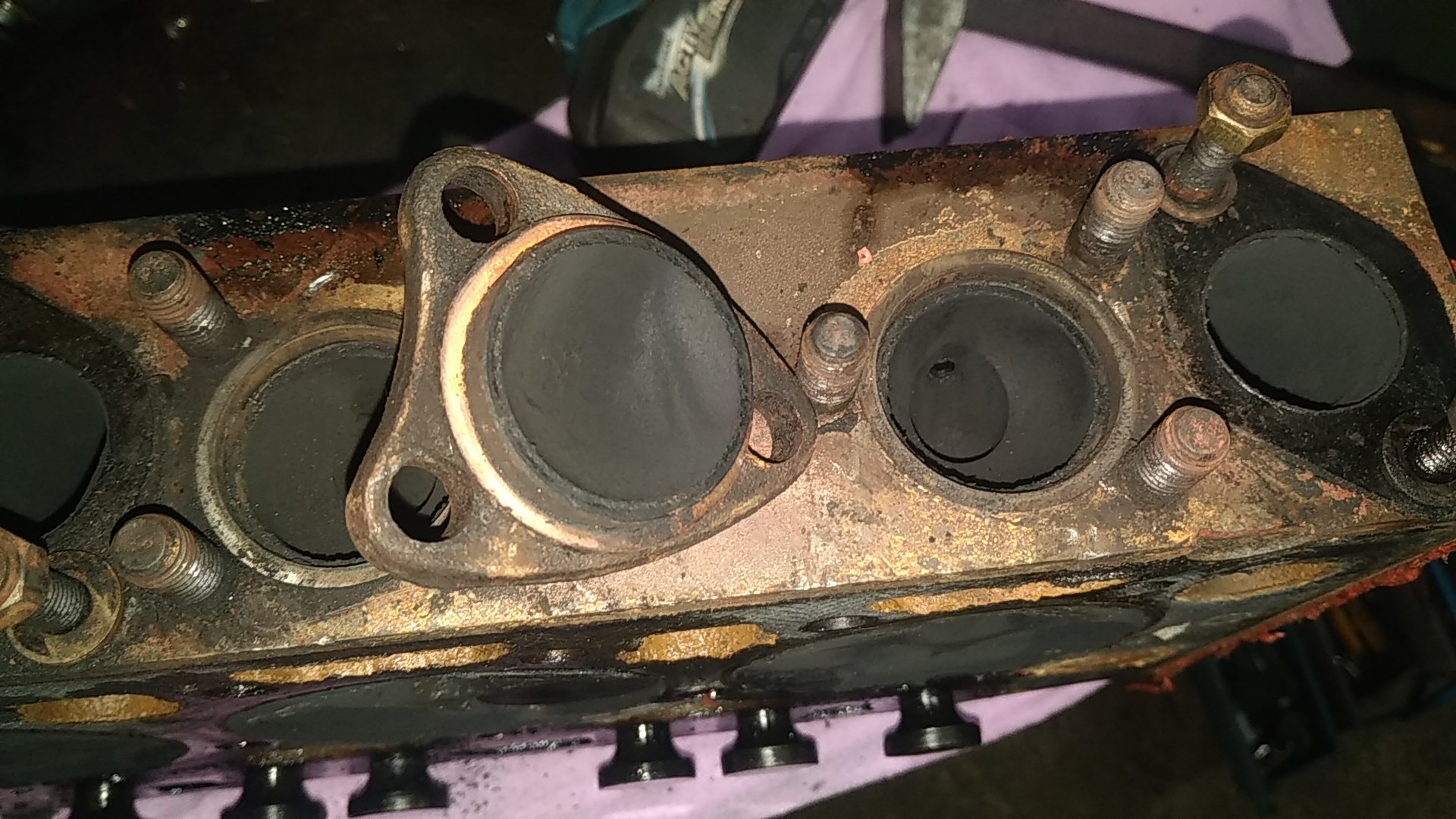

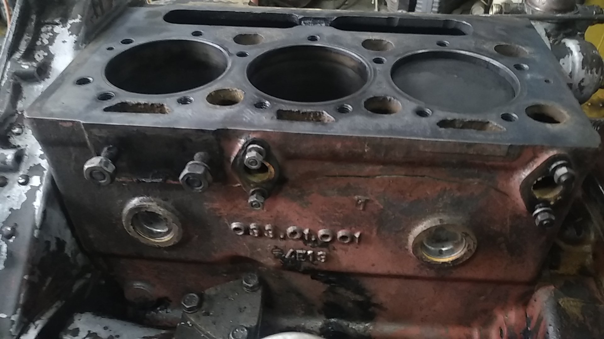

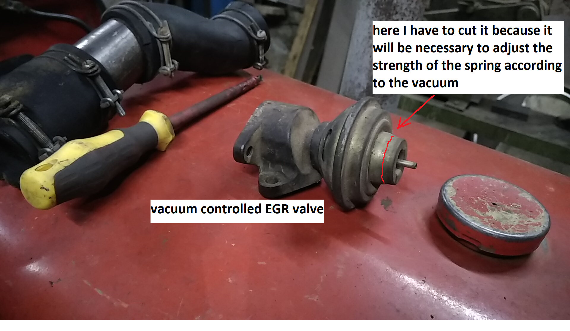

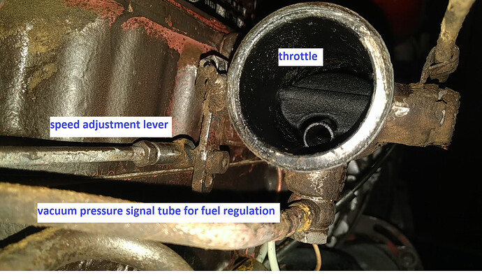

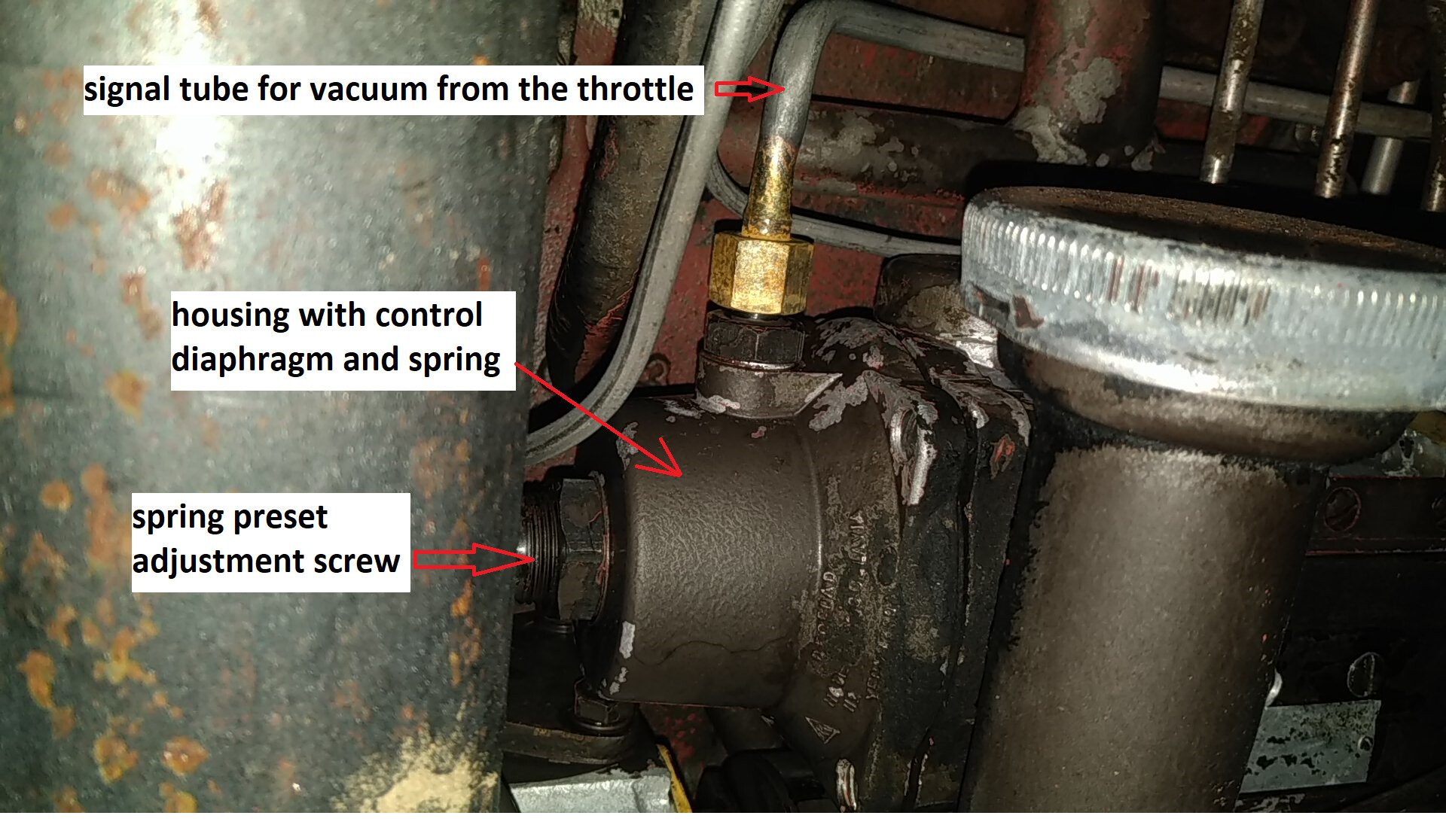

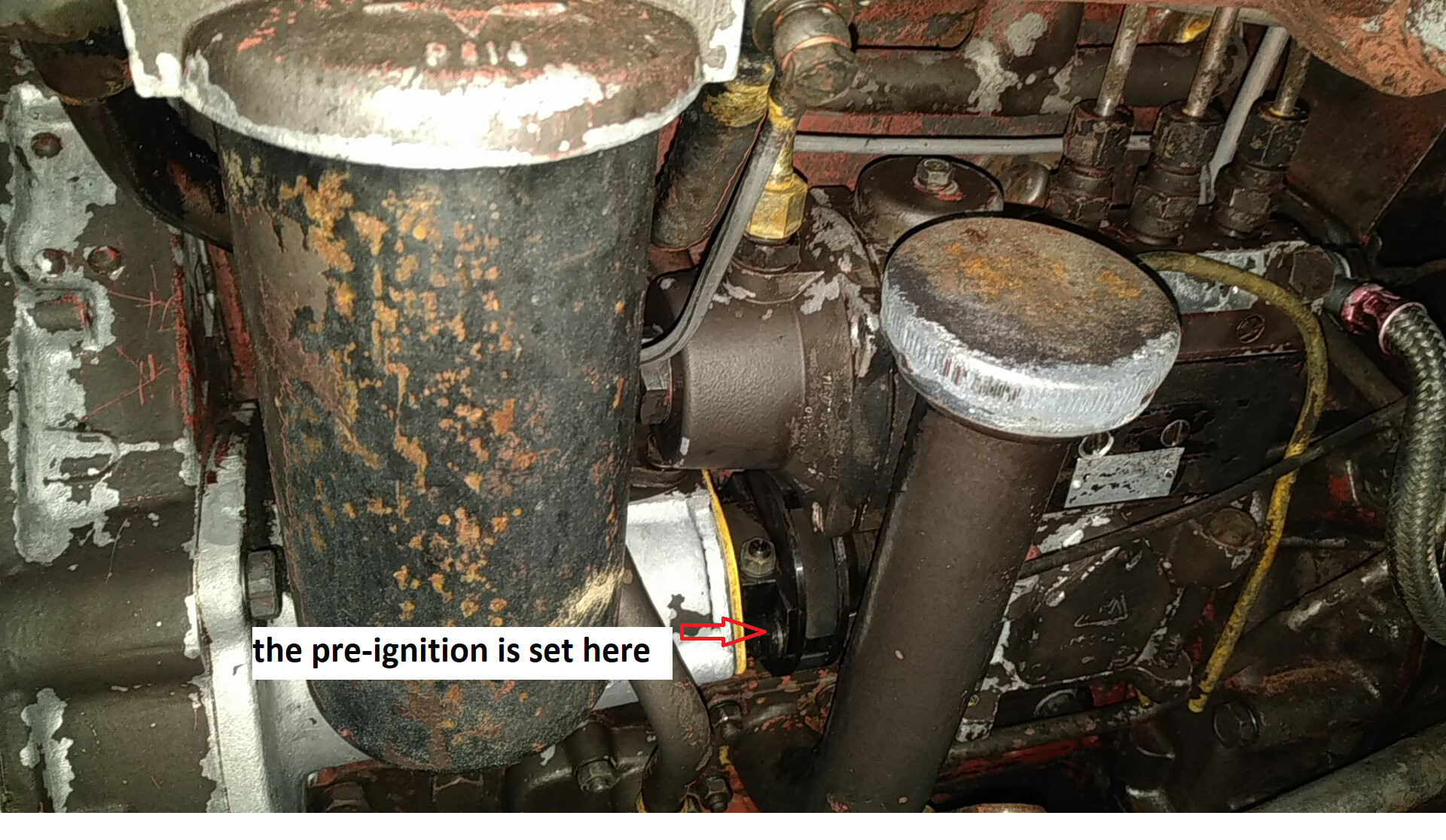

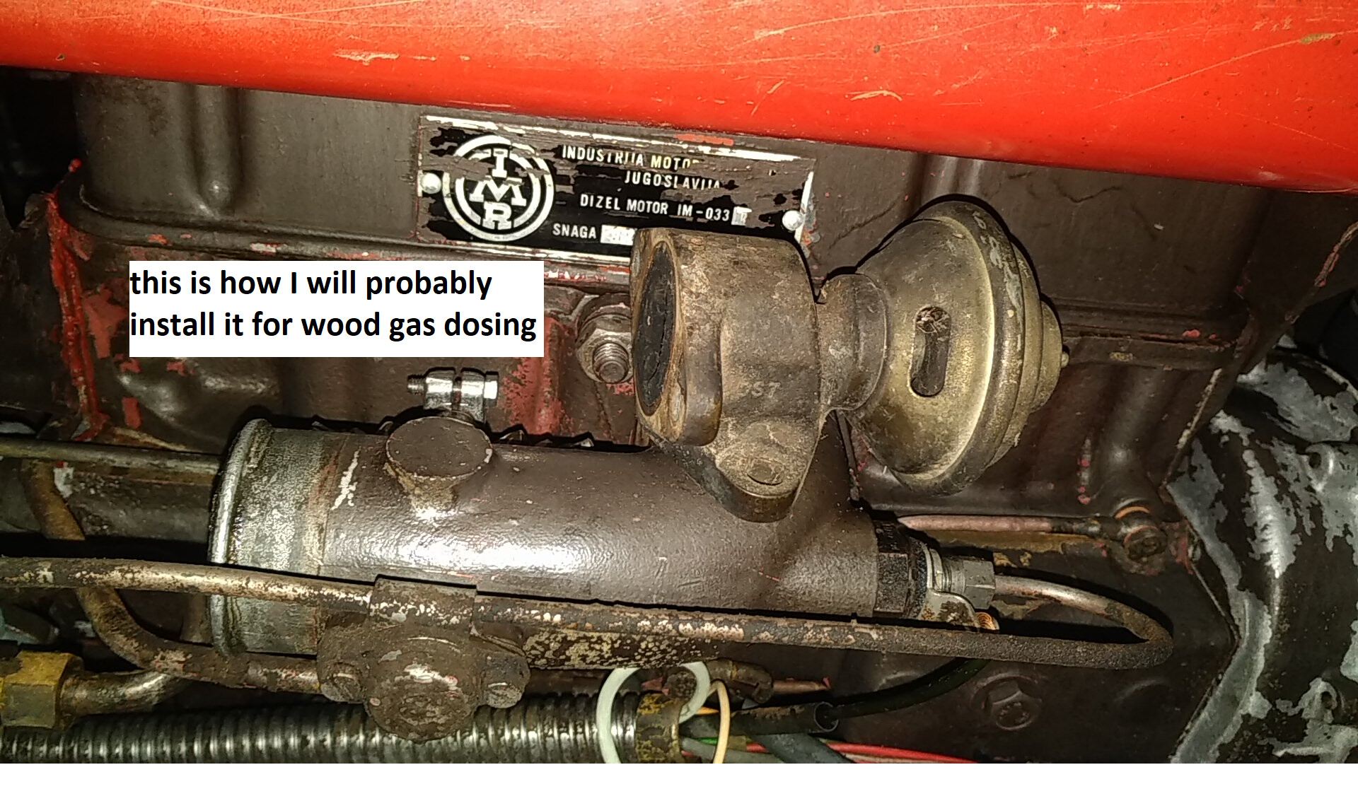

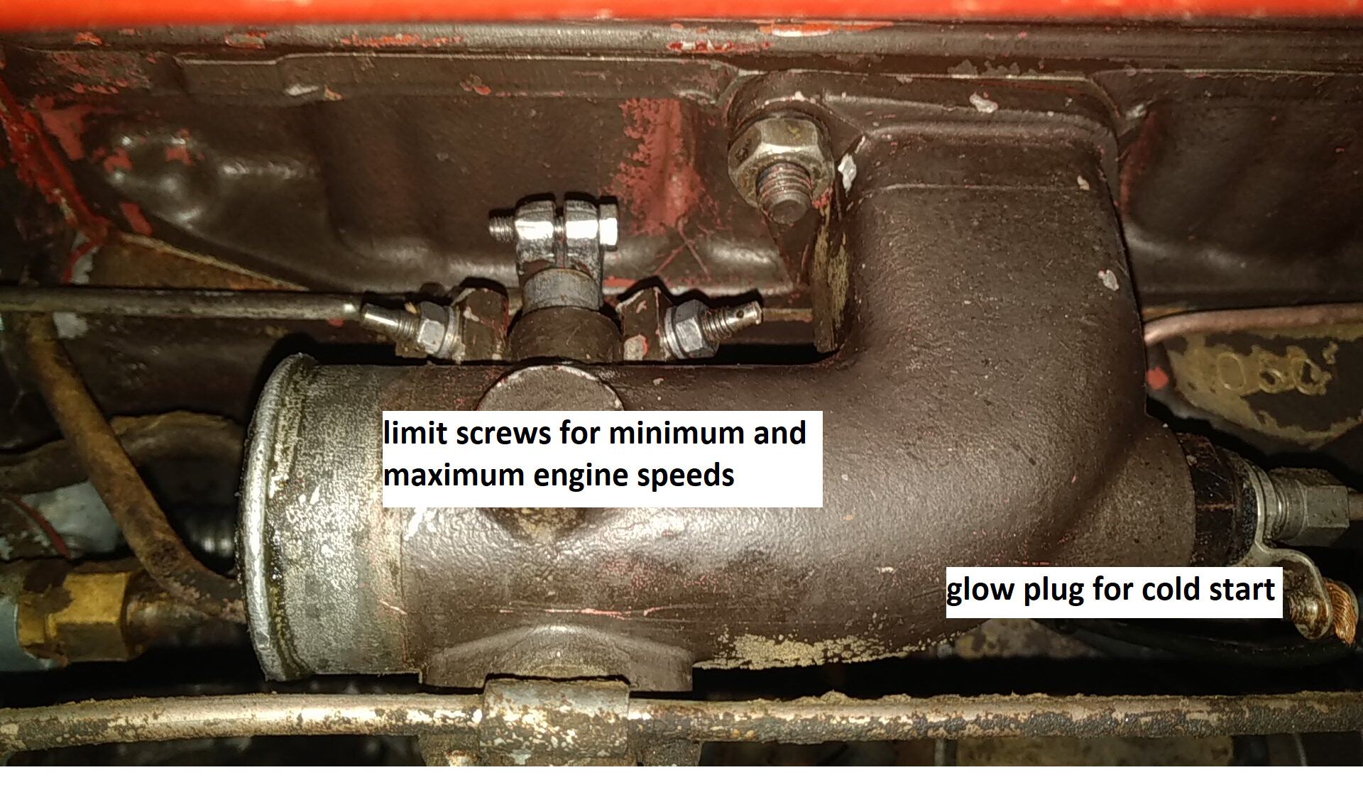

I thought a little about the regulation of wood gas for the tractor, I am attaching pictures:
Tone, how does it have a EGR valve? Never seen one of those on tractors…
EGR valve is not from this tractor, I think to use it to regulate wood gas in parallel with diesel fuel
a lot of work opened up.
:relieved_face::grinning_face::thinking:
