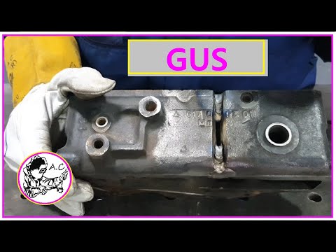

This master has been engaged in the welding of gray cast iron, aluminum, bronze, brass for 40 years. The welding method is simple, the material must be cleaned well, it is also possible to cut into the crack, then sometimes the welding site is heated to evaporate oil and impurities from the material, otherwise holes appear in the weld. Then weld a maximum of 2 to 3 cm long weld, grind and wait for it to cool down a bit, then continue, sometimes leaving a gap of, say, 3 cm. The second clip shows tig welding, the master used to add material from the electrode.
See this is why I have such respect for the other side of the pond. A master at his craft. No auto darkening welding helmet. Plain Jane stick welder. Handheld cheap grinder. It’s not junk, it just needs a little fixing. Make due with what you have instead of rush out to buy it new with the fancy plastic card full of money you don’t have. The cigarette never even left his mouth! Not his first rodeo as Wayne would say
