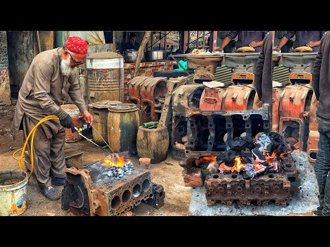

Hmm, some sanding, some welding, finally protecting the weld with paint, but the block is ready for machining, that is, changing the cylinder linings, custom sanding and leveling the top surface.
Crack? I donāt see any crack. I must have imagined it earlier.

Just amazing to see how some people still have to do things in a primative way. Iāve read where during WWII some countries had no petrolium, so they made vehicles run on wood. An old lost art, I guess. Seriously, does anyone have any idea what gas he was using? When I was a kid, every garage had an acetylene generator and an ozygen bottle for welding. I didnāt see any oxygen in the picture. And when grinding, it didnāt look like that was brazing rod. Wonder what it was. Finally, I thought when they got done doing the welding or what ever, you had to place the entire casting into something that would hold heat ( sand? ) to cool down slow. TomC
Tom, l think he melted the actual cast iron, hence the intense preheatng of the part. The cow pattys were probably there for slowly lowering the temp by burning progresively colder.
Definitely, they use acetylen. You may see man putting few pieces of carbide into generator at the beginning of the video. I suppose they use only compressed air instead of oxygen because of flame color.

No worries JO. Pick the most common engine in use in your area. You can keep one running almost indefinitely by scavenging parts. My thinking is buy at least one set of head gaskets. I donāt know any work around for that. You probably could make all the other gaskets but I have a complete rebuilder set for Small Block Chevyās.
You can make them out of sheet copper. Reusable, if you reaneal/stress relieve them. Actually LP gas is hot enough. Some racers do it. Just more expensive.
That was very interesting Rindert. I have heard of reusable copper gaskets before but never thought it was worth the risk and I never heard of using silicone between head gaskets. Must be something you pick up from working on diesels, which I never have. I see the gaskets were formed for O rings and the block was O ringed but in the video I never saw him install them. Or course he probably skipped a few steps to keep the view time down. I figure that for under 50 bucks for a long block gasket set itās easier to just stock a few sets. I will be looking into the copper though.
