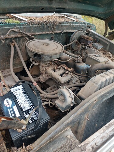

Lol, started right up when I repaired the squirrel behavior. Chewed the six wires off the brain box. I happened to still have a spare wire harness stub, and a box…
This vehicle is absolutely ridiculously simple. Three on the tree, no PS.
I’m guessing those pine needles do a good job of filtering your cabin air Bruce.
