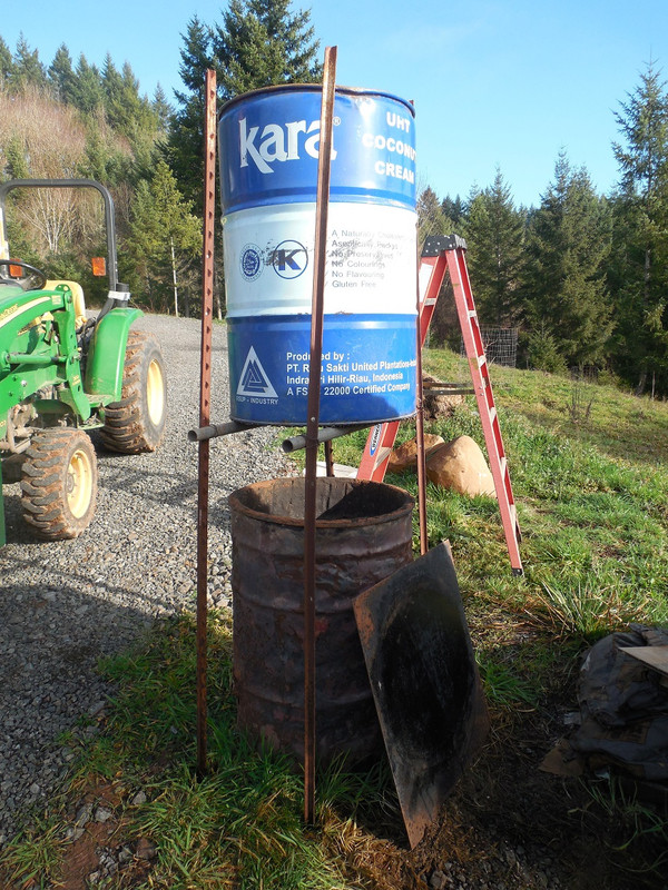

I decided to try to do something useful with all that wasted heat from the charcoaling process, but the green wood caught on fire much faster than seemed possible! Seems the flames find the path of least resistance through the wood, and the pieces in that area dry out, then start to burn.
For my next attempt I am going to lay the barrel on its side, so I am heating solid steel, and letting all the steam escape through the mesh end. That way I can also rotate it to give it an even roast and it should make emptying it a lot easier.

I use a 30 gallon barrel layed on its side with a door and air controls on one end and one length of stove pipe running horizontal from the other end .Put a 90 degree elbow on the end of that and stick it in the bottom of a wood smoke house. Welded legs about 9 inches long on a cast iron fry pan and set it inside the smokehouse above the the opening of the elbow to force the heat and the smoke to go out to the whole smoke chamber more evenly. Never burned the wooden smokehouse down yet.Seems like you could rig a 50 gal. barrel up to dry wood the same way with a mesh to hold the wood above a smoke defuser and a30 gal. barrel off to the side for heat
My experience with drying anything is that it always comes back to air movement more than (or at least as important as) heat. Heat alone wonât get it done unless the heat is also moving air to vacate the water vapor. True for clothes, and coffee beans, and tomatoes, and wood and mushrooms and everything else. âŚI think your idea will workâŚ
I meant to say I think your idea would work well.
It would be kind of stupid for me to tell you that the idea you are already using will work. ![]()
I had hoped to have run a test already so I could determine if your faith was well founded, but it has been too rainy here for me to want to try. I did set up a stand out of t-posts, and I think its a promising idea. The barrel rides on 2 round hurricane fence rails, so its pretty easy to turn. The mesh end is tilted slightly upward, so hopefully the steam will rise and find its way out.

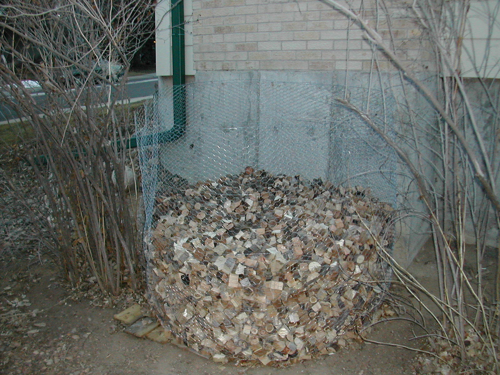

Just to help you with your planning. This is about half of the 1500 pounds I think I can chunk before March. This is all very dry stuff that has been in my wood pile for more than four years.

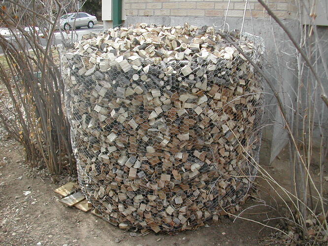

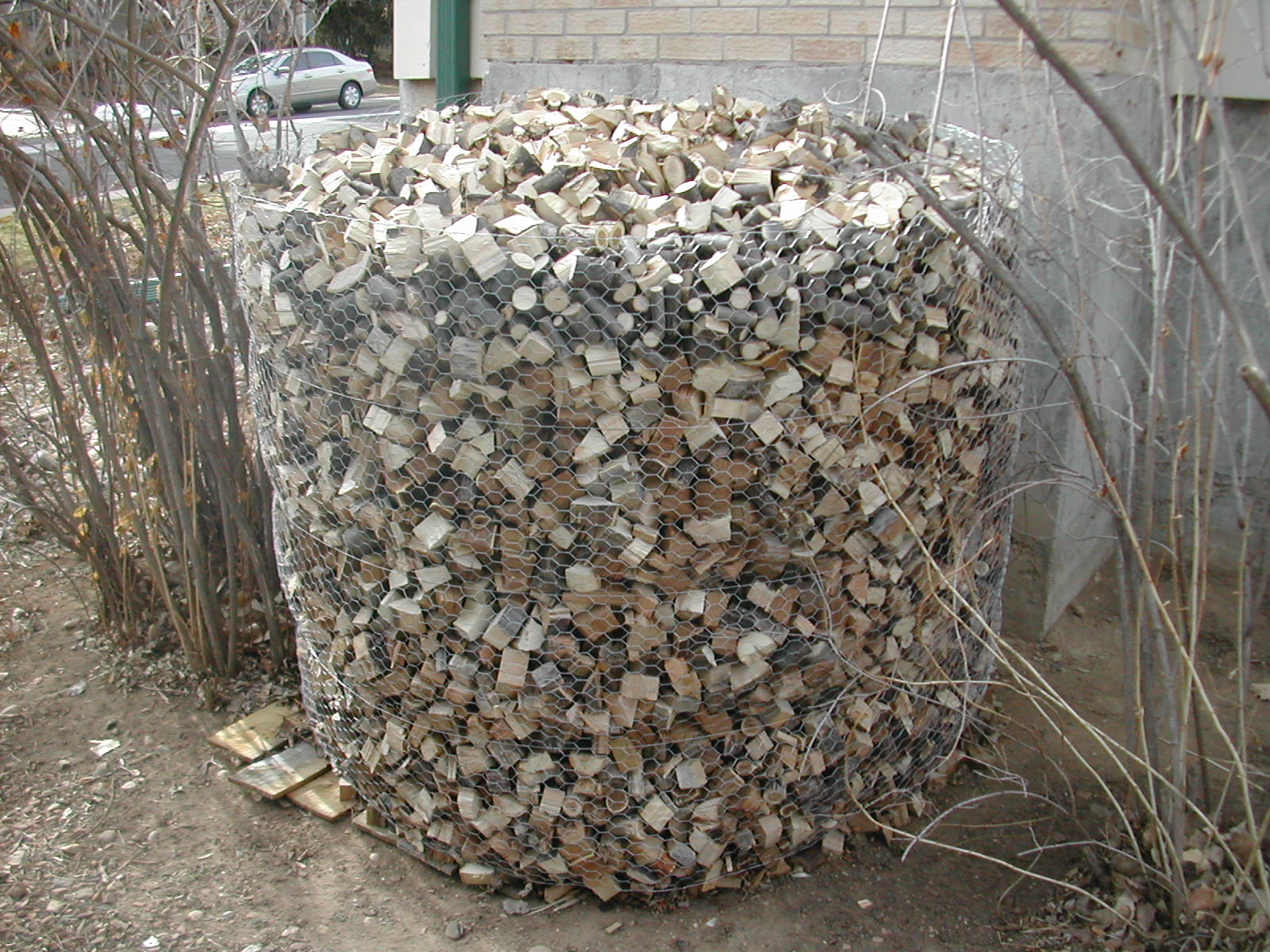

Well, I filled up this wood crib, enclosure thingy I made out of chicken wire, aka poultry netting lol.
5ft diameter by 4ft high. If my calculations are right there should be about 1500 lbs of chunks here. I guess if youall donât show up I just have a lot more incentive to get my gasser working. I have to go back to working on my bathroom again. Wife says.
