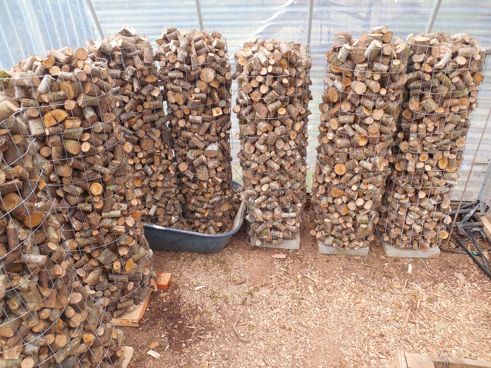

I have been slowly moving your chunks out into my greenhouse. At first I threw them all in a giant bin but the pieces in the center were not getting very much airflow. I spread them out on the floor of my shop, which helped, but then they were very much underfoot⌠Here is the new setup:
I grabbed about a dozen pieces to test the moisture, and they are now down to an average of about 32%. I am confident that they are on track to air dry by March.

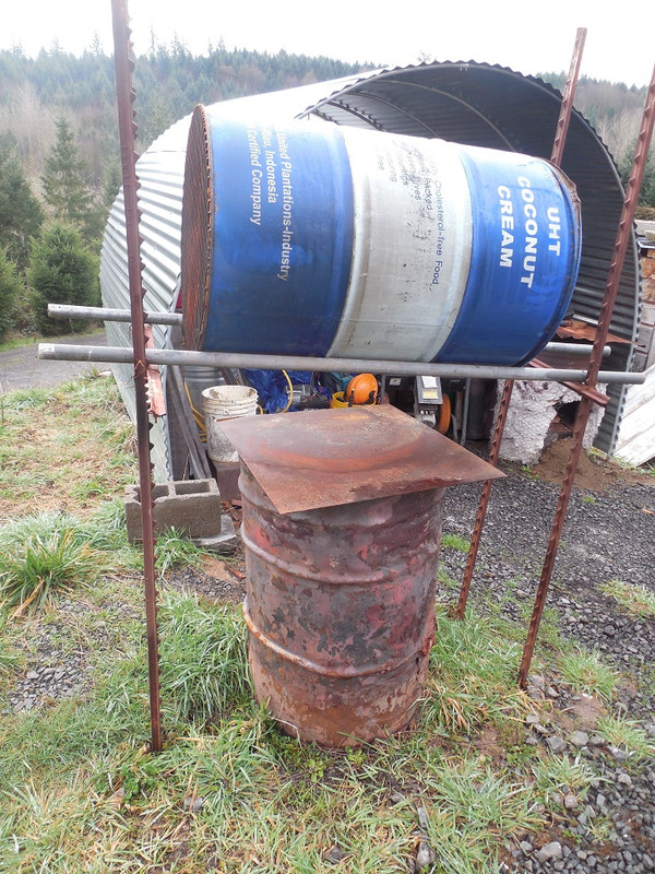

Here is the drying rig I built:
It did drive out some moisture, but not very evenly. Some pieces dropped 20%, others hardly any, despite rotating the drum every now and then. A few pieces got charred, but nothing caught on fire at least. Seems like if you were really desperate you could dry wood this way, but it would be an uphill battle.

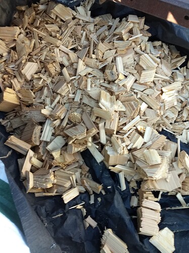

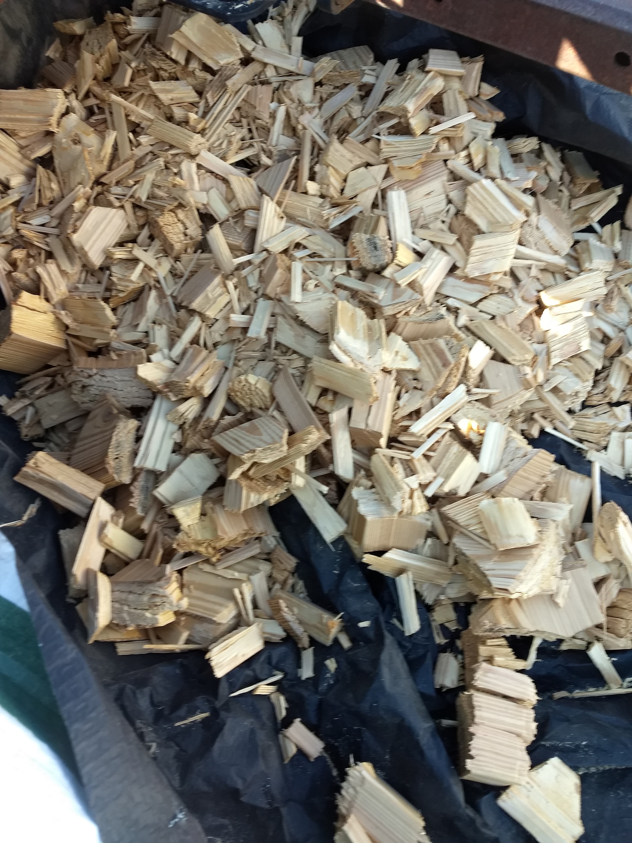

Will this work about 10percent moisture . Racing fuel. Can make bigger chunks but worry about bridging lmk. Shatters easily
Looks good
How much are you going to have.
How many pounds.
The pieces weigh 8-10 lbs each I have around 100 of them
