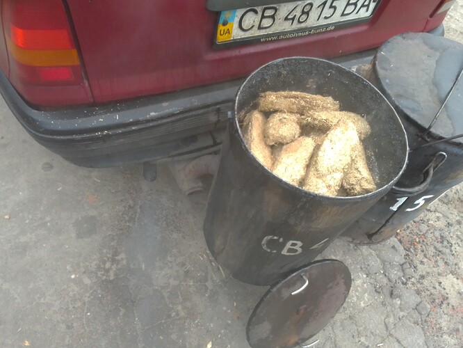

Has anyone tried to fill wood gas generators with non-standard fuels, as I do? For experiments, I tried factory-made pressed peat and this is what happened.
I also use this kind of fuel. This is pressed straw and sawdust. The machine works well, but you need to be careful, as ash melting is possible. With this in mind, I try not to push the accelerator pedal all the way.

There have been a few. Most problems have been with getting the fuel to bind and stick together, without using a binder that will create excessive tar.
We don’t have much for peat in the US being sold for fuel. It is more popular in europe. It is interesting to see it being used.
Did you make your own pressed straw and sawdust or did you buy it?
