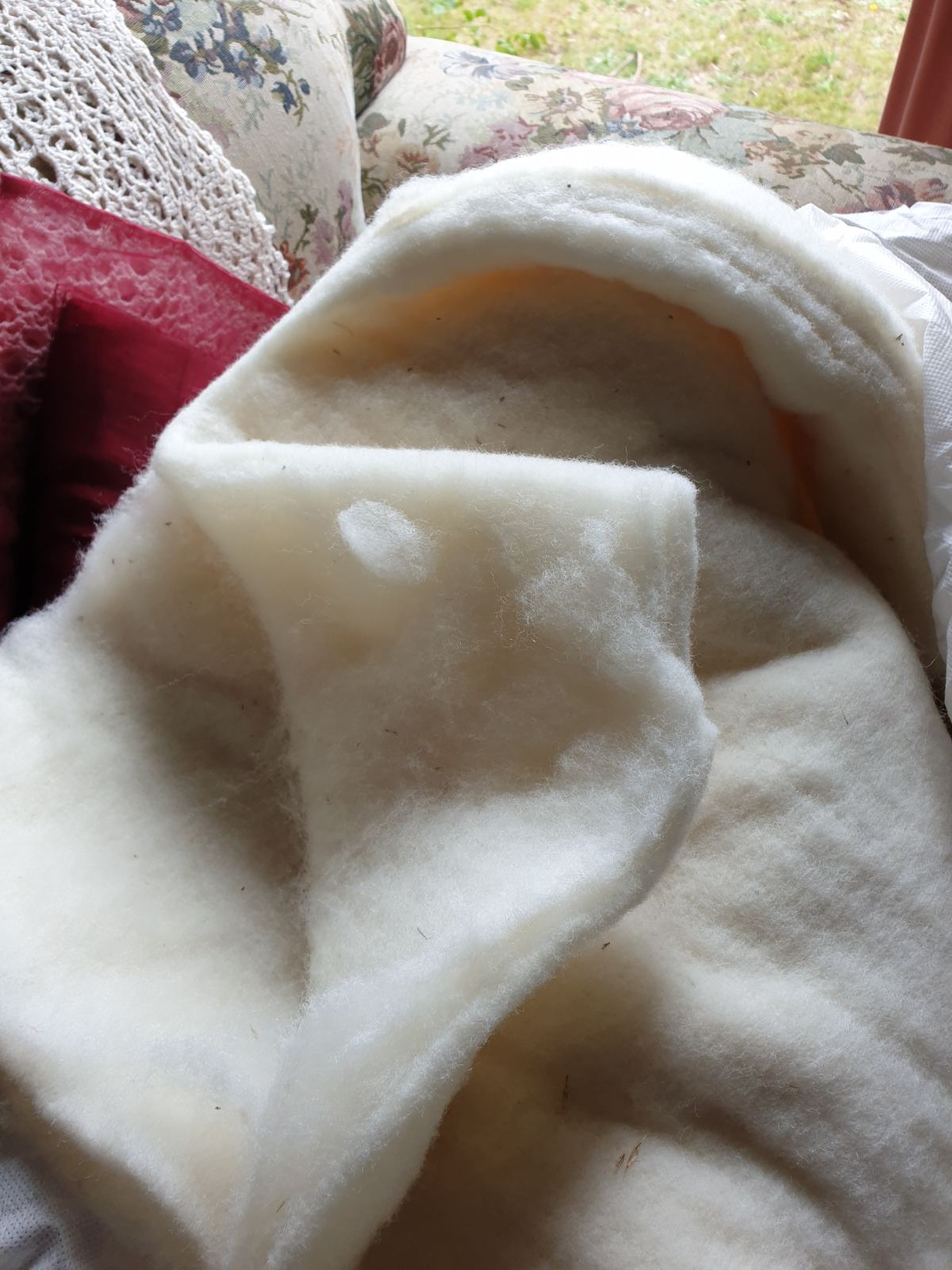

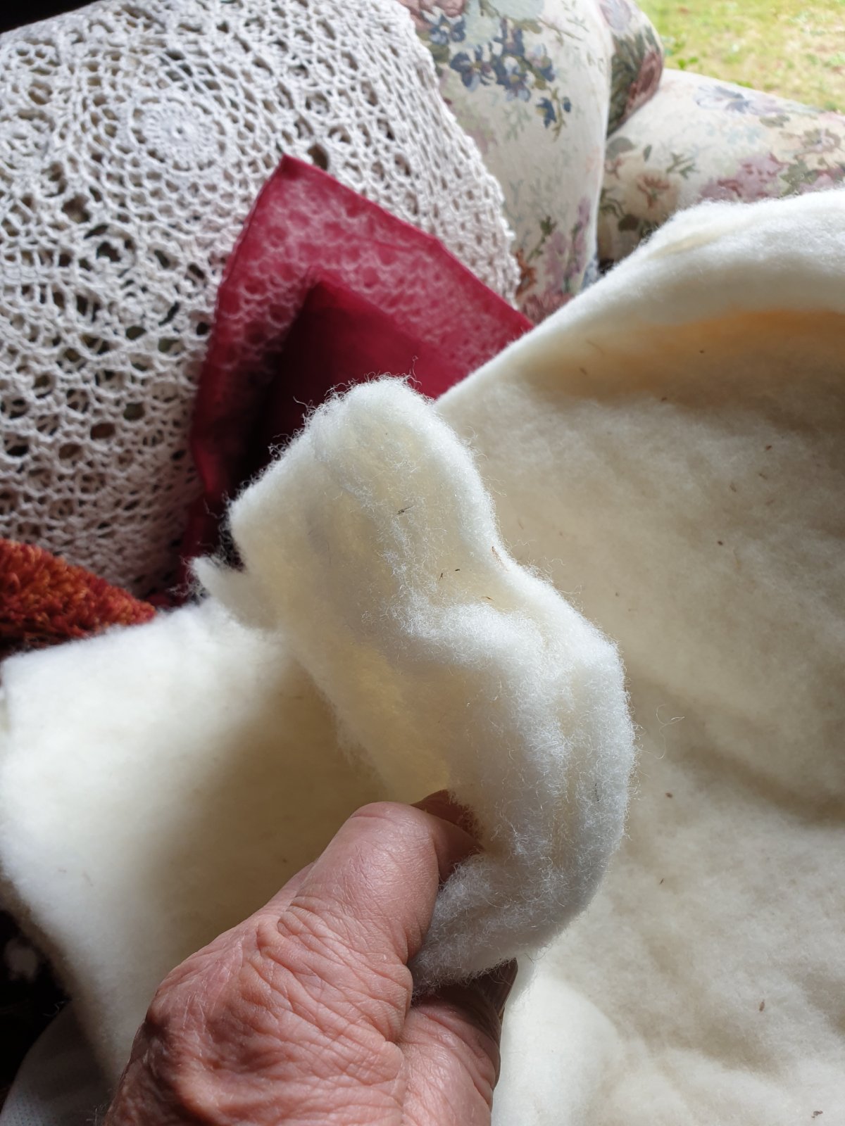

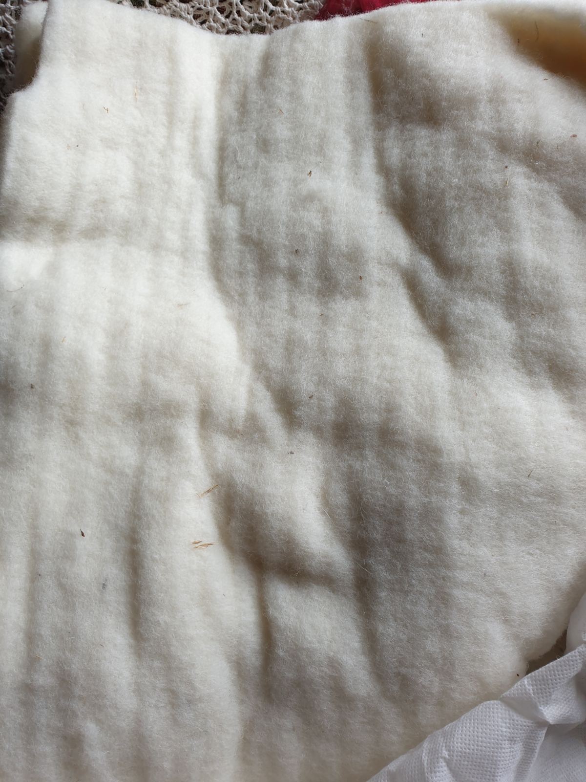

Well i think the problem that Joni is seeing with my suggestion of using wool is that he is thinking of a woolen knitted jumper and how easily it would be for everything to pass through that , but i am not talking about knitted material at all , the wool that i use is still in its raw state and just been carded and so looks like fiber matting it has yet to be spun and makes a fantastic filter here is a photo of my wool

I have never seen such material in my life âŚ
