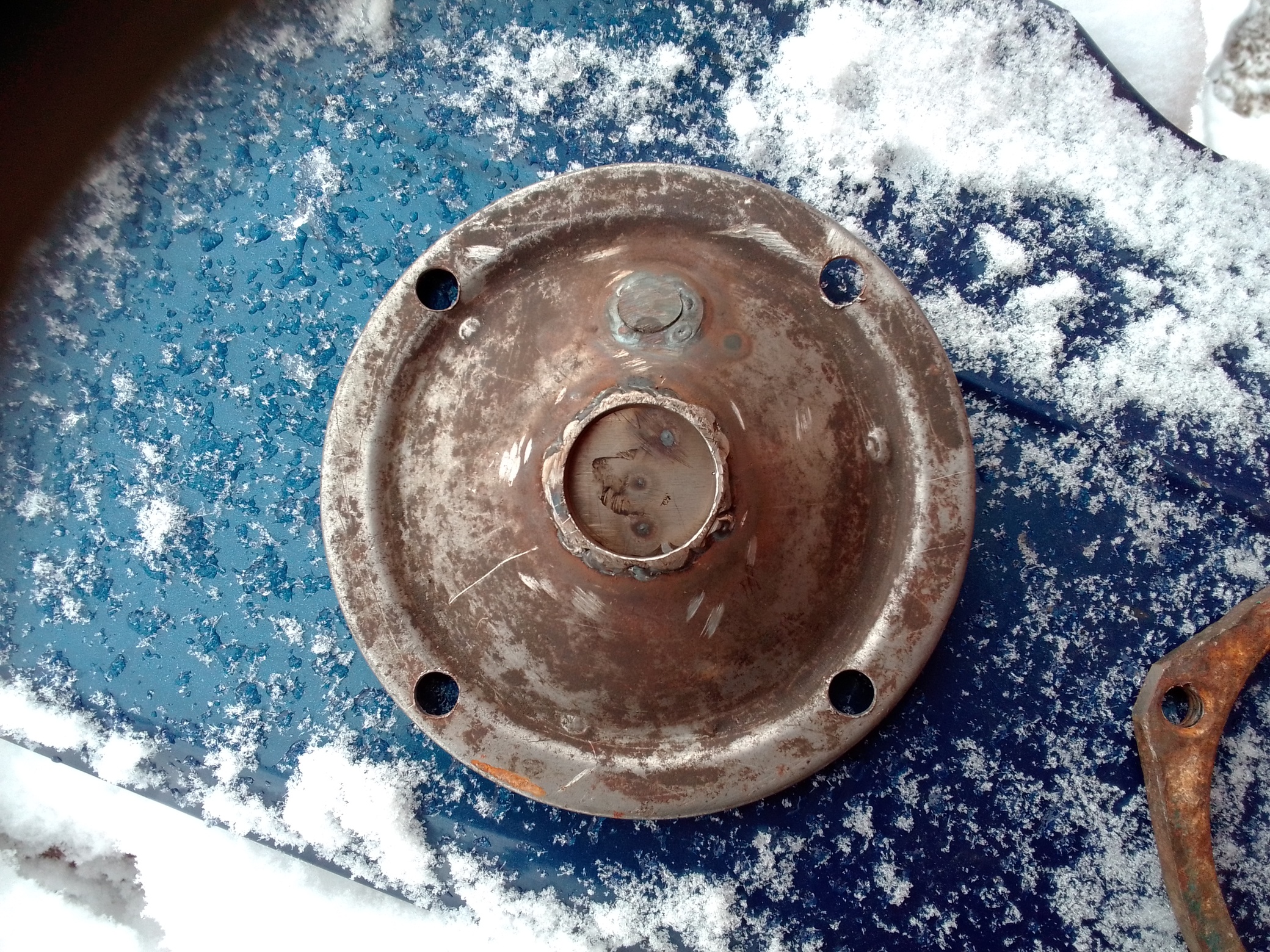

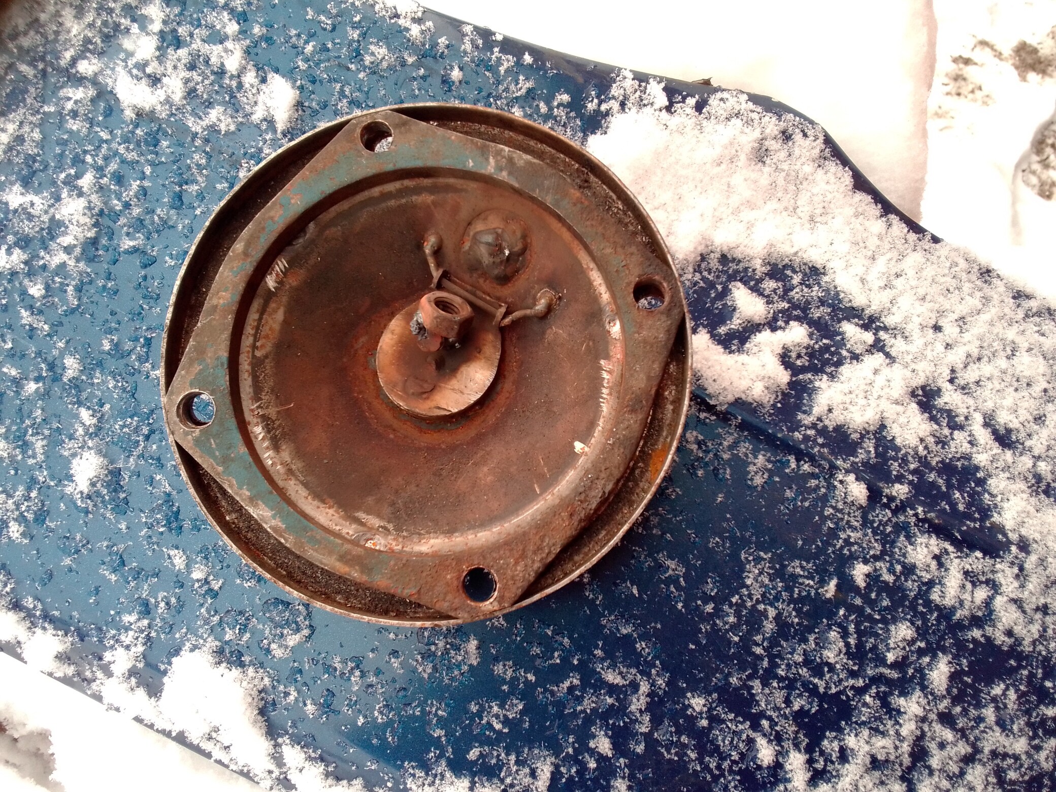

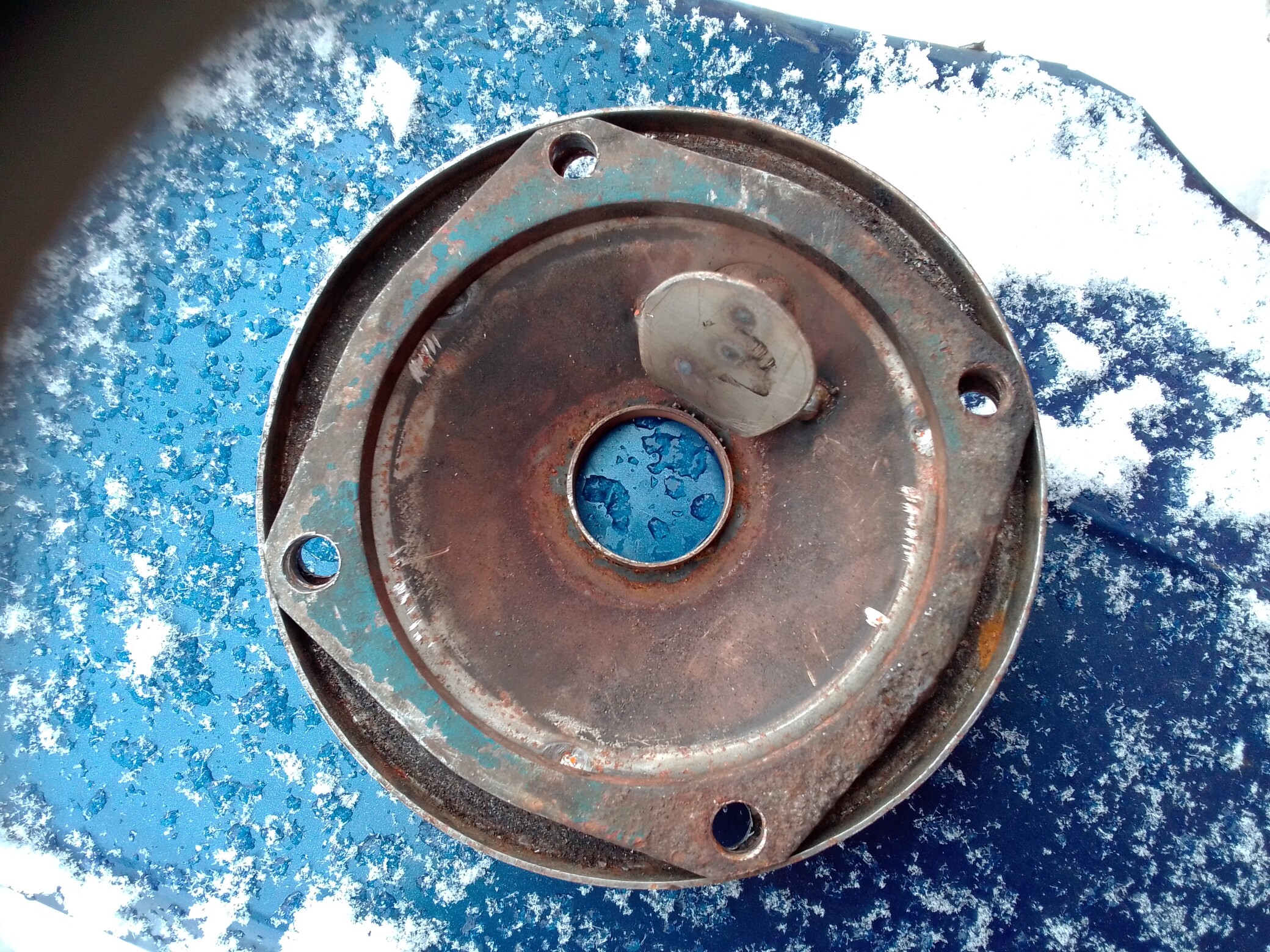

Do you want to show how to make your air intake, I do not get mine to work, the door becomes too sluggish.
Jan,
I think you just need to write to me in your native language … and I’ll translate it myself. Since the two translations greatly distort the meaning of the question.
Jan,
Did you mean this?
Uploading: IMG_20210130_113338.jpg…
Yes, I think so, what do you have as a hinge, mine looks like this and goes too sluggish.
Thanks Joni, I’m going to try your idea.
