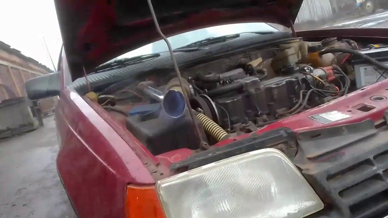

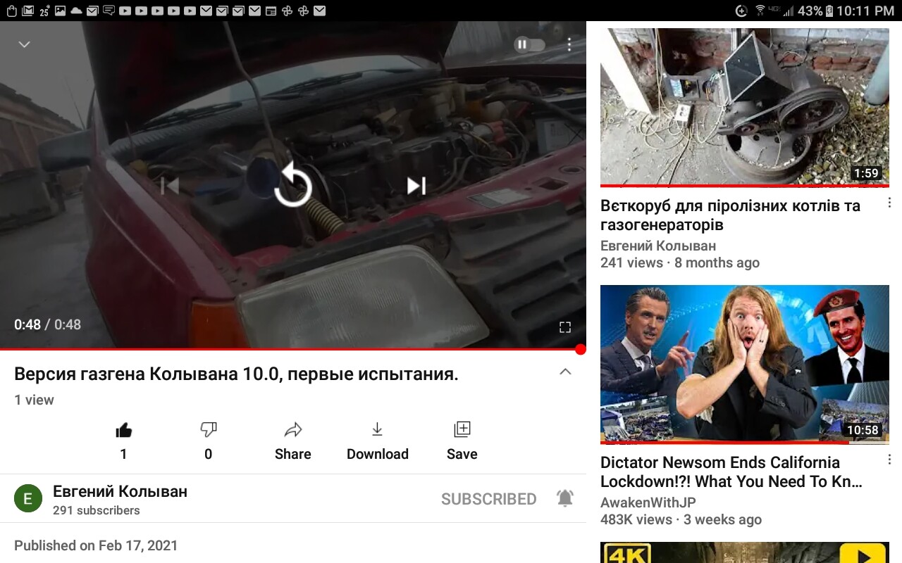

Wow Joni I just had the honor of being your first viewer on You Tube of your newest video.
I gave it the first thumbs up too.
The old 9.0 on the pavement now do have a buyer that wants it?

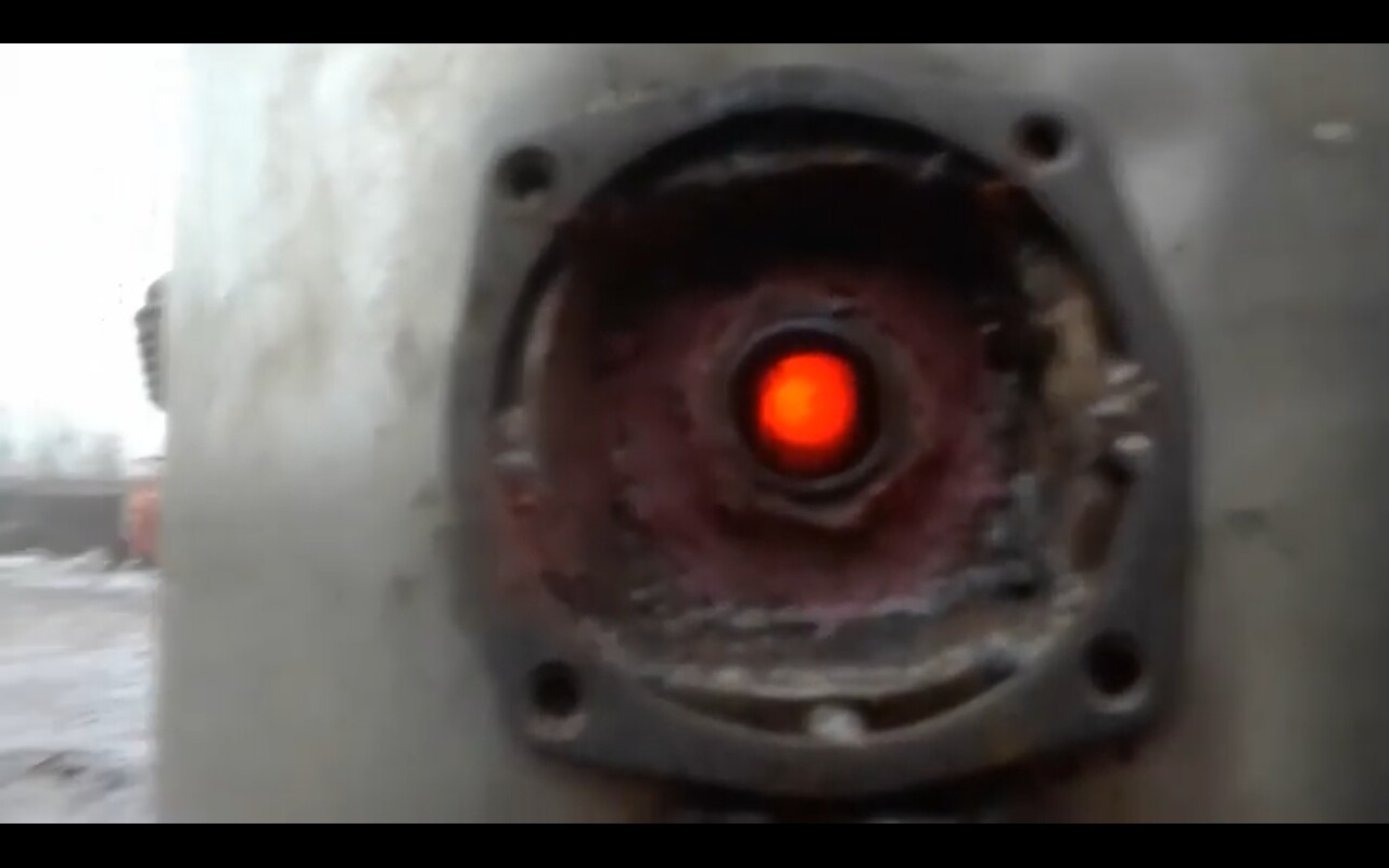

Looking into the 10.0 firetube lighting port.
Great video thanks you.
Hello Bobmac!
Ha! this video is already quite old, just until I tried it out and checked it out for flaws, I didn’t want to brag.
Now I am completely confident and satisfied with the work of the Kolyvan 10.0 system and I can brag about it :grin:.
By the way, the duration of the test program was 1300 km.

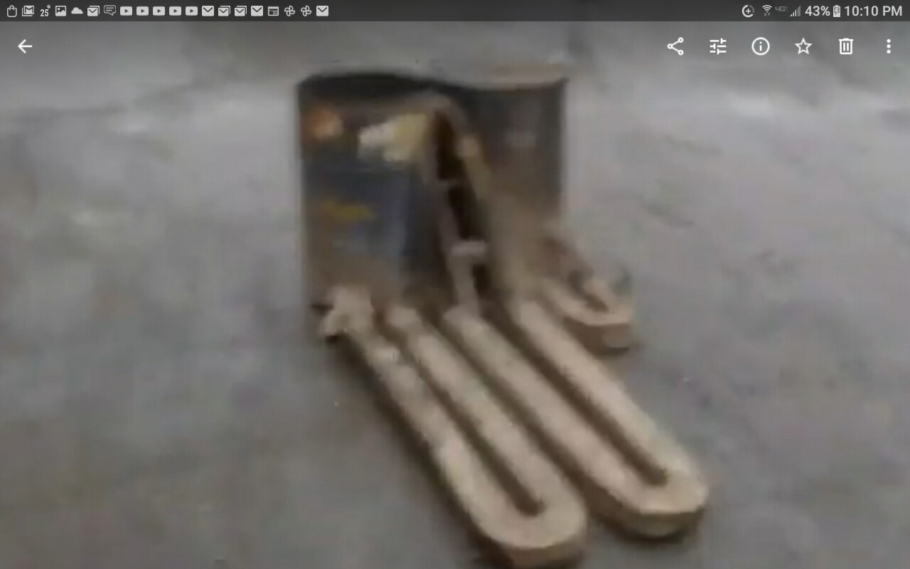

I cut up the 9.0 system a long time ago to show you the internal structure.
For :+1:, thank you!
And well you did show your GJ 9.0 sectioned out.
Proof of your concepts.
No cooler gas flow drag in that one!! (removed 9.0 system viewed at 27-30 seconds)
