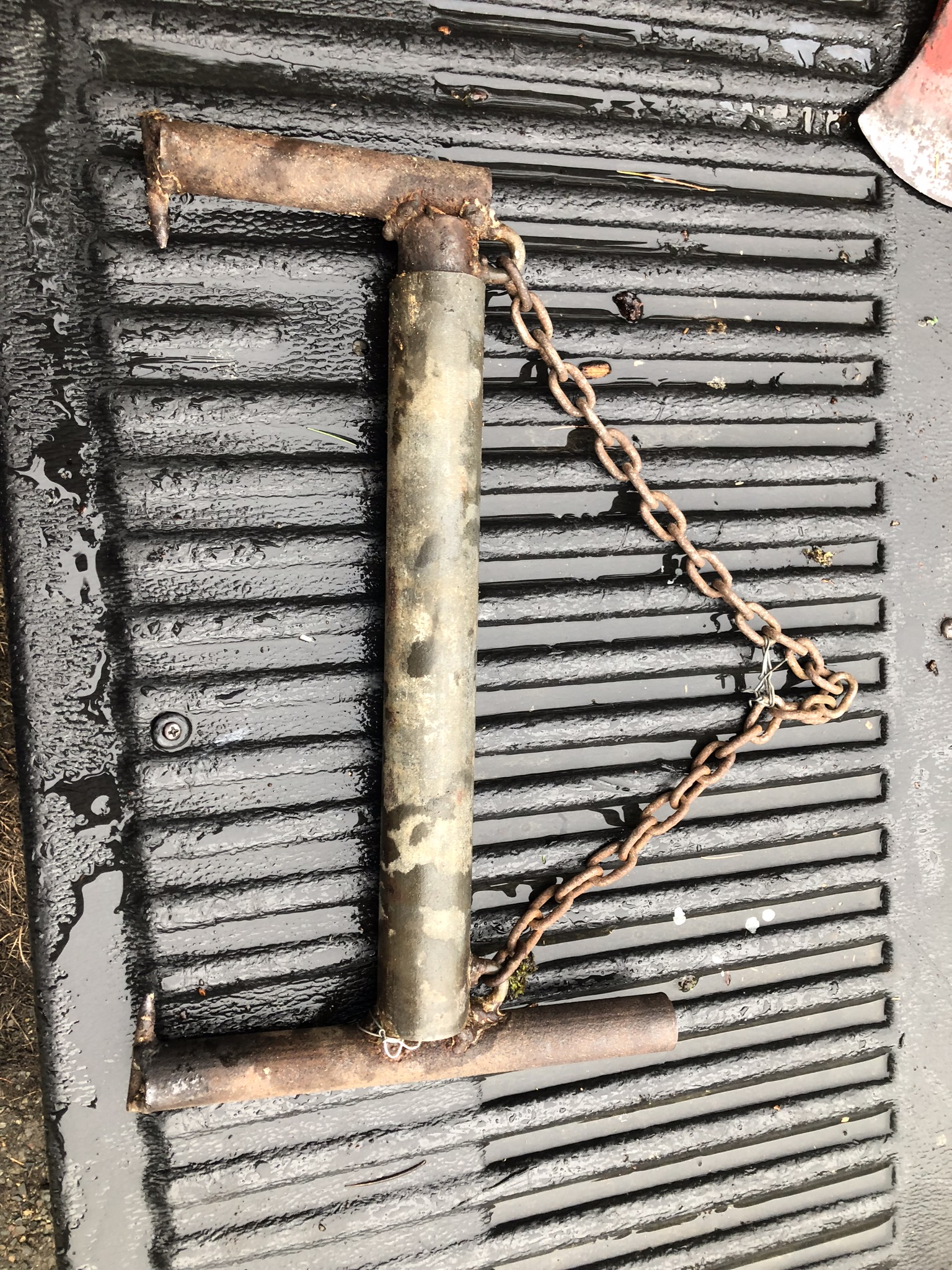

This is my Lilly pad picker. There is a extension spring inside the 1” pipe the holds it in the closed position

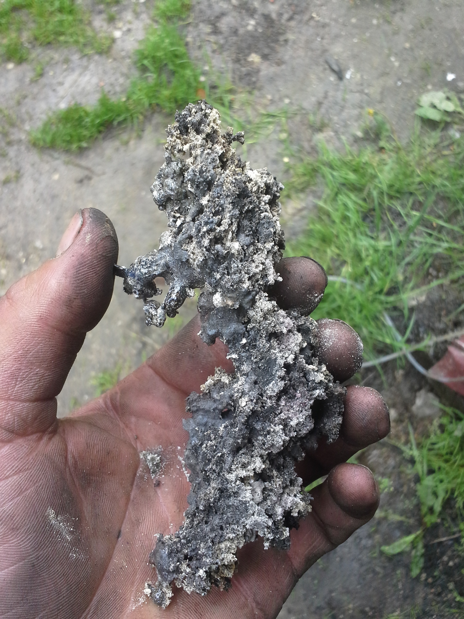

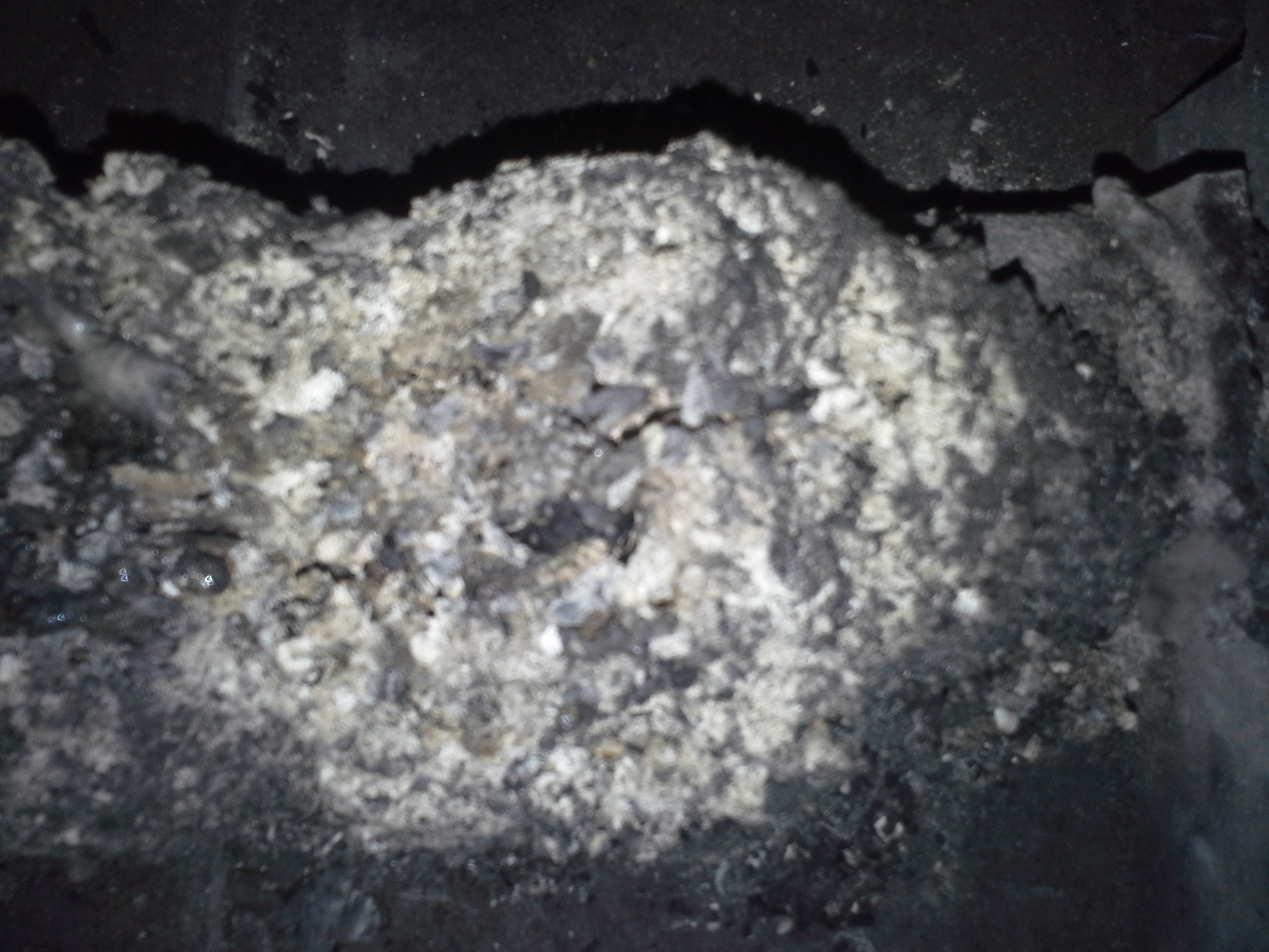

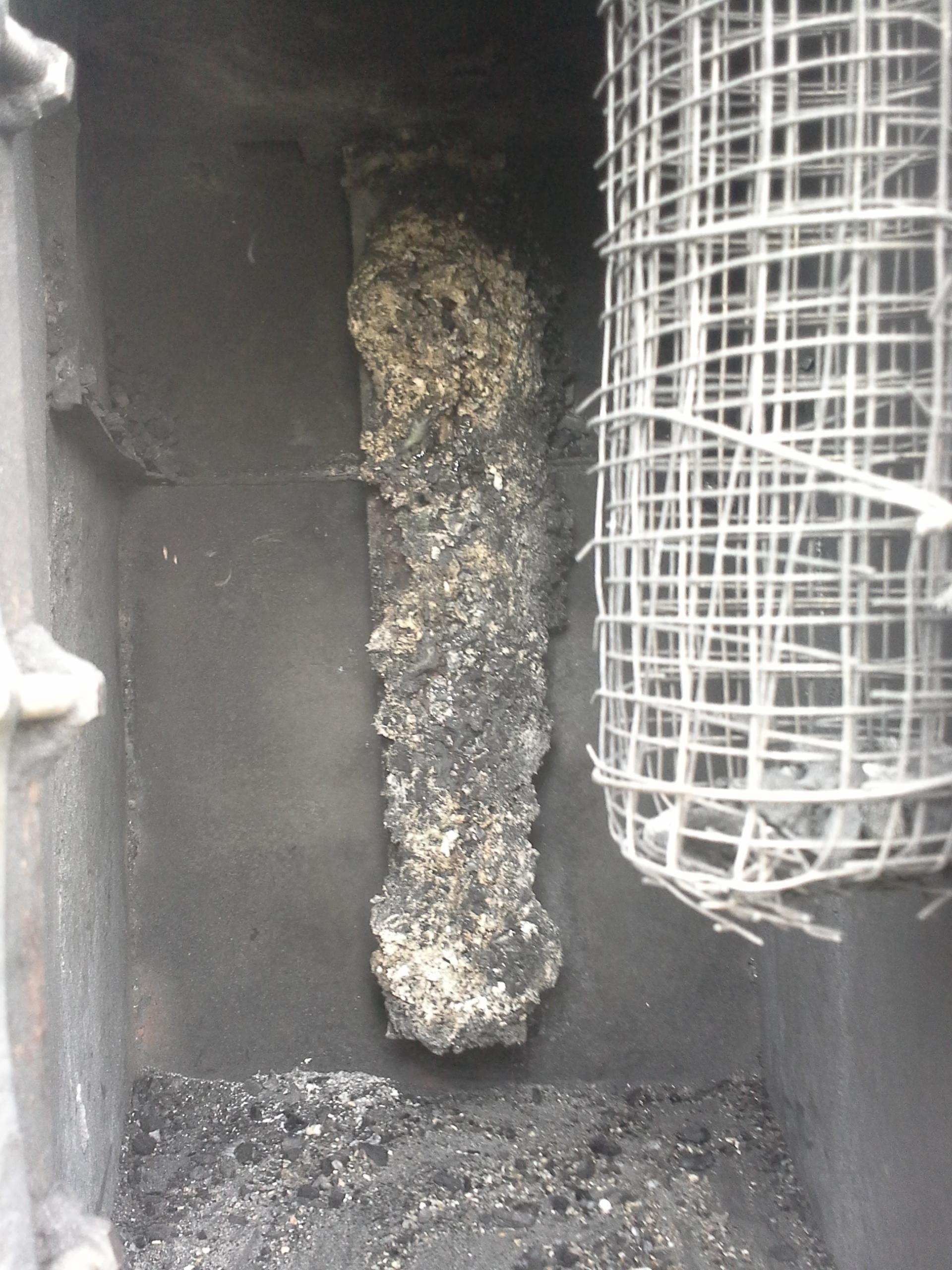

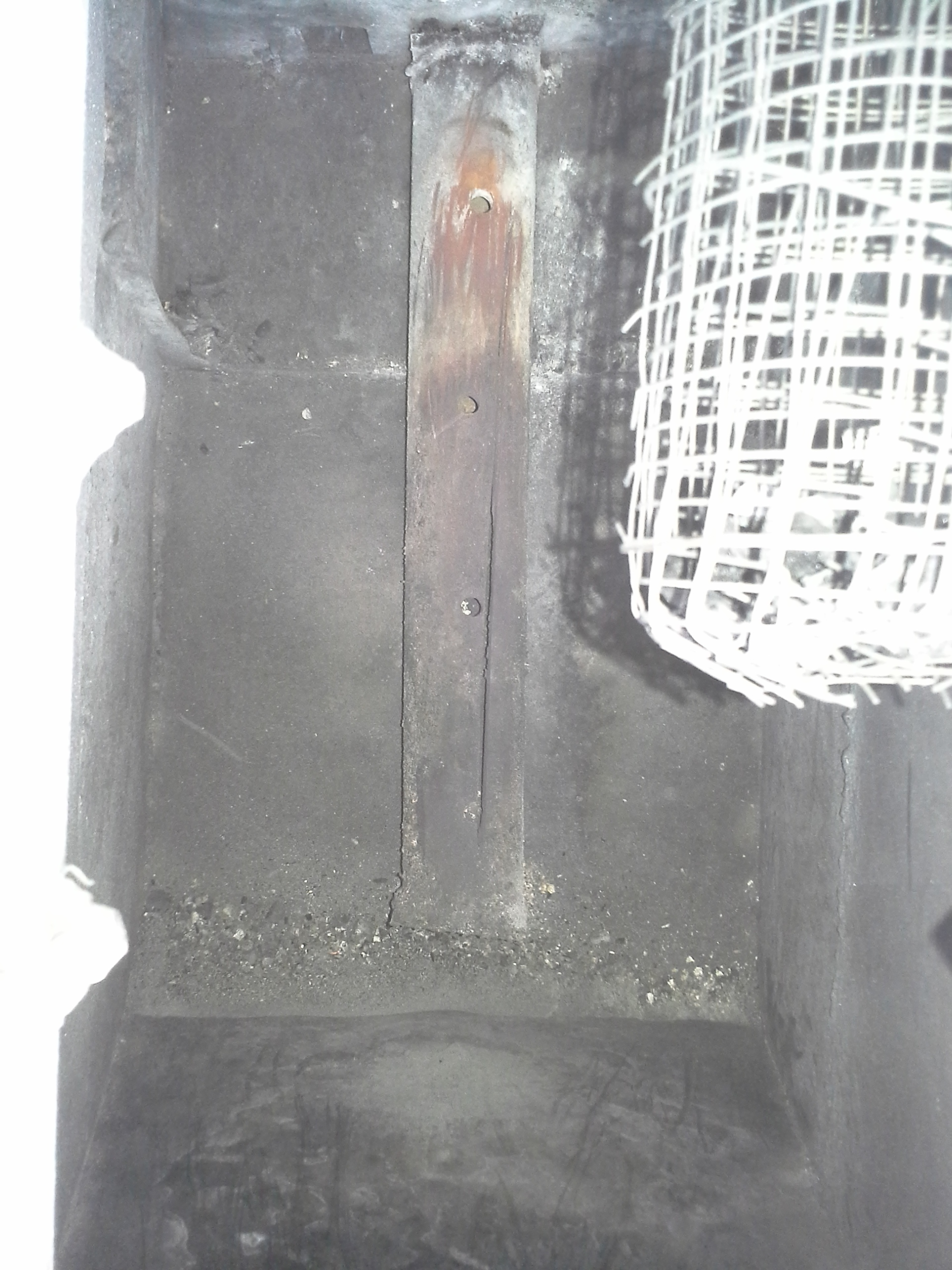

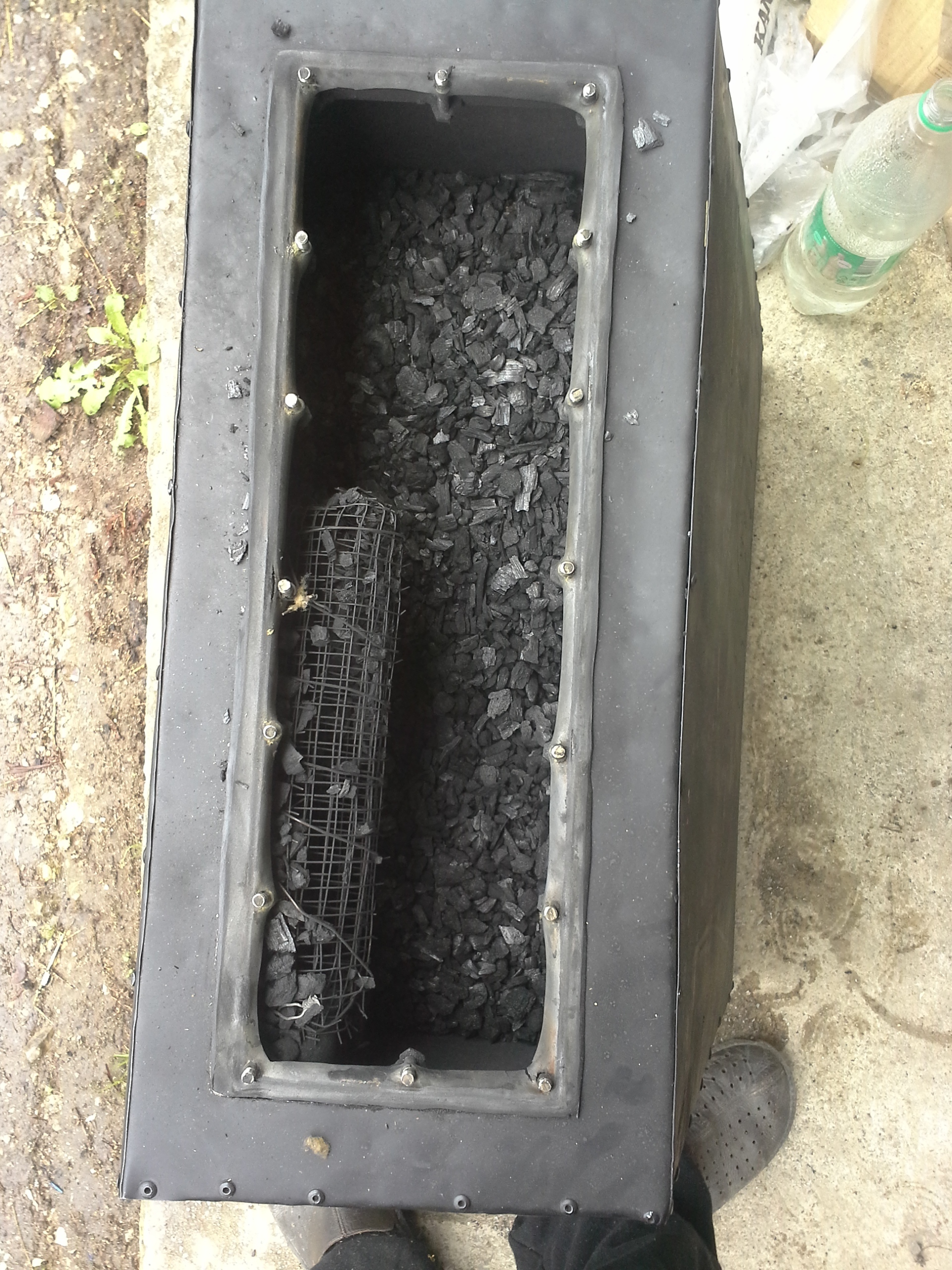

Thank you Wayne for that report! My fuel of choice is beech (both firewood and gasifier) but on my Chevy l mainly burnt oak.
I noticed oak produces best charcoal thugh. Instead of forming hard thick lumps of charcoal, it cracks in layrs, look at bottom picture.
Perhaps this greater surface area allso contributes to performance?

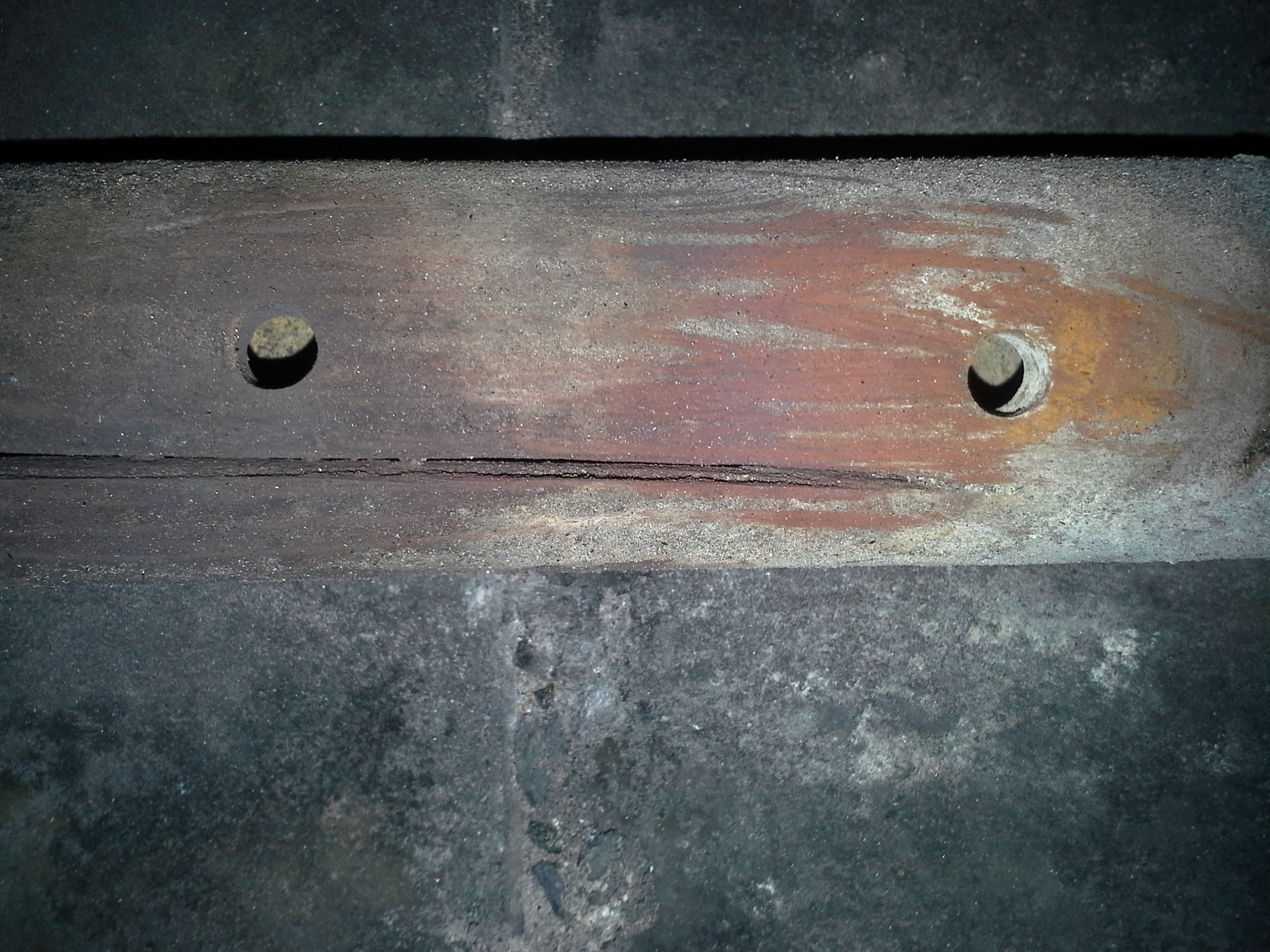

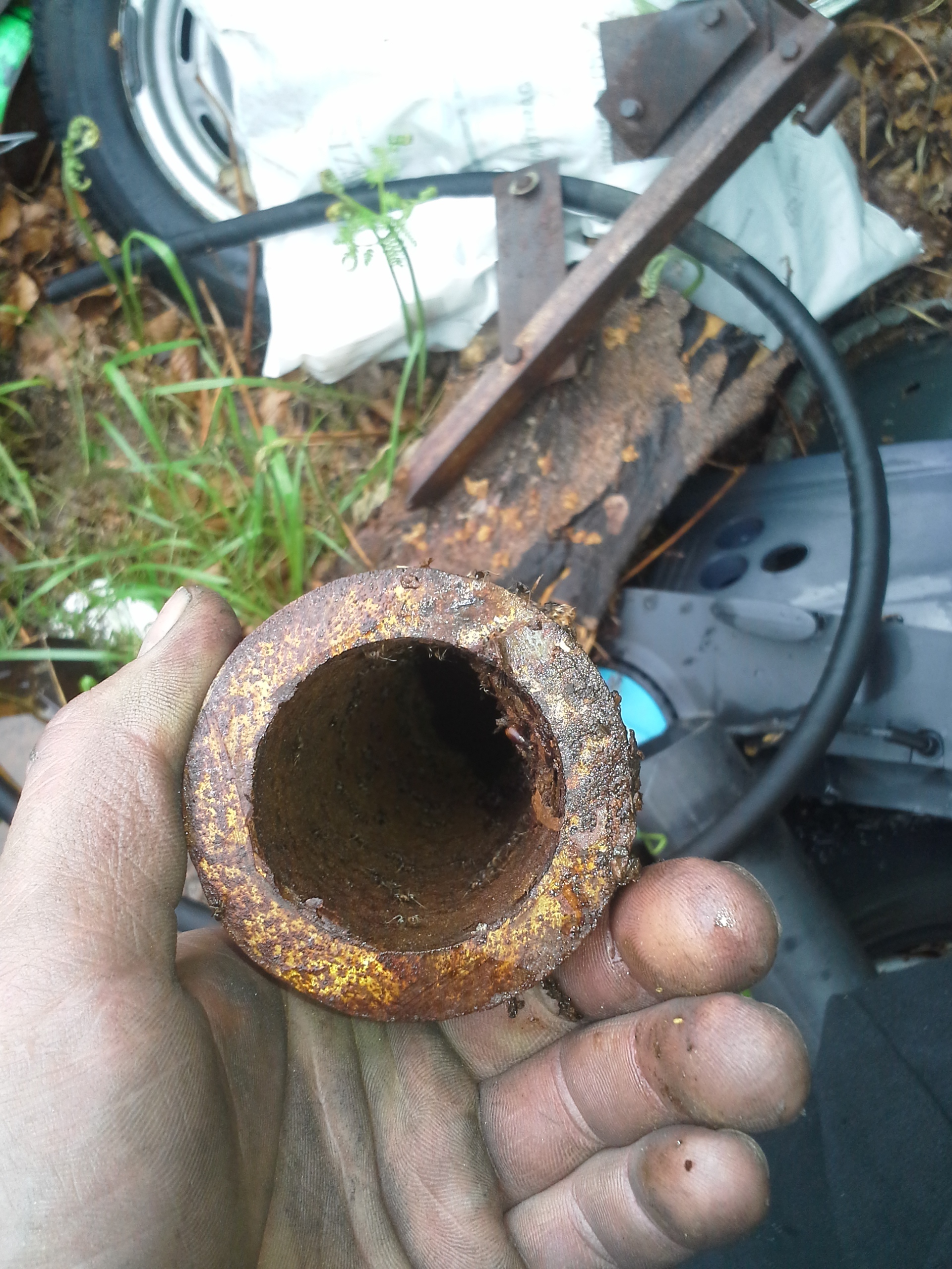

I read oak can cause problems with corosion. Anyone noticed this?

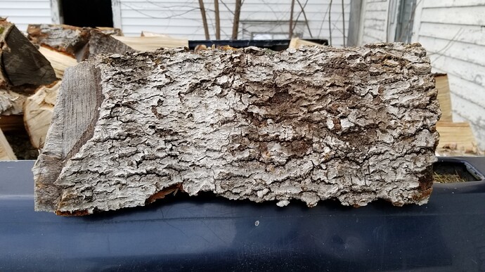

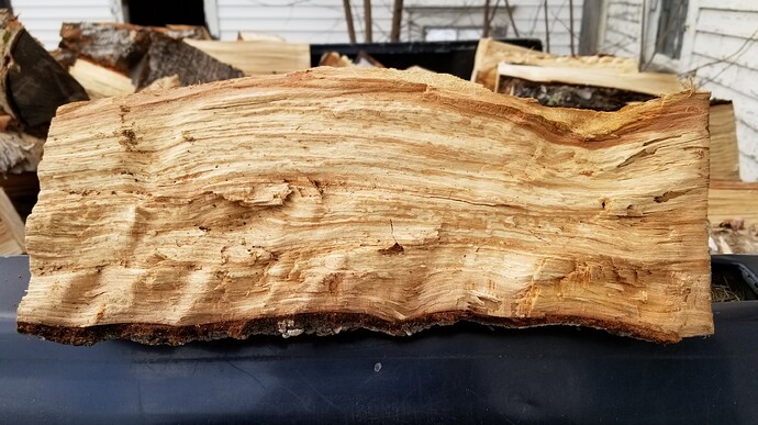

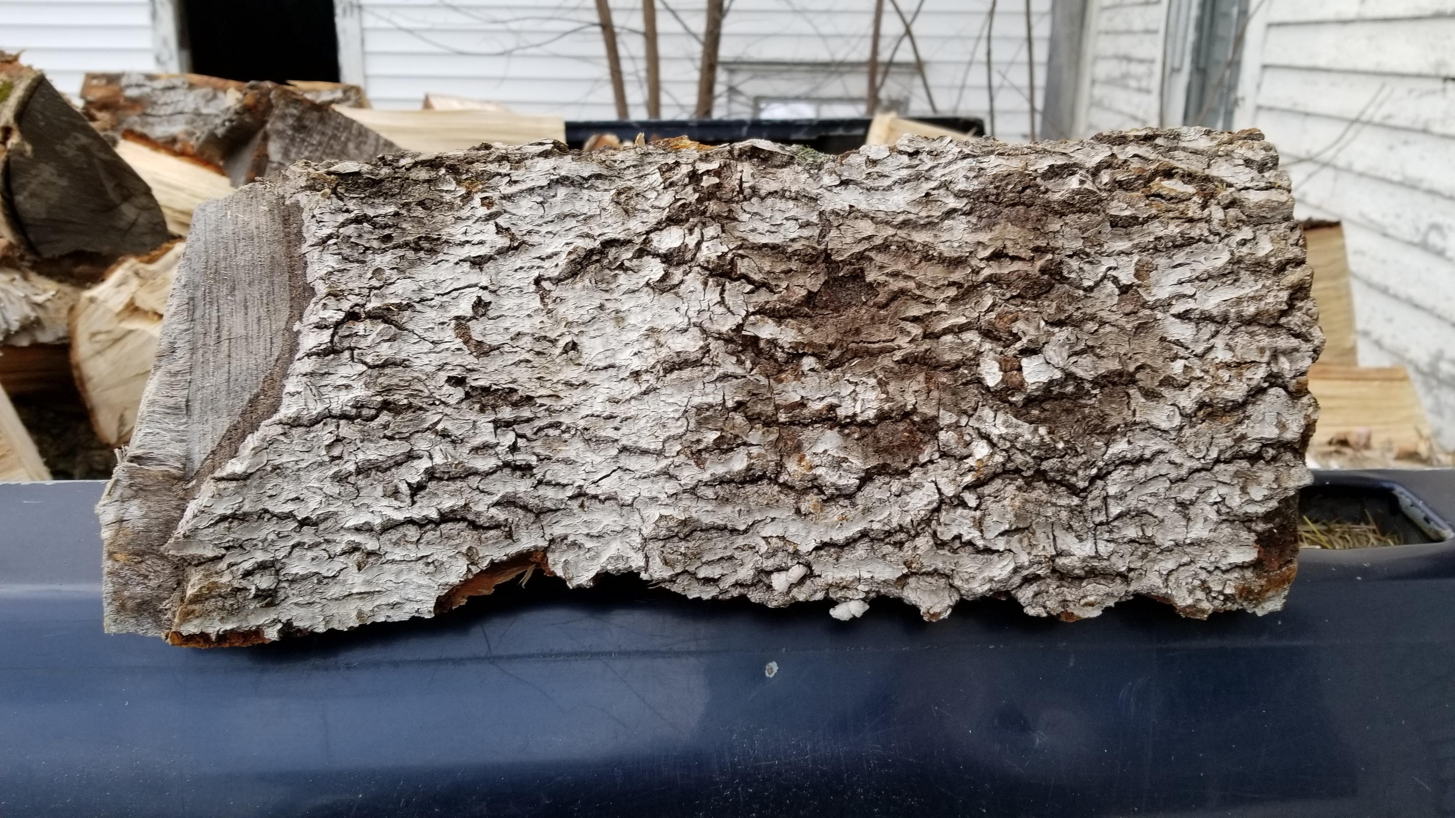

Ok I have a stupid question. I am working on splitting some firewood today and while I have split wood since I was a kid this one seems odd to me I don’t remember seeing waves in the grain of wood before so I was wondering if anyone knows what causes a tree to grow like this. All I can tell you is they did a timber cut off my wood lot and my forester said he would get wood that needed to be thinned out as fire wood for me. I am guessing he knew somehow that this tree had a messed up grain but honestly I do well to identify what types of trees they are I never know which ones are good or bad until it is obviously too late.
Hi Dan , i also have been splitting 2 giant gum tree’s that are down in my garden i also have some like that ,and its called Fiddleback
Google Fiddleback will tell you all about it
I am assuming that the bevel on that piece on top was the face cut from when the tree was felled?
Looks like “Butt Figure” ‘A wavy, rippled pattern caused by grain distortion where the root joins the stump.’ https://www.wooduchoose.com/BlogPost/?Figure-in-Wood (make sure you add ‘wood grain’ if you do an image search for ‘butt figure’ or you will find something else
I feel like I see this more in certain species, like cherry, and in older trees. I split a lot of firewood with an axe, and the wavy stuff is always a chore to split.
Thanks that one was the but cut but the waves go up the tree atleast 4 feet. That is about all I have split sofar.
Lucky for me I have a hydraulic splitter and it is a by direction splitter so the wedge is narrower it tends to cut more then split when things get rough.
Dave after reading that I sort of feel bad about turning it into firewood I should have taken that log over to my sawmill and gotten some interesting lumber.
yes over here hobbyist turners , builders , pay a premium for pieces like that so i believe .
That’s sugar maple, isn’t it?
Curly maple is likely worth more as lumber, beautiful stuff.
I would figure curl might be what is called reaction wood, like if a tree grew on a lean.
Yes it is suger maple, but it’s a little late now for lumber unless someone wants 16 inch lumber… the back lot here is the base of mount with a brook and a swamp the maples all get center rot and become useless for lumber before they get big enough for sawing. There is some nice red oak out there though. Those trees are about 10 inches diameter and already have center rot issues. But it does make great firewood. Someday I might get around to tapping some for syrup.
Picture frames… ![]()
CarlOR, you nailed the answer – butt grain wave/ripple.
Even on a very strait grained tree like Douglas Fir this aways happens when that tree hits a certain weight-mass. The downward pressure of 20,000-30,000+ pounds does this grain downwards compression squashing.
Yeah. Bugger-do to split. I now been using a 34 ton force hydraulic splitter for the past 4 years. Just got old, and tired of sinking in 3-4-5 steel wedges and still having to saw completely to separated.
tree-farmer Steve unruh
Steve
I like that description. I always wondered why the butt cuts were twisted, waves, and squishing makes sense.
