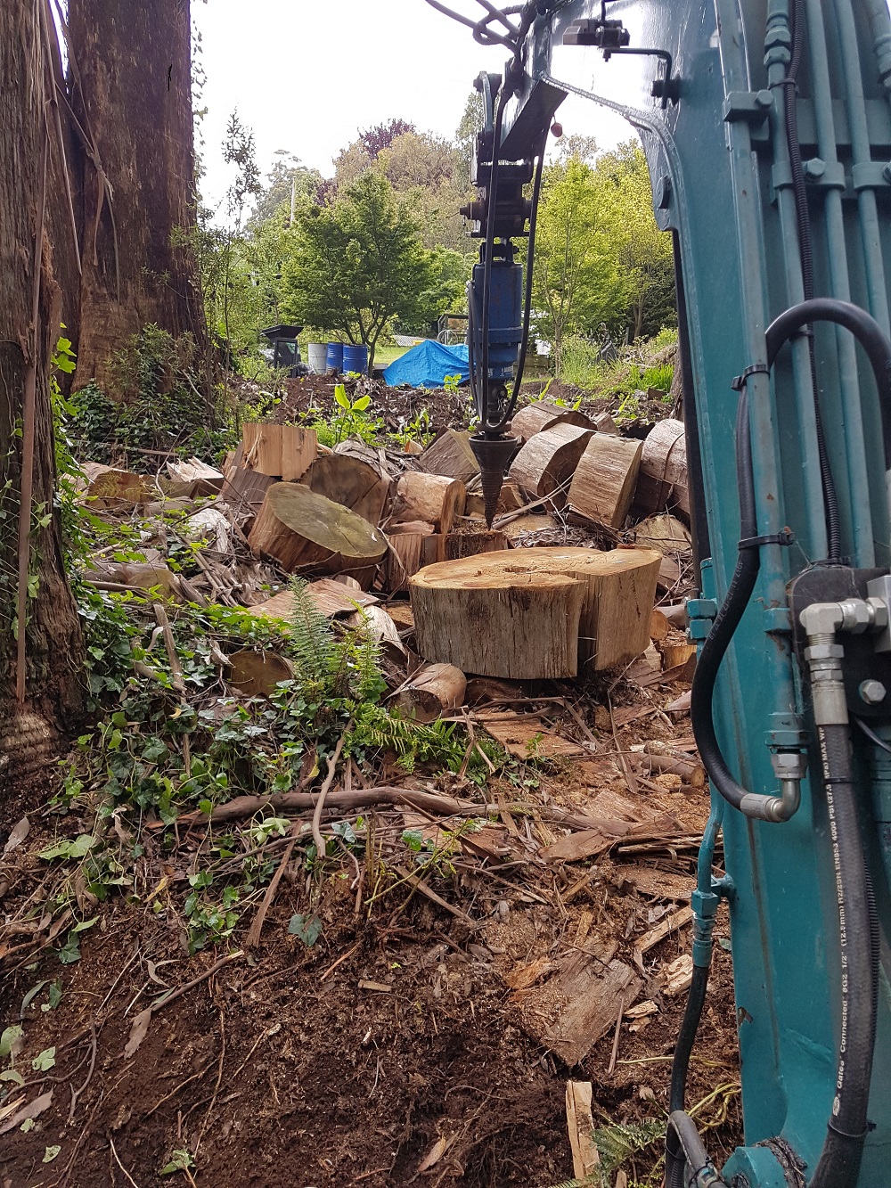

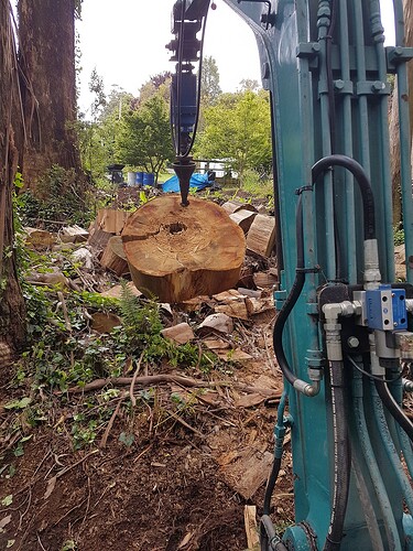

I cant split wood that fast here , my property is on a 30 deg slope and makes moving wood real hard , so the cone splitter works pretty well moving the wood and reducing it to a size so i can pick it up and then split to size on the slow 40 ton hydraulic splitter , nearly all the tree’s here are mountain ash apart from a few blackwoods

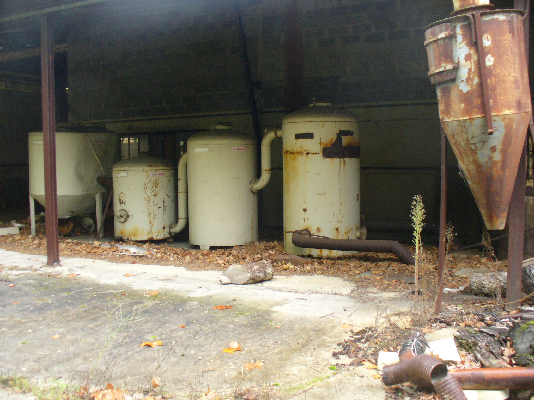

be careful with the oak, and also the chestnut tree, these are two species of wood that have pyroligneous juice excrementally corrosive, in Europe they say tannin, attached a photo of cooler and filter of a gasifier all rusted, so the owner only used oak from falling from the construction of his furniture, but mixing softwood and oak is a good, less problem and in addition the gasifier makes less vault.
Anyway, in the coal part when the gas passes for cracking, it must be greater than 850 degrees, to get there, I use the exhaust in a wood dryer to finish removing the water wood, the ideal is that there is no more water, in Europe we call it the red wood, and there you will be amazed at the temperature rise of the gasifier and its performance.to torrify the wood, do not to exceed 270 degrees to keep all the noble products of the wood, it is the grain size of the wood which determines the residence time in the dryer.
Excellent report FrancoisPal
Only one word that did not translate well: “vault”. Would this mean less fuel bridging in the hopper?
Thanks very much Francois .
I may go ahead and experiment using the oak and see how long the components will last. Then make a decision if dealing with the pine tar is easier.
I think best might be as you suggested, mixing soft wood with the oak.
Thanks
Wayne
Thank you FrancoisPal; Very interesting information. We all need to dry our wood. The idea of drying it with temperature just under 270 makes since and I hope some of the more ingenious people will take on the task of figuring a way to do this for the common folks. TomC

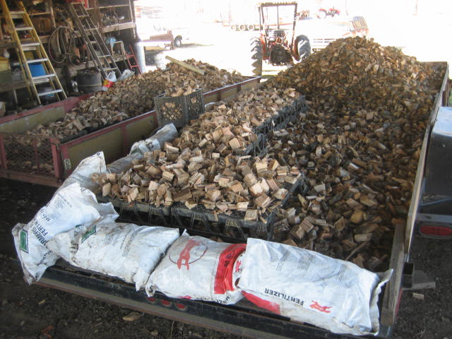

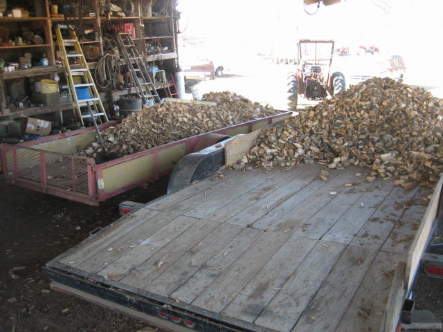

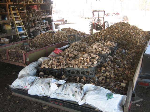

A few days without rain and the wood is drying good.
First picture is wood drying.
Next wood has been bagged.
Third wood is spread thin for another batch to dry.
I usually use a simple 20 inch box fan at one end of a batch of wood when I dry stuff inside. Seems to help a lot.
