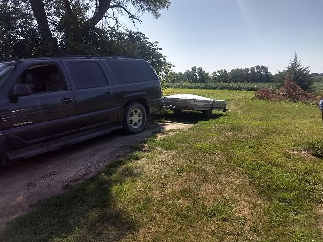

Loaded and hooked up. Will be meeting up with Jacob in a couple of hours.
350 lbs sacked another 400-600 on trailer

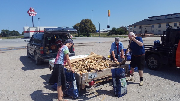

Transfer complete. Using Jacobs estimate on bag weight and my weight of the bags I took just over 1000 lbs. But all pine and he was pleased with the size. Hopes to mix with the wet stuff and also improve the char bed.

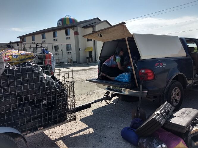

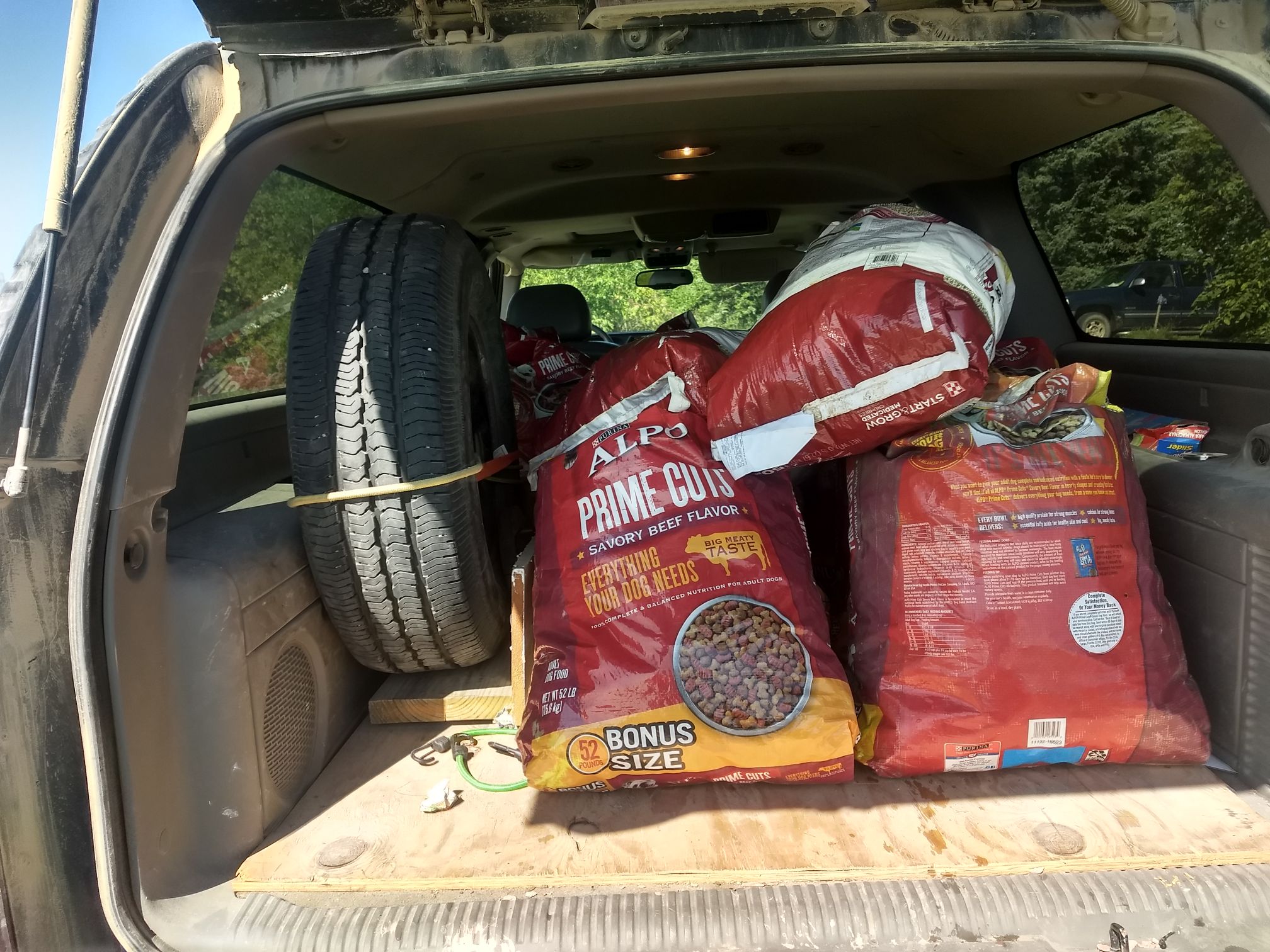

Naomi rearranging chase vehicle to pack more wood.

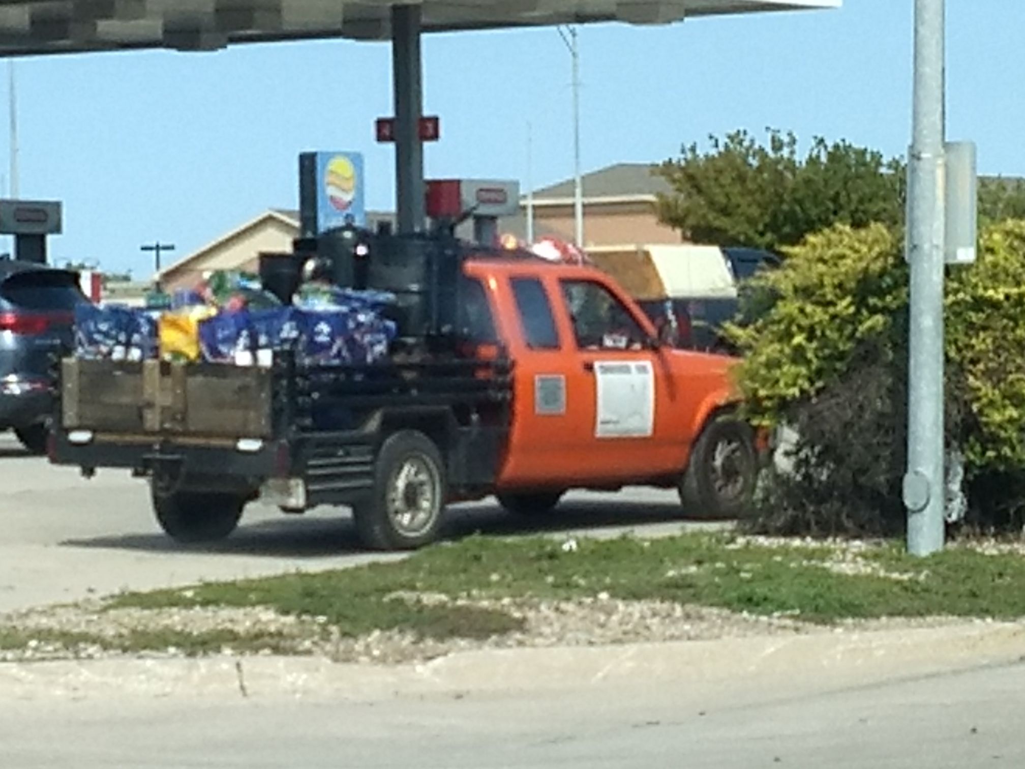

Fueling chase vehicle back on the road shortly

Many thanks to Tom Wobig for bringing the wood over to meet us.
Dad already talked about the wet wood. Once I started mixing tom’s wood with the wet stuff the char bed got really good and I had a lot more power again. I was pouring it in in layers and I could feel the loss of power as the layers would cycle through.
