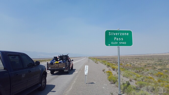

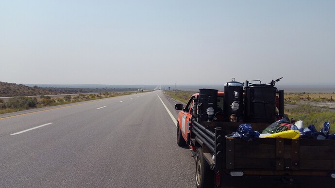

We are at the top of a mountain in Nevada. altitude 6914ft above sea level.
Oh man does that last picture look like a great spot for a standing mile grudge race from high school!
