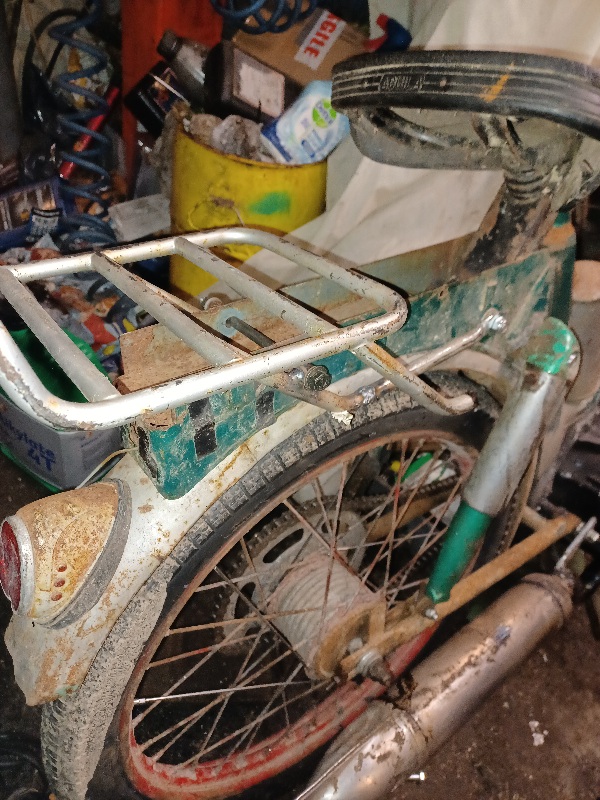

I mounted this luggage carrier to bring charcoal on, and attach gasifier to.
Feels like i building this backwards, should be the normal way to start with gasifier, and “build your way” to the engine?
Those are my thoughts exactly Goran.

Goran, l have found building it backwards works for me. Usualy when l build a gasifier l get all excited to try it out and take shortcuts with instalation. Wich can be equaly important as the gasifier it self!
Thanks Kristijan, that comment was what i was hoping for, it proofs i was thinking right about building this route, a nice flaring gasifier can get you so exited to test it out that everything else get neglected, semi-permanent solutions.
Trying this way because this is my first charcoal build (and two wheeled also)
