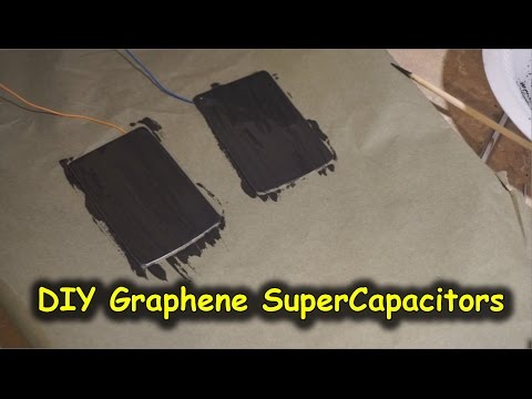

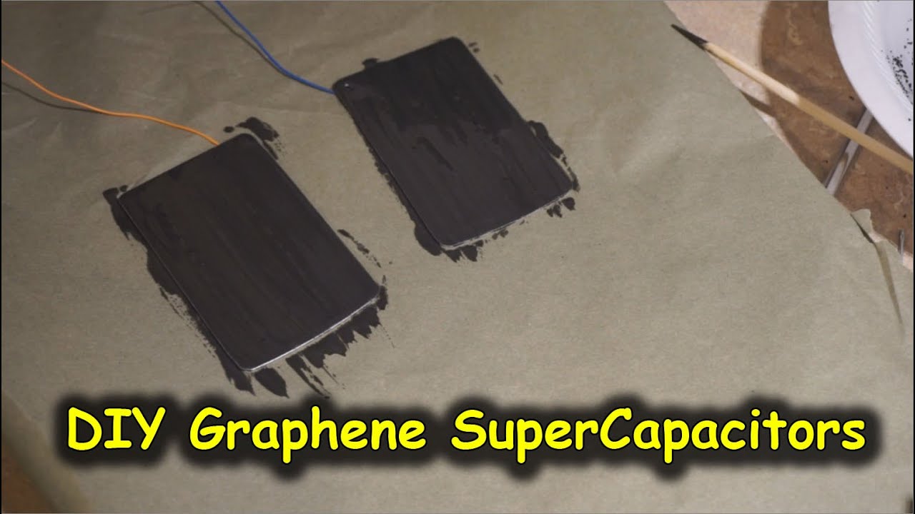

Here is a link to one of the battery technologies in development and on the way. We had a renewable energy conference here in Michigan with battery technologies as its main focus. Robert is doing this development for one of the companies. He is one of the experts in graphene development.
Here is a DIY video if your into experimenting.

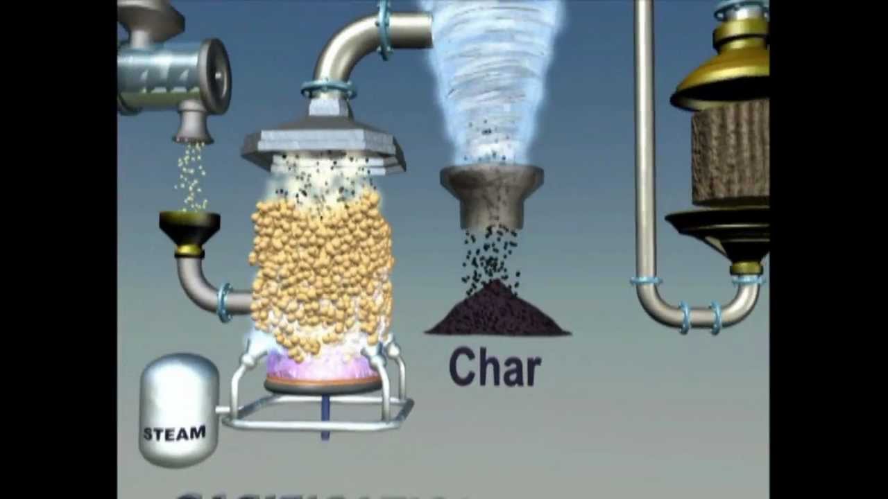

Here’s a video showing their setup.
