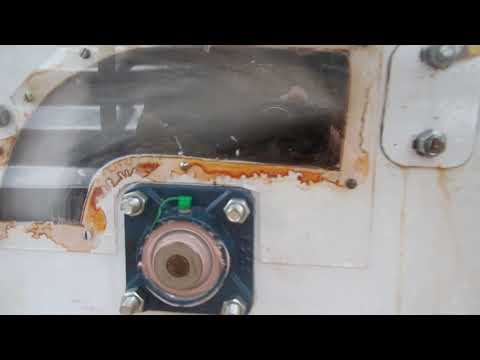

I shot a short video of the water jet (the side panel has a piece of plexiglass on it so i can see whats going on in there) but it turned out really bad. I will take another more comprehensive one tomorrow when i go down to see if it survived a whole night of running. My confidence in it is still shaky. The specs are: 400 feet of 4" pipe for the penstock. The drop is about 20 feet, but I only register 6psi on my gauge. The nozzle size was intended to pass 200 gpm, but with the losses in the pipeline (more than I anticipated) I think the flow is less. The turbine is indeed an old squirrel cage blower, which I do not think is ideal, but it does work. It is geared up maybe 2.5x to a PMA from Wind Blue. It sends 45 volts DC up about 500’ of 10 ga wire to my shed, where I am running it through a Renogy 20A mppt charge controller. I then have a xantrex C40 diversion controller dumping the extra power into my hot water tank. So far so good, I will try and post some more details tomorrow.
Carl, I think you are doing great. Based on a 20 ft drop your max pressure would be 8.7 ish psi before friction losses which over 400 ft would be at least a couple of psi. Nice use of an mppt. I’m envious. Looking forwards to the video.

Here is a quick walk-around of the turbine.

I am not sure if it is breaking in a little bit, but power output seems to be up a bit this morning.
As you can see in the video though, the tailwater coming out the bottom of the turbine housing is still moving pretty fast, and the jet you see through the sidewall is not deflected towards the center as much as I think would be ideal. I knew going in that a squirrel cage fan was not going to be a perfect turbine, but since it was free, and will be cheap to replace, it shows quite a bit of promise as an easy cross-flow turbine. Someday I would like to build a stainless steel version using strips cut from of 2" or 3" pipe as vanes, and space them out more and get the angles right. I would like to get the local fabricator to laser cut some plates for the ends, but I need to figure out how to get the CAD drawing worked up. Anyone here have any experience with LibreCAD?

Hey Carl that is so cool. are you going to play with the pulley size? She looks powerful enough for a bit more torque.
Carl, my experience with mixing squirrel cage fans and water always left me with the understanding that the water can’t evacuate fast enough from them to not become a drag to some degree. An impeller works better obviously, but costs a lot more. Looks like yours is doing great. Thanks for the vid.
