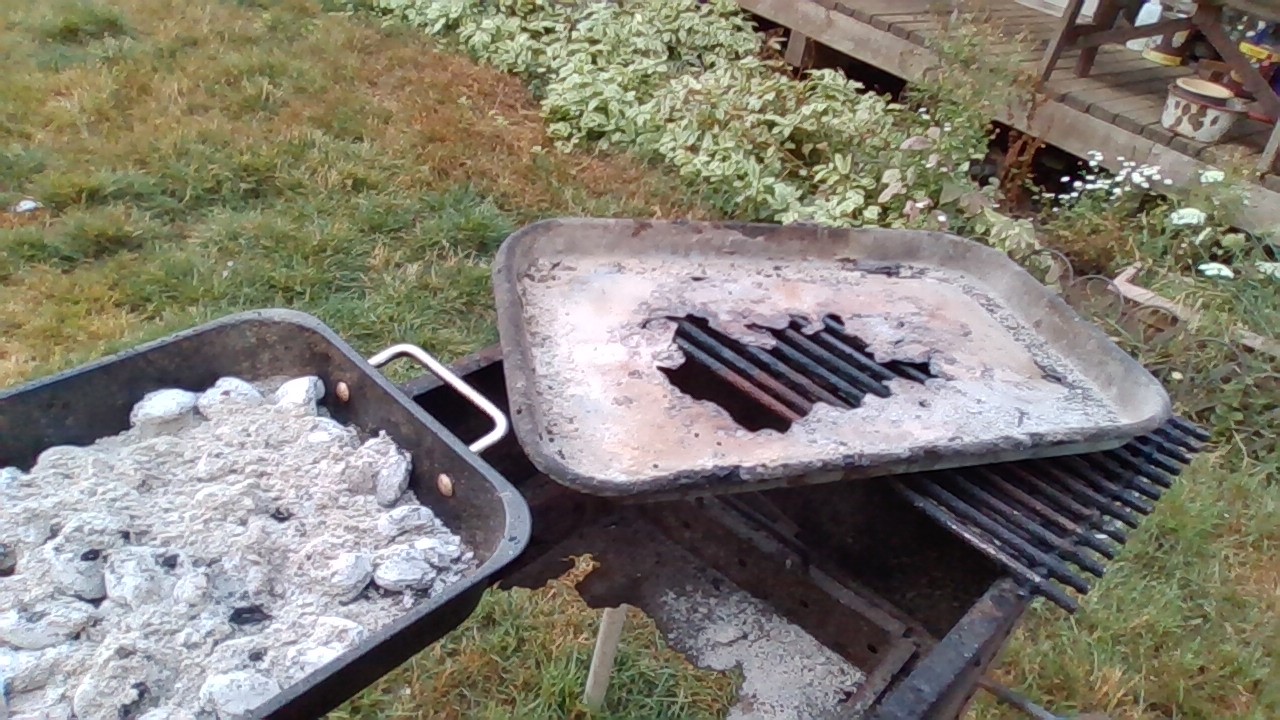

Tom Holtton I did picture up my wife’s saved from a garage sale yard charcoal BBQ grill.
40+ years old now.
The factory charcoal holding 24 gauge steel pan had center burnt out a long, long time ago .
We’ve been using now for three decades with fused enamel stamped steel broiling pans dropped into the burnt out hole.
How long do they last?
About two years BBQing use. 12, eight pound bags of commercial BBQ briquettes. About 300 hours of charcoal exposed burning time.
She is unable to effectively cumulative ash protect the holding pans bottom due to height space limits.
Anyhow. A charcoal gasifier able to ash and inactive char insulate made from appliance fused enamel “white” metal panels and drums should be able to last at least 1000 to who know how many more hours.
Vehicle terms that’d be 20,000 to 35,000 miles.

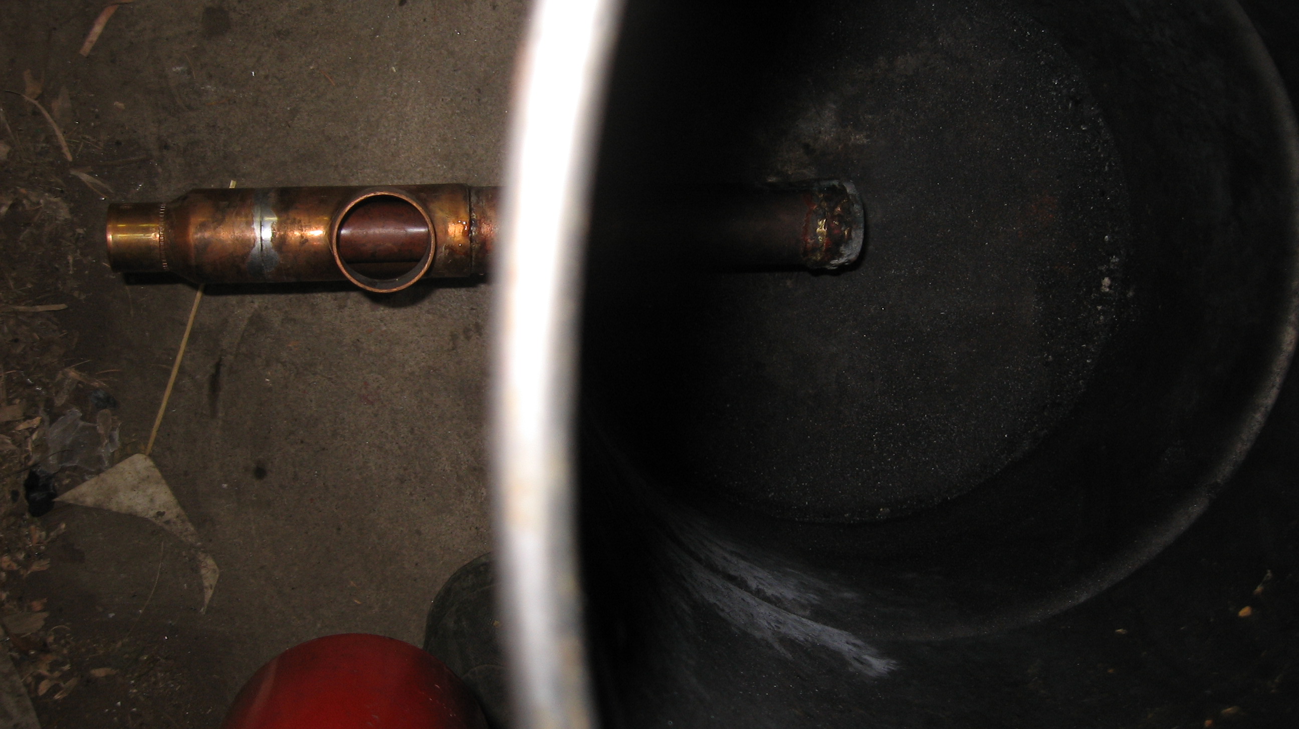

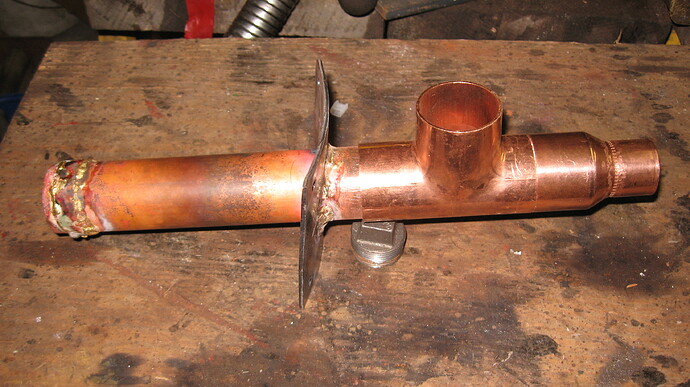

Hi Tom, Just a few comments on your intended build of a charcoal gasifier. If you place the nozzle 90 degrees in the “reactor pipe” it will get that pipe red hot on the opposite side, causing the steel to oxidize away rather quickly. The charcoal burning at the tip of the nozzle will be around 3000F, just like in a blast furnace. I’ll bet the water filled pipes will not be enough to prevent the pipe from getting red hot. If you build according to the diagram, the carbon monoxide being pulled off will be very hot and need cooled down. Why not have the gas outlet at the top of the gasifier, forcing the hot carbon monoxide through the rest of the bed of charcoal where it will lose that heat? Monitoring the heat of the chargas is also a good way to determine when to refuel the gasifier.
To make an even easier unit to build, may I suggest scrapping the “reactor pipe” and go with a nozzle placed in the side of the water tank, about 4 inches off the bottom. Dave has had good success with a ceramic nozzle (I’d look up the post under “nozzles” and give you the link but I’d probably loose all my typing :frowning ) I’ve had good success with a water cooled nozzle that actually makes steam that can be directed back into the nozzle. I’ll see if I can dig up a photo.
