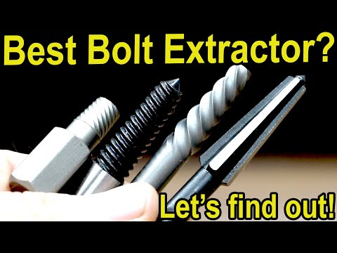

As in most things there is a lot of opinions.
Only Done-It experienced opinions should be valued.
I do like the Project Farm guy and use many of his comparisons for choices.
But this time his method testing is a big-fail on the extractor sets.
The object of a broken bolt extractor is to remove the problem stub and get going forward with the job being held up.
NOT prove who makes the best before breakage numbers!!
What I found once you are stuck in a hole with a break off to do was to small drill all of the way through the stub.
This lets you get in behind it with penetrant spray too.
Then I found after much trail and error to only use the four cornered long narrow tapered extractors. Those are corners longwise milled with a groove making for eight biting edges.
All of those pound-in short tapered many edged spiral fluted tips cannot but cork-in-a-bottle push outwards locking the broken off stub even tighter into the threaded hole. Stupid.
Yeah. They do not break off. They strip themselves and the hole you drilled most often.
Back to my long taper square flat types. Select the best for the stub diameter.
Then re-drill halfway down with a LEFT HAND drill bit. Yes create a stepped hole to kind match the extrator bits taper. Ha! Many times at that point the twisting of the lefthand drill bit will spin the broken off stub out. (Iād tell apprentices it got scared out avoiding the follow on brutalization.)
Then only lightly to moderatly tap in the extrator bit. Now with your clamped down tap handle carefully with even pressure turn it out. Wiggle some both ways. Buy/get a second Tap handle and clip its handles short for restricted areas working.
I do have the different square 3/8 drive sockets. Nearly impossible to not apply side pressure with standard ratchet or an adjustable wench. Thatās how skinny extractors get broken.
And I have gotten extractors stuck. That stub just not going to come out. With a clamped on tap handle you can two side pry upwards and remove it. If you do not break it off. Then you are onto over-drilling it out and tread-inserting. Big specialized job then.

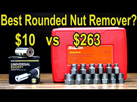

Project Farm had a great video test comparison up on those.
The long taper square fluted extractors are relatively cheap. Cheap to replace when worn or broken.
The GOOD drill bit sets are expensive.
And a good speed controllable air or electric close quarters right angle drill even more expensive.
All-in-all do everything possible not to bolt/stud break in the first place.
Rounded bolt heads or nuts? Much easier. Drill off the head. Pressure relived they will most often then lefthand drill spin right out.
Nuts; Dremel tool two sides slit the nut then chisel open and off. You get points for not damaging the bolt or studs threads.
