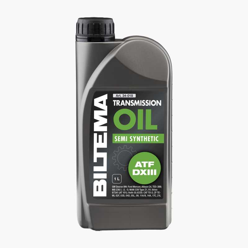

@Woodrunner Göran, can I have this oil in my gearbox?
Thought of sucking out 4 liters and changing.
Hi Jan, i donât remember the recomdations for s10, but i know i used DXIII (dexron3) in my S10 i had many years ago with no trouble (we had 200liters drum of dx3 at work then/free)
And, ofcourse, no problem using Biltema oils, as many sayâŠ, if they have the classification, (dx3/api gl/ sae 5w-40, for examples) they must meet atleast this, no worse oils than others more expensive brands ![]()
Yes any Dextron III rated fluid is exactly what you need in your automatic. DEXIII was the formula from the 90s to the 00s.
Does your transmission have a drain bolt? It likely doesnât, but itâs okay to drain and refill using the bolt if you have it, it wonât drain the entire contents of the transmission. About half of automatic transmission fluid is stored in the passageways and the torque converter.
I donât have a drain plug. Did you mean someone else??
Often a good idea to repeat the oil change after some driving, to get some more of the ânastiesâ out of transmission.
Jan, do you have Swedol or LantmĂ€nnen nearby? Cheap dexronIII available in 20 liter cans, (or was cheap last time iâve bought, about 60kronor/liter, and Swedol has âSwedoldagarâ when there are very good prices, sometimes 20%off)
Always good to keep some ATF-oil at home.
Sorry I meant for your S10. Some of the automatics had a drain plug for interval changes.
