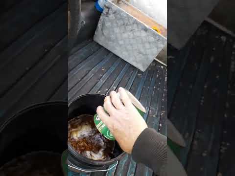

Ok, I was going to do as you showed me before, suck the oil out of the dipstick hole
Hey fellows. Always keep your sucked out ATF bottle saved separately. Great stuff to get debris piles burning. It smokes much, much less.

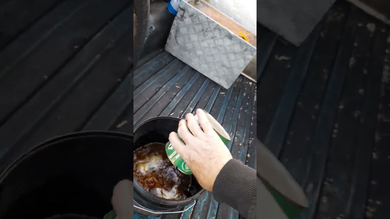

What do you think about the color of the oil?
Should I do anything more, I have changed 2 liters (0.52gallon)
JanA. because you have a well used transmission, also pay attention to after fluids changes, to changes in the shifting performance.
Doing some percentage fluid change is good because you did do something. All of the moving parts, especially with sealing rings will seal better and move smoother: clamp down down squeeze harder.
You will have removed some of the worn clutch friction materials being held in suspension. And some of the worn off bearing gear faces and shaft metals too. This is good.
But on a really badly worn thin clutches and band transmission it may only be these fluid contaminates, and aged thicken fluid that are still allowing the frictions to hold and lock.
Imho you could do another 2 liter change out and still be safe.
Then drive it for a year, 15,000 miles/20,000 km. Then another four liters changing out.
Like all things it is not the bright shiny new conditions that makes for good works but settled in average operating conditions you are always trying to maintain.
Doing external pumped forced full fluid flushes often produced BAD performance results. Reverse forced pumped flushes stirs up pockets of settled accumulated deposits that then quickly recontaminate the new fluids.
Like rubbing an animals fir, or feathers the wrong way. Creates great upsets.
Mother you can clean that baby too often, too clean, making skin damage.
Jan it’s good you replaced some of the fluid. That color on the right definitely tells me it was due for some of it to be changed. Still a little bit of pink but now turning brown.
And yes SteveU I agree, flushing with a machine forcing the fluid out can spell disaster. That’s why I prefer to drain through the dipstick tube. I’m not flushing anything or agitating.
Some of the better ā€œFlushā€ jobs I’ve seen is when they tap into the transmission cooler line, and have their measured amount to be replaced sucked up with the return line. The transmission does the pumping so it’s flowing as intended, no forceful evacuation through the wrong passageway. A lot more setup and labor, but it’s what one of my old master transmission tech coworkers recommended if I wanted to go one step beyond a simple replacement. It helps that most GM transmissions pump fluid in Park/Neutral.
