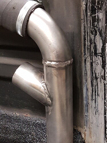

That is beautiful workmanship

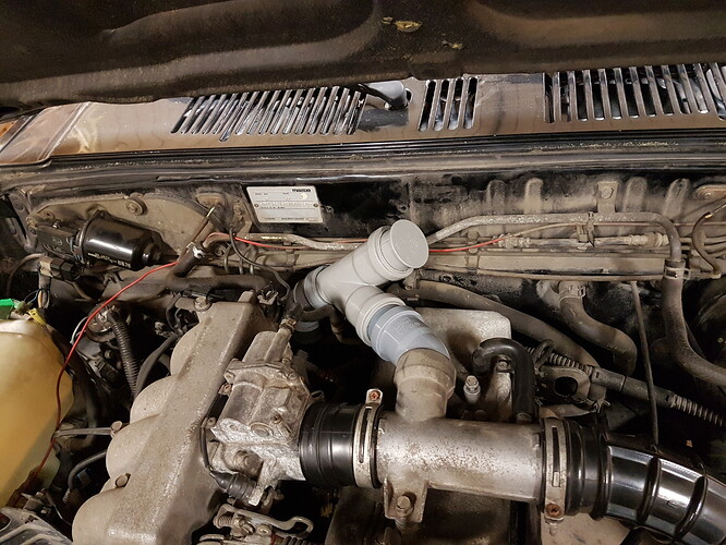

Another setback was I discovered the Mazda is syphoning.
At first I was a little confused when idling and I had to lean the mixture out to make it run clean. Closing air inlet and woodgas valve it was still idling. It can’t take touching the pedal but it seems to syphone enough petrol to idle. Also it’s possible it syphones only at idle when the intake vacuum is the highest.
This is a return line system (twin) and from what I understand I will need a fuel shut-off valve to go with the switch to be sure of running 100% wood. Unless…I remember @SteveUnruh mentioned another solution to these dual fuel line systems a couple years back…but I can’t seem to remember what it was or where to look it up.

I do not think it was me commenting on DOWing with return line systems.
Your analysis does seem plausible. High intake manifold vacuum does lift open the gasoline fuel pressure regulator orifice. With fuel in this line that fuel could be siphon sucked backwards.
Stil for the fuel to get into the engine cylinders it would have to be passing through the fuel injector orifices. It is the normally at atmospheric large trottle body injectors that seem to have been the worst for this once the upper throttle body is woodgas converted to be at an abnormal intake vacuum.
Always inside the intake “port” runner injectors have seemed to have enough spring closing pressure to resist vacuum opening and suck siphoning.
But this is a Mazda system.

Those are some nice little old trucks, rare find in the nothern usa, EXCELLENT WORKMANSHIP and nice and low profile for less wind drag.THE way you use recycled parts leave no excuse for cry babys caint weld or find metal.

Are your injectors electronic or fixed like on K jetronic? If electronic, you culd just swich them off? Pull out a fuse?

@SteveUnruh Hm…injectors do there tick-tack opening anyway, right? I mean even with a non-pressurised fuelrail. That would mean injector spring closing pressure doesn’t need to be the problem.
I think I’ll try Kristijan’s suggestion to pull the injection fuse to see what happens. I just hope ignition doesn’t get affected.
@KristijanL That answers one of your questions.

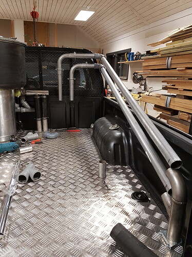

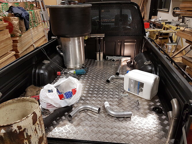

Videos will have to wait, simply because I haven’t made any yet. Pics from the building process I can upload as soon as I finish typing this.

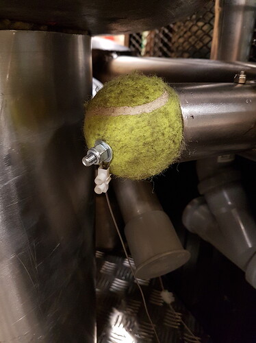

I ripped off the crossover cover today, pressurised the system and blew cigarette smoke around the compression fitting to look for air leaks. I’ll have to try again tomorrow because the tennisball inlet valve let pressure out and the char woke up and heated things up again.

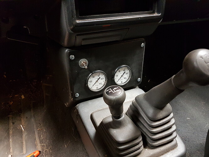

Experimented with shutting on and off the upper nozzles today. (The lower 5 nozzles are always on. The manifold for the upoer 10 nozzles I can shut off.) When all nozzles are used the vacuum ratio increases. Keeping the pedal steady and letting air into the upper manifold lowers the hopper vacuum. Ratio goes from about 2:1 to 4:1. It doesn’t affect the total (rail) vacuum, which surprised me. Maybe making the charbed a couple inches taller evens things out.
Fuel supply:
With a high idle running rich on woodgas I pulled the fuel injection fuse today. Shuts everything down. It seems it affects the ignition as well, so this is not the way to go. Sorry, Kristijan! I’ll try experiment with the vacuum hoses to the check valves for the fuel rail tomorrow. I was surprised to discover I have two. One on each side of the rail??? If that doesn’t work I can think of no other solution than an old school fuel valve.

I looked under my tarp, it is staying covered up. Beautiful build. So much stainless steel it hurts my eyes.
Are you ready/willing to play Tom’s 20 question and a couple of comments??? Oh hell! I can’t do it now. My first question was did you build the head rack behind of the cab. I knew you posted a picture of the truck as you got it so I went all the way back to see if it came with the head rack. I spent so much time re-re-rereading your post of the construction, that it is now time to go to bed.
Couple of statements-- your welds are absolutely beautiful ( I have not found a source for 3/32 stainless rod, not that I really think that would make my welds look anything like yours.)
Cleaning and painting the inside of the box and that Aluminum floor plate, add the touch of class.

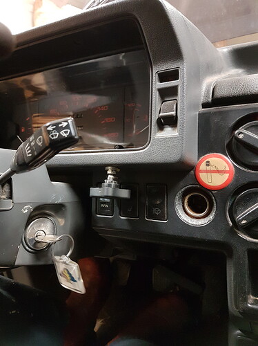

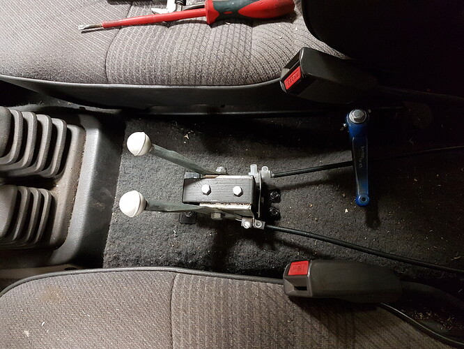

You have two or three levers between the seats— what are the hooked to.?

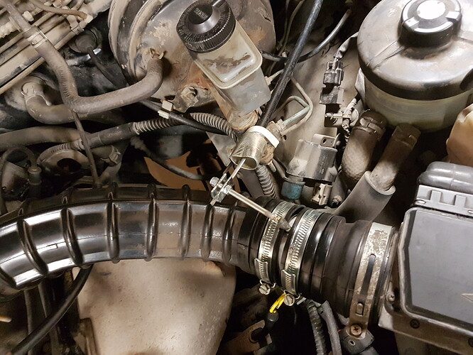

Is that tennis ball covering a “flare” port? Won’t that be to hot with the pre-cooled gas and the hopper there? TomC
No it’s stock part of the bed.

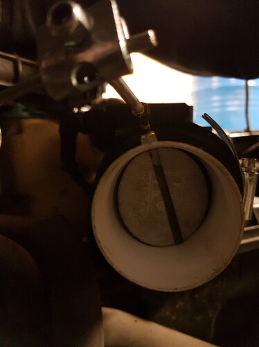

The white knob levers are hooked to main air inlet tennisball valve and the upper nozzle manifold valve. The blue handle stickig up through the floor is the woodgas valve.
I have no flare port. A plastic T-pipe prior to the hayfilter is where I put my blower for vacuum or reverse. If I wanted to flare I could put on a piece of pipe on the blower.
I may move the tennisball spring to the outside of the air inlet which would allow me to push too.
