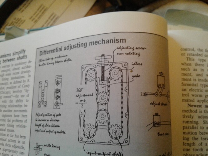

Now if anybody wants to go down the rabbit hole, i remeber a setup in one of my engineering books where the relative timing of two shafts could be adjusted on the fly with a pair of idler sprockets. Moving the idlers position would change the relative position of the two shafts.

That is clever. Who in the world would think of that. :grinning:
