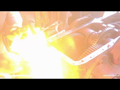

Jan, if you heat only the screw, the case will not crack, the fastest and most intense heating is heating with electric welding, this is how I solve broken screws,…
