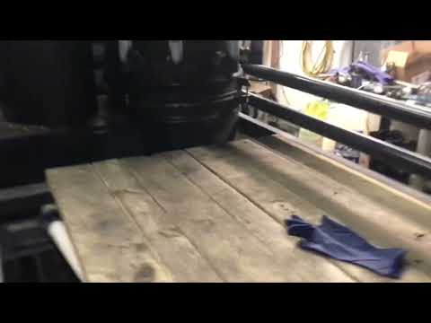

In freezing temps, how do you think some of those rv valves would hold up/ seal on the drain valves⊠being MN im going to have to drain after every run so i dont freeze solid. They would make draining a lot faster, but im not sure if they would hold up to the cold or freeze shut not alowing me to open them.
Im close⊠but not there yet, still working on the flat bed frame.
Thanks Marus for the great infomation. I do the same thing after a long drive. Drain off the water on everything on the truck and sometimes the tar too when the truck is hot. I am not a every day driver to work like you. My 130 miles a day driving to work stopped in 2008. Talk about tax free monies back in the pocket not buying gasoline every day. The prices of gas was $1.35 a gallon. Wow, look at the monies you are saving each day compared to 2008. DOW.
Chris, it is best to use the 2" or 3" rubber caps when possible. If you do freeze up you can still pull them off and poke through the ice. This black sooty and tar water is harder to freeze up but not impossible.
I have a 1 1/2" pvc screw in cap and I put grease on it in the winter time on my hay filter drain. On the other drains. 2" with the rubber caps.
There are some guys that used them in the past for condensate drains, though I donât recall who they were. Soot getting into the sealing lips was a problem and they didnât always close completely as the blade coming down would bind up on the soot particles. If they were manually operated they do work, but a little bit of a hassle to make sure they close up well each time, seemed a touch more work then I wanted to deal with compared to just a furnco cap that is pretty well stupid proof. The 3/4" ball valve I use on the hopper tank is the same as on the Toyota and it has never given me a problem until it gets filled with tar which has only happened once now so I think they work pretty good, though there is no soot in that area to bind up the ball inside
Hi Chris. I use metal ball valves for all my drains. Never had them freeze crack. If they are frozen and plugged you can heat them with the torch. Itâs a good idea to have the hopper condensation tank pretty close to the gasifier though.
The rear tank condensation is trickier. One way to be able to melt it fast is to have woodgas enter the tank prior to the rails. Downside is the hayfilter will catch condensation separately. It requires quite a long ride to melt that ice if draining was forgotten about at last shutdown.

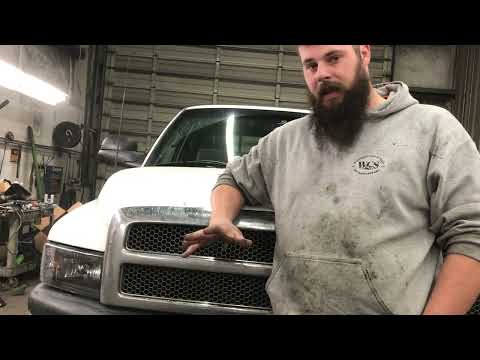

Vacuum ratios were still looking good but with near 30 bags of wood through the truck and about 300 miles on wood it was time to inspect the char
It was full right to the heat exchanger which I expected since I was starting to get eradic performance from the cross over temp gauge, it was submerged in char.
It appears I had a small air leak at the base of the drop box housing, im not a fan of this dynaflex red rtv im using with absence of air it remains soft and flexable, which means extreme heat can push it out and around. It was pushing out at the base in goooy half liquid form so I gave it a smear coat on top that will harden up
